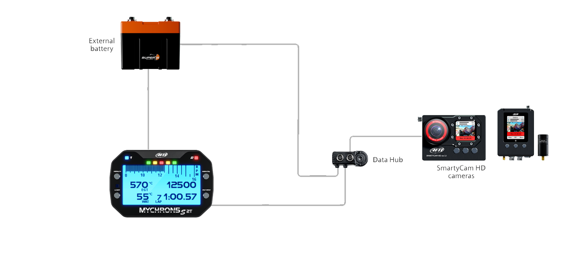

Connecting the Two-Way Data Hub
The two-way data hub with external power allows you to connect different devices, powering them through a battery.
You can connect more Data Hubs to build a network, as shown in the image below. This is ideal if you want to add extra data to your vehicle for improving performance and data.
Two-way Data Hub CAN Connection Multiplier Connection Example
