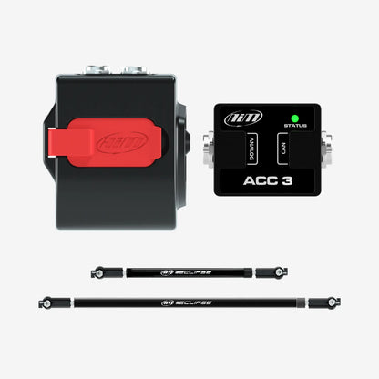

Combine the XLog, a small, waterproof, 25Hz GPS data logger; the ACC3, our unbeaten Analogue CAN Converter; Suspension Potentiometers; Brake Pressure Sensors, and you can even connect the ultimate motorcycle camera - the SmartyCam 3 GP, to become the best rider and beat your best lap times.
Why Choose the XLog Motorcycle Kit
It provides a powerful solution for anyone who wants to capture and analyse their performance data without needing an on-board display. Combined with the ACC3, Suspension Potentiometers and Brake Pressure Sensors, you will find the ultimate key to control, analysis and improvement.

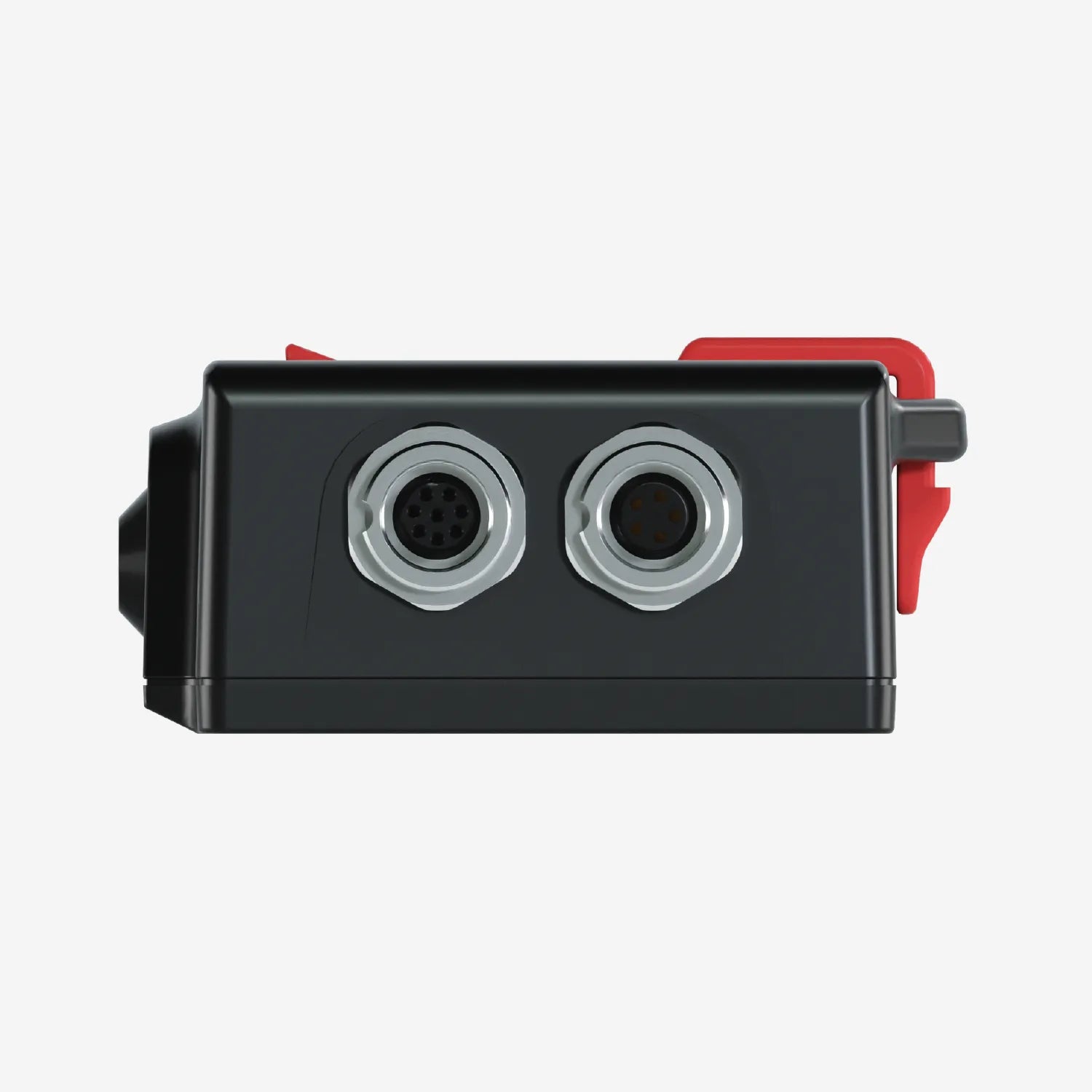

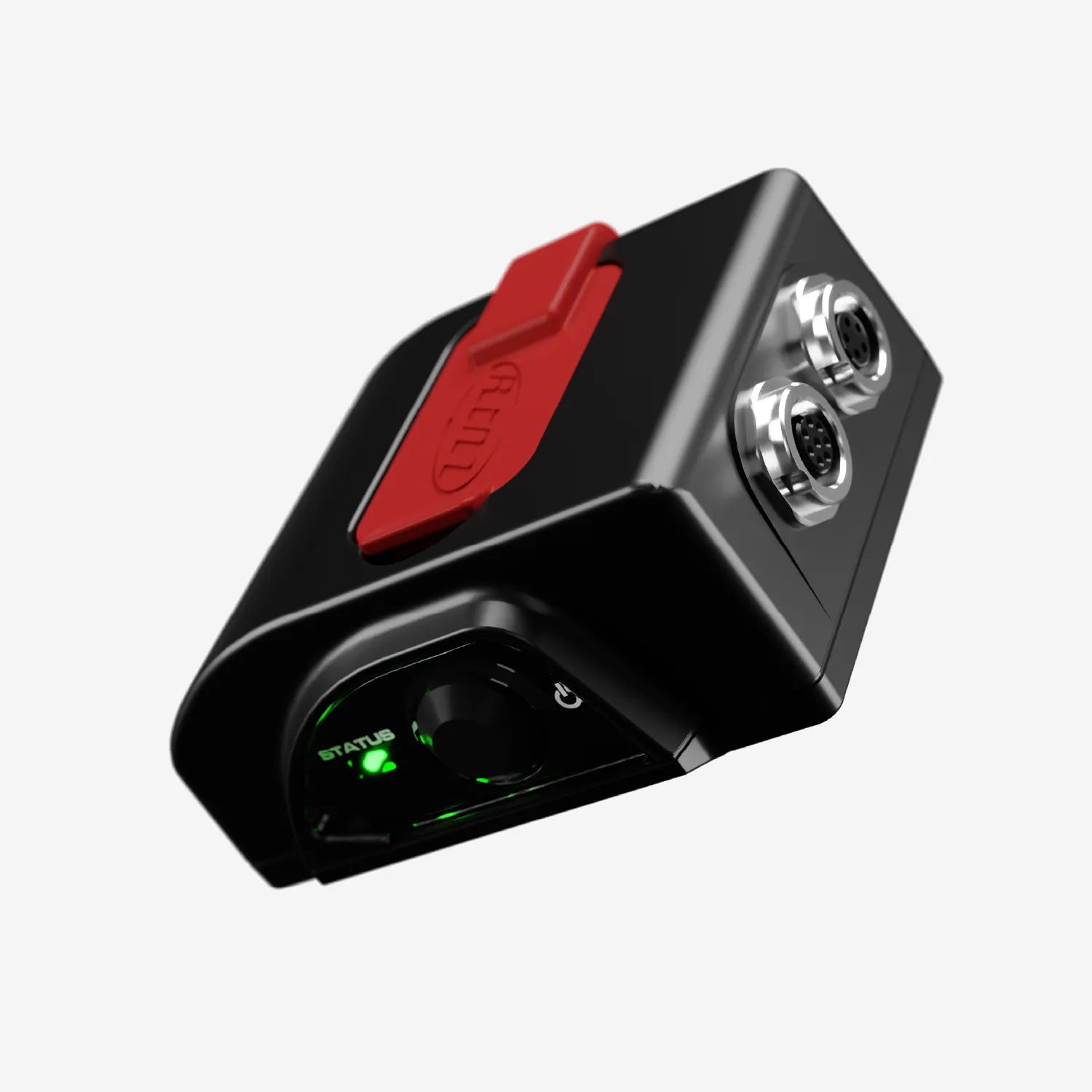

XLog data logger
Motorcycle riding on track
XLog Features
  • Lap times
  • Sector times
  • Vehicle position and speed
  • 3D acceleration and gyro
  • ECU data via CAN, K-Line or RS232 connections.
    (You can select the protocol of your car/bike among thousands of pre-defined protocols, or easily develop your own).
  • Digital RPM input from the primary of the coil (150-400V) or from a square wave (8-50V) when no ECU connection is available.
In addition, the XLog features a second CAN for connecting an external device or Aim Expansion, meaning you can add a Lambda Controller, analogue inputs, and a professional motorsport camera for enhanced functionalities.

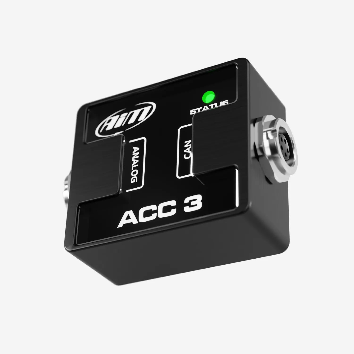

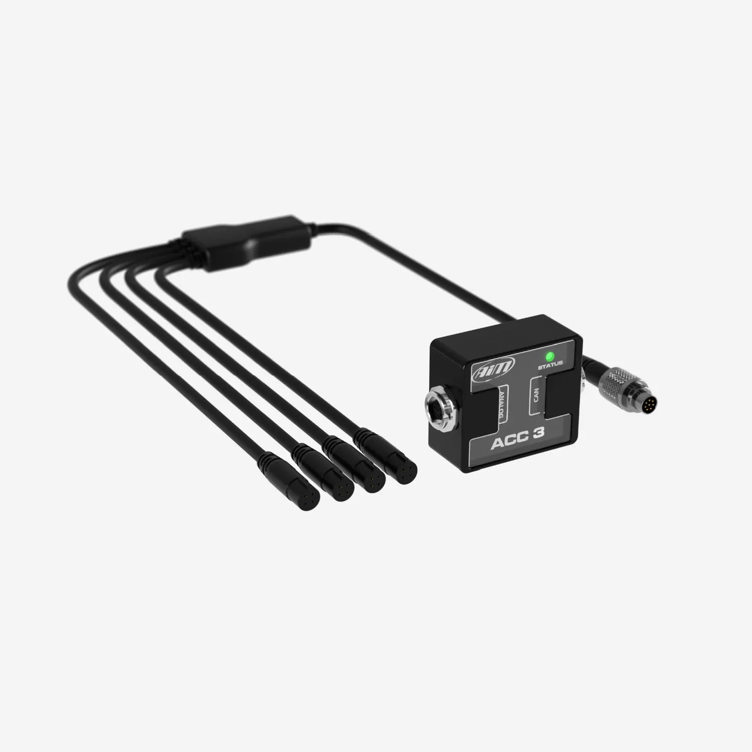

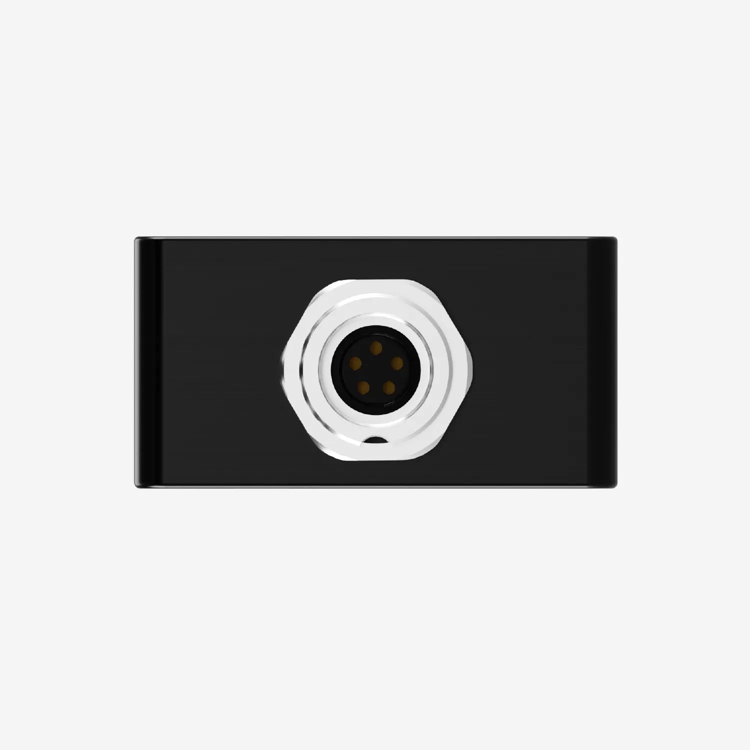

ACC3 with 4 channel harness
Like all Aim devices, the Aim ACC3 is built for motorsport applications. Its compact design ensures easy installation across a range of racing vehicles, while its robust construction guarantees reliability in demanding environments. When combined with Race Studio 3 software, the ACC3 unlocks powerful configuration and analysis tools, including suspension analysis with Aim Eclipse sensors and video synchronisation with SmartyCam 3 cameras.
  • Thermo Resistors
  • 0–5V Sensors
  • 0–12V Sensors
Inertial Platform in XLog
XLog GPS & Inertial Platform
  • Lap Timing & Sectors: Automatically recognises track layouts, samples laps and sectors, and provides all the raw data for Race Studio 3 analysis.
XLog connects with Race Studio software
XLog Connectivity
  • ECU Connection: Supports thousands of predefined CAN, RS232, or K-Line protocols, or you can build your own protocol via CAN builder.
  • Second CAN Option: Configure for Aim expansions, or connect additional sensors and third-party CAN devices.
  • Wireless: Integrated Wi-Fi and Bluetooth for fast, cable-free data transfer.
  • USB-C & Memory Key: 4GB internal memory plus a removable 16GB USB-C key for quick access.

  • ACC3 Analogue to CAN Converter: Add up to four analogue channels for pressure, temperature, suspension, and other sensors.

XLog
  • USB Connection: Yes
  • GPS: 25Hz
  • Wi-Fi: Built in
  • Bluetooth: Built in
  • Expansions: ACC3, Lambda Sensors, SmartyCam
  • RPM Input: 1
  • Push Button: 1
  • Status LED: 1
  • External Power: 9-15V
  • Weight: 150g approx.
  • Waterproof: IP65
SKU: XLOG
ACC3
  • Connection: CAN
  • Material: PA6 30% glass
  • Weight: 50g
  • Waterproof: IP65
SKU: ACC
  • 1 x 75mm Suspension Potentiometer
  • 1 x 150mm Suspension Potentiometer

  • ACC3 4-Channel Harness
