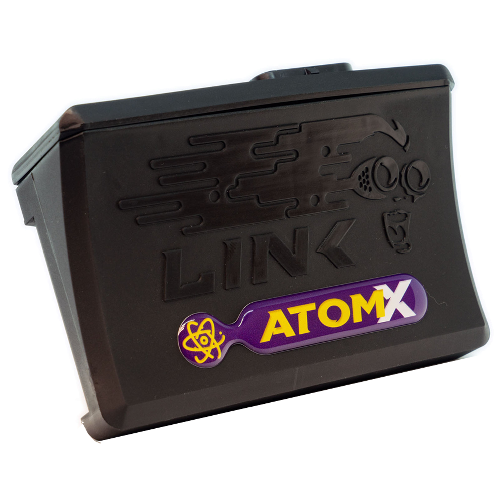

    Small, but mighty
    The Link G4X AtomX ECU is the latest version of our entry-level ECU. Don't let its size fool you however, the AtomX has expanded data logging and uses the same microcontroller as the entire G4X range! It is more responsive and has higher bandwidth than its G4+ Atom II predecessor.
    G4X features 512 megabytes of logging at 32bit using up to 250 channels, each limited to up to 1kHz per channel (by the Operating System), with a maximum of 100 kSamples/sec.
    G4X features 8 x faster communications speed, allowing you to download logs 8 x faster and pushes all the logging quickly up to a new and improved PCLink – available for download below in the features tab.
    The AtomX can control up to 2 rotors or 4 cylinders with sequential injection and direct spark. Or, it can be used for up to eight cylinders using batch fire.
    This makes it ideal for naturally aspirated engines that just need a re-tune and don't need all the extra sensors and features that come with our higher level ECUs.

    * Requires "A" loom.
    Inputs
    2 x Digital inputs
    2 x Temperature inputs
    3 x Analog inputs
    2 x Trigger inputs
    Outputs
    4 x Injector drives
    4 x Ignition drivers
    4 x Auxiliary outputs^
    +5V Sensor power supply
    ^unused ignition drives can be used as additional Aux
    outputs
    Communications
    1x CAN bus
    1x USB tuning connection
    1 x thirty-four pin, waterproof connector
    Upgraded Communications Chip
    Physical
    Dimensions: 90mmL x 130mmW x 45mmH (without loom)
    Weight: 180 grams
