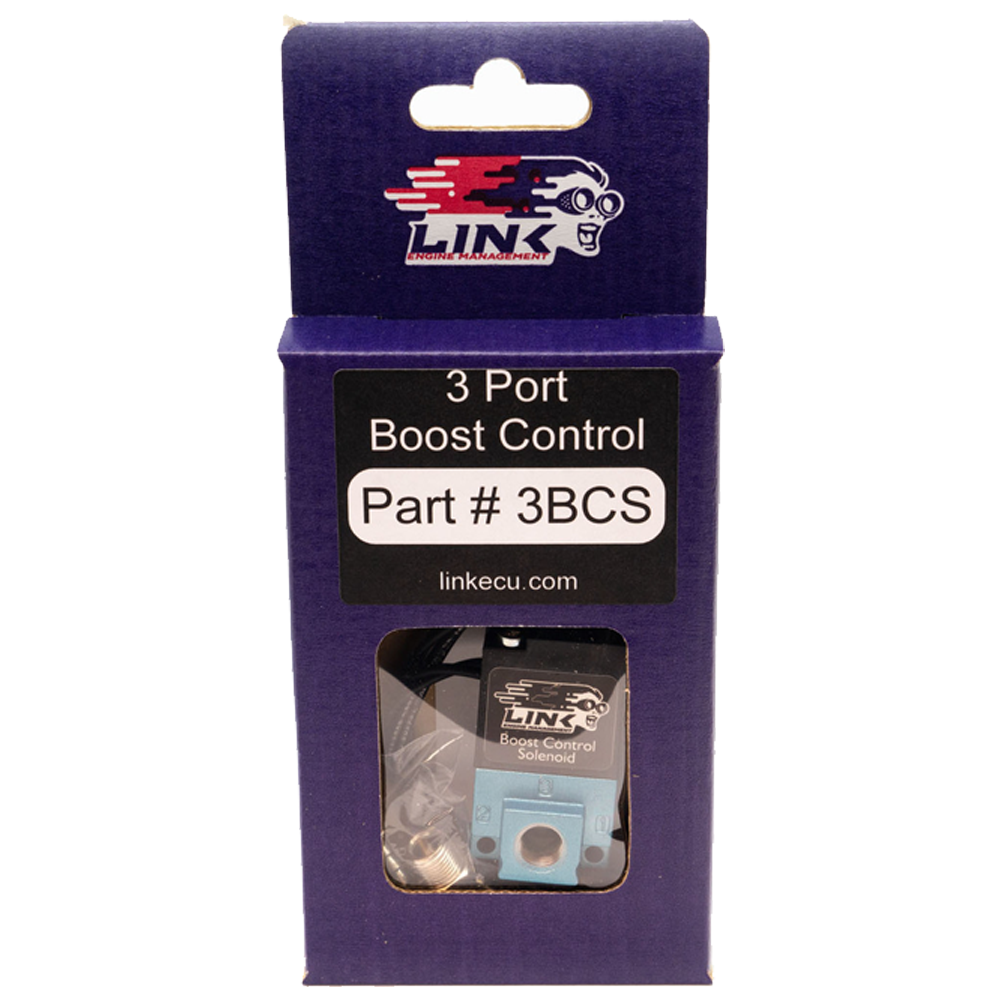

Link Boost Control Solenoid 3 Port

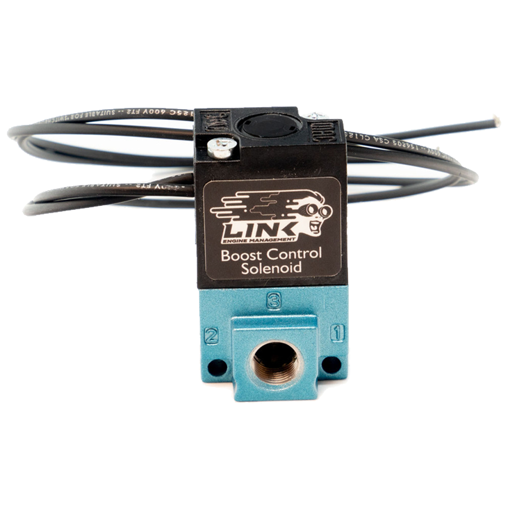

Need more boost then this 3 port boost control solenoid will help you do it.
3 port boost control solenoids are the go-to for the majority of boost control applications, they allow for precise control of boost and boost levels can be raised to around 2-3 times the spring pressure of the wastegate.
For higher boost applications consider our 4-Port boost control solenoid.
Features
Compatible with all Link ECU’s
Can be used with single or multiple wastegates (Using T junction)
Compatible with internal or external wastegates
Fast and consistent response times
High shifting forces
MAC 35 series – Rugged, reliable and long operational life
Short stroke, high flow
Balanced poppet, immune to variations of pressure
We recommend starting with a PWM frequency of 20Hz for this Boost control solenoid. A detailed description of setting up boost control can be found in the help file in the PC Link software which is available in the download tab.
 MAC 35 series
120 PSI max
1/8” BSPPL
12 VDC (5.4W)
18” (45cm) coil leads
Includes 3 x 1/8” BSP hose tail fittings for easy connection
