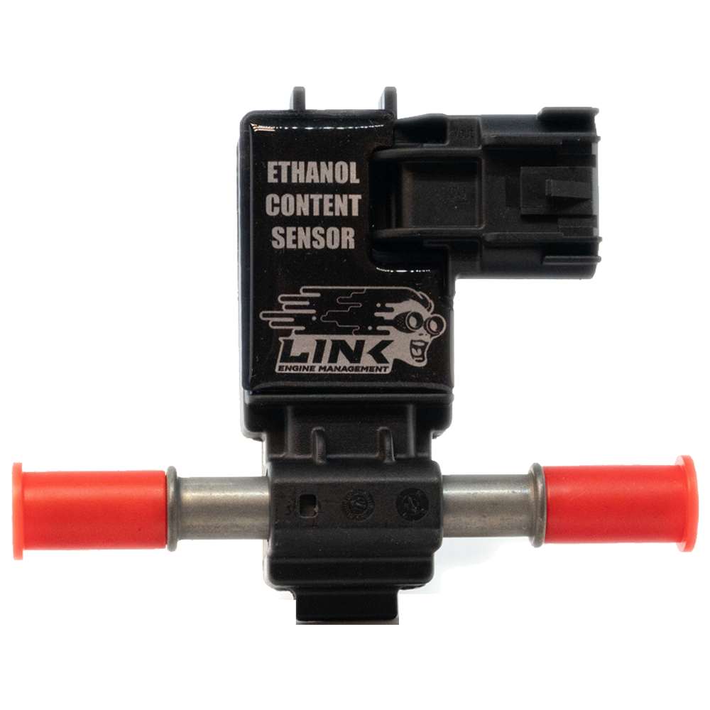

The ethanol content sensor (ECS) measures the ratio of ethanol to petrol in a flex-fuel vehicle. This sensor also measures fuel temperature and is compatible with all current Link wire-in and plug-in ECUs.
The Link ethanol content sensor uses 1 digital input on the ECU. The sensor is fitted to the vehicle’s fuel return line anywhere between the fuel pressure regulator and the fuel tank. This product includes AN-6 fittings and a plug and pin kit.

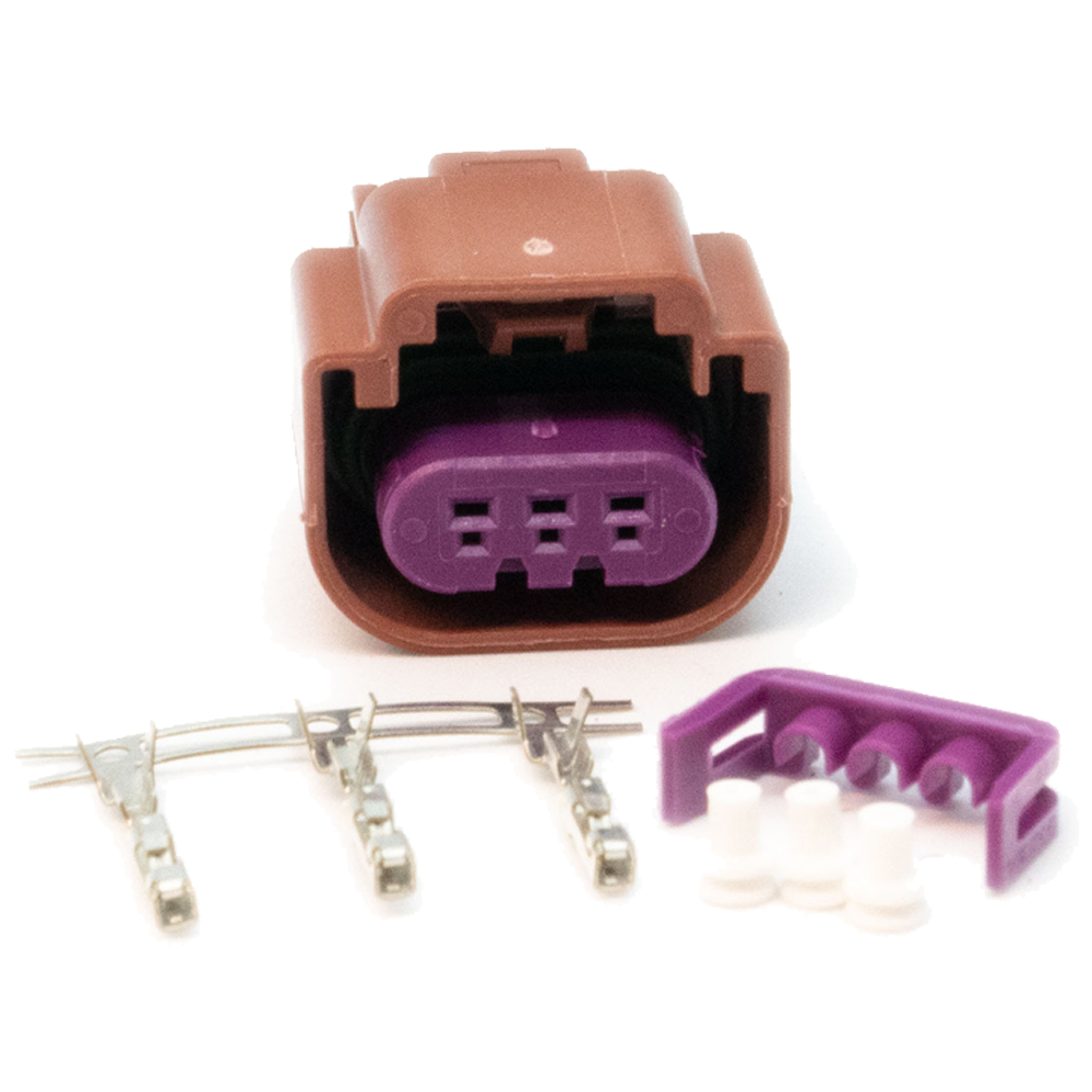

The pinout is indicated on the sensor itself (from left to right, looking into the connector on the sensor) as:
  • Vcc (+12V supply)
  • GND (ground)
  • Vout (digital signal out)

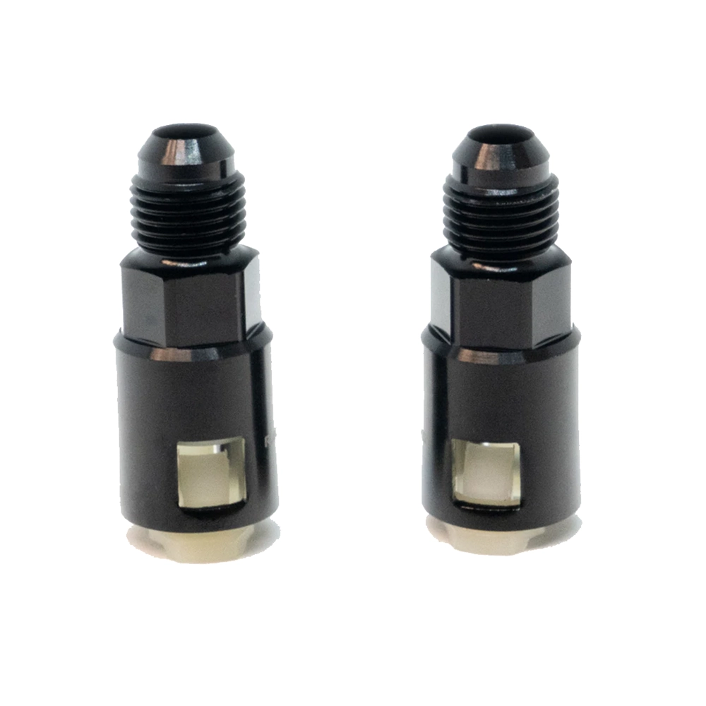

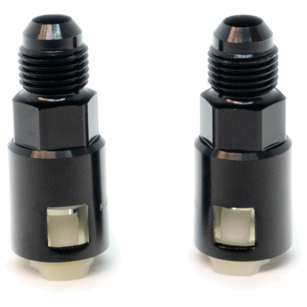

  • تركيبات AN-6

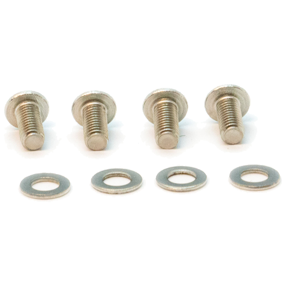

    مسامير ECS & غسالات
