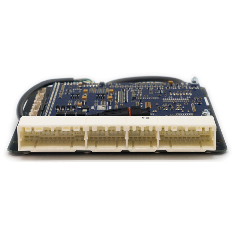

    This ECU is designed for the EVO 4-8 4G63 engine.
    Includes onboard 4 bar or 7 bar MAP sensor
    Suitable Applications:
    CN9A Lancer Evolution 4
    CP9A Lancer Evolution 5, 6 & 6.5 (TME)
    CT9A Lancer Evolution 7
    CT9A Lancer Evolution 8 (models with 4-plug ECU only)
    *Some EVO 8’s have a 3 plug ECU. These applications will need the EVO9X Link ECU
    Sequential fuel delivery
    OEM idle hardware supported
    CAN port
    USB tuning cable included
    Staged injection
    Knock with "windowing"
    I/O Expansion Options:
    The Mitsubishi Lancer Evolution IV - VIII plug-in ECU has two expansion connectors.
    Expansion connector 1:
    Gnd Sensor Ground Only
    DI 7 Digital input
    DI 8 Digital input
    DI 9 Digital input
    Aux 4 Auxiliary Output
    Expansion connector 2
    Aux 9 EThrottle - can't be used as an Aux Out
    Aux 10 Auxiliary Output
    An Volt 6 Analog 0-5V input
    An Volt 7 Analog 0-5V input
    An Volt 9 Analog 0-5V input
    An Volt 10 Analog 0-5V input
