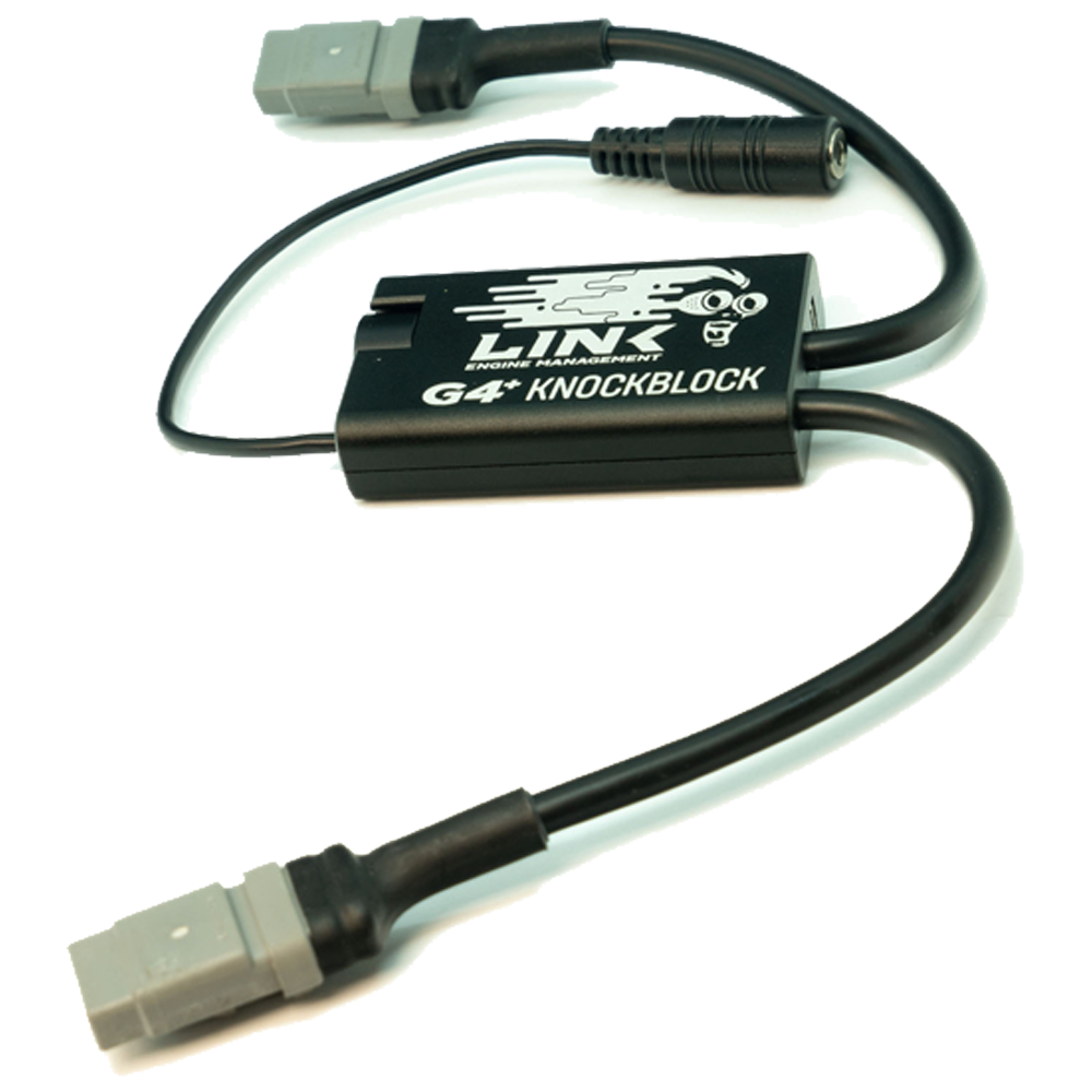

    The G4+ KnockBlock is an essential tool for tuning and can aid in the early detection of incorrect ignition timing, lean air/fuel mixtures and mechanical issues. It is used with earbuds, headphones or noise-cancelling earmuffs and features special filtering to allow you to listen in and detect knock early.
    Features
    Listen to one or two knock sensors
    Special filtering design improves the signal to noise ratio
    Can be used with ear-buds, headphones or noise-cancelling ear muffs
    Long-life lithium rechargeable battery
    Rugged CNC aluminium enclosure
    Flying lead headphones connector
    Can be used with all OEM knock sensors
    Can be used to interface directly to a laptop for the recording of engine noise or knock sensor frequency analysis (using PCLink G4+)
    Please Note: Headphones with their own noise filtering may be unsuitable for use with the KnockBlock.

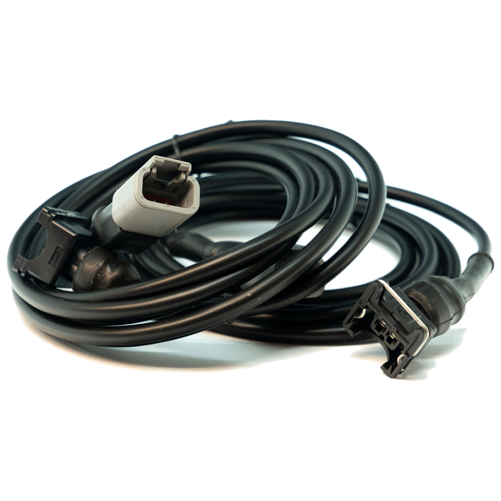

    • 2 Sensor Looms (attached)
    • 1 Headphone Loom (attached)

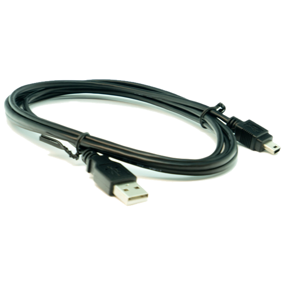

    • 1 USB cable mini

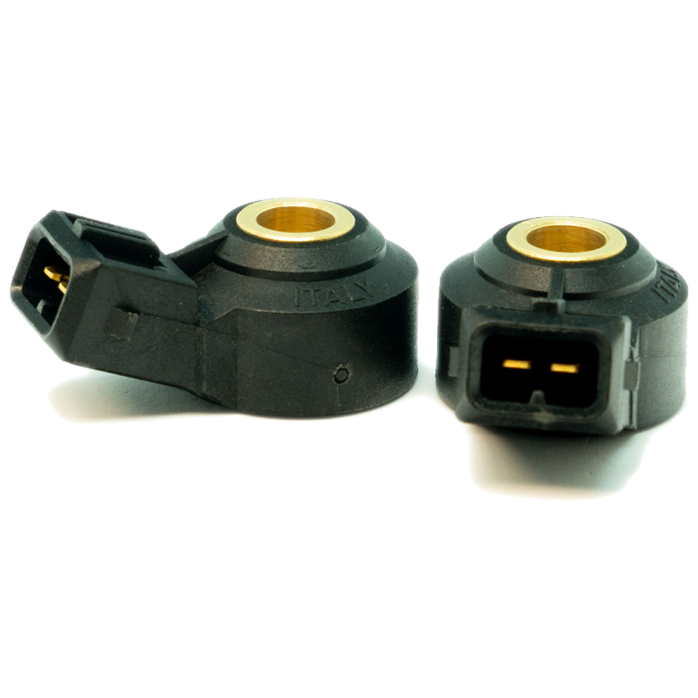

    • 2 Bosch type doughnut OEM knock sensors
