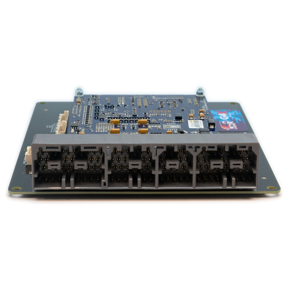

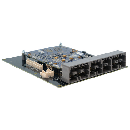

    Designed for the RX7 series 7-8 13BT.
    Suitable Applications:
    FD3S Series 7 RX7
    FD3S Series 8 RX7
    This ECU will support naturally aspirated, parallel twin or single turbo configurations. Does not support sequential control of the stock twin turbos.
    Sequential fuel delivery
    OEM idle hardware supported
    CAN port
    USB tuning cable included
    Staged injection
    Knock with "windowing"
    I/O Expansion Options:
    Expansion connector 1
    Gnd Sensor Ground Only
    DI8 Digital Input
    DI7 Digital Input
    An Volt 5 Analog 0-5V input
    An Volt 6 Analog 0-5V input
    An Volt 7 Analog 0-5V input
    Expansion connector 2
    Ign 5 Ignition 5 Auxiliary Output
    An Volt 9 Analog 0-5V input
    An Volt 8 Analog 0-5V input
    DI10 Digital Input
    DI9 Digital Input
