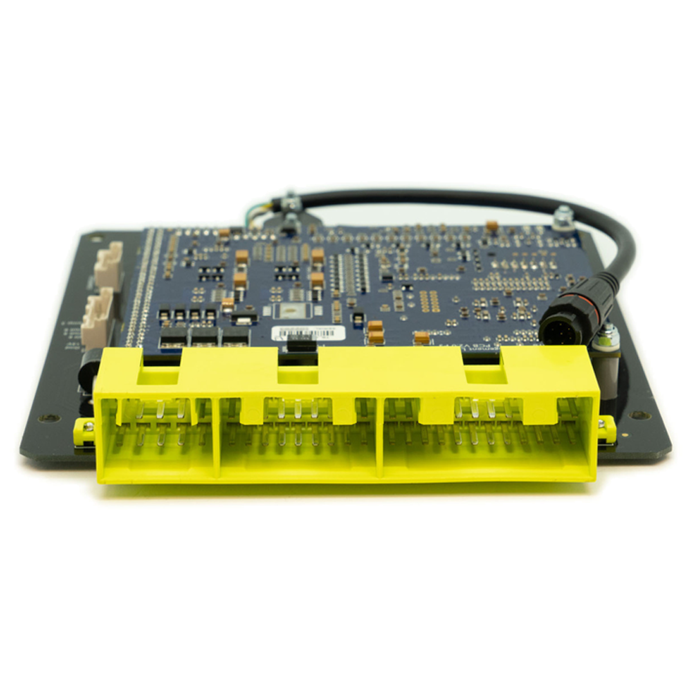

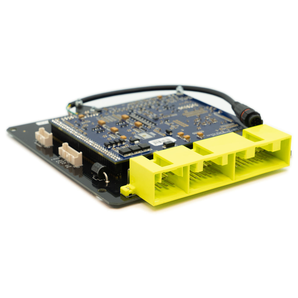

    This ECU is designed for the Vr4 4G63T engine.
    Includes onboard 4 bar or 7 bar MAP sensor.
    Knock control not available on this ECU.
    Suitable Applications:
    Mitsubishi Galant VR-4 E38A (1987-1992) with 4G63T engine
    Mitsubishi Galant VR-4 E39A (1987-1992) with 4G63T engine
    1G DSM with 4G63T engine
    Sequential fuel delivery
    OEM idle hardware supported
    CAN port
    USB tuning cable included
    Staged injection
    Knock with "windowing"
    I/O Expansion Options:
    Expansion connector 1
    Gnd Sensor Ground Only
    DI 6 Digital Input for switching functions.
    An Volt 5 Analog 0-5V input
    An Volt 6 Analog 0-5V input
    Expansion connector 2
    Aux 9 EThrottle - can't be used as an Aux out
    Aux 10 Auxiliary Output
    An Volt 7 Analog 0-5V input
    An Volt 9 Analog 0-5V input
    An Volt 10 Analog 0-5V input
