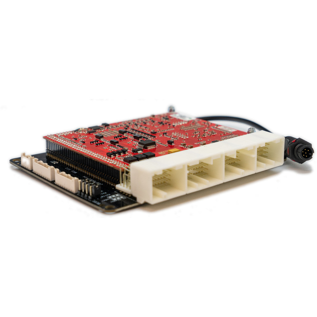

    Link Subaru WRXLink (V11) - WRX11X PlugIn ECU
    Designed for the WRX & WRX STI V11 EJ20/EJ25 Turbo (GR/GV/GH/GE chassis, MY2007-2011, Denso ECU from factory). All factory functions including DCCD, hill start assist, SI drive, cruise control, cam control & ABS supported.
    Note: Some North American models may have a Hitachi ECU which is not supported.
    • Please check your connector matches the header in the listed photo before purchasing.
    • This ECU works for manual transmissions only.
    • Air temp sensor is highly recommended.
    • Most factory features are supported.
    • Check the features tab for I/O expansion options.
    Note: This Plug-in features a new 4-pin powered CAN connector and cannot use the old CANPCB cable for CAN connection.  Use the CANJST4 (Link PN 101-0198) cable for connecting CAN devices.  This new 4-pin port and cable provide not only the CAN connection but also a protected 12V power supply and ground for powering the CAN devices.  The power supply is protected by a self-resetting fuse rated at 3A continuous.
    PlugIn Key Features:
    Precision closed loop cam control (four cam, independent control)
    Sequential fuel delivery
    OEM idle hardware supported
    Motorsport features - antilag, launch, flat shift
    Continuous barometric correction (on board)
    CAN port
    QuickTune - automated fuel tuning
    USB tuning cable included
    Real time selectable dual fuel, ignition and boost maps
    512 mega bytes data logging memory
    Staged injection
    Knock with "windowing"

    • Unlimited channels when using PCLink logging
    Communications
    • Tuning Port USB on board
    • Two CAN buses
    • Custom CAN configuration allowing tuners and end users to add support for new CAN devices
    Processing
    • 150 MHz Specialised Engine Management Microprocessor
    • Ignition control to 0.1 degree, fuel to 0.01 ms
    • 32 Bit Floating Point Calculation
    • 12 Bit ADC Resolution
    • 20000+ RPM
    • 4Gb Non Volatile Flash
    Environment
    • Internal Temperature Range -10 - 85oC
    • Ambient Temperature Range -30 - 90oC
    • Voltage 8 - 22V
    • Operating Current 200mA
    • Electrical protection on all inputs and outputs
    • Onboard Barometric Pressure Sensor
    Packaging Contents
    • G4X PlugInX ECU
    • 2 large Link Stickers
    • 2 small Link Stickers
    Manufacturing Standard – ISO 13485
    Additional Accessories (purchased separately)
    • Intake Air Temperature Sensor
    • 3/8 NPT (Aluminium or Steel Mounting Bosses to suit)
    • 3 Channel Link Igniter
    • Throttle Position Sensor
    • Wideband O2 Controller & Sensor
    • Injector Ballast Resistor Packs
