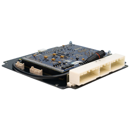

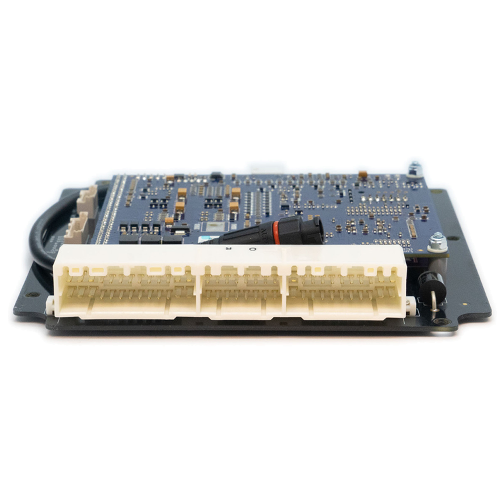

    Designed for the 3SGTE engine in the models specified below.
    A Link Air Temp Sensor is highly recommended with this ECU
    Suitable Applications:
    Toyota MR2 (SW20) from 1989 to 1992
    Toyota Celica ST185 (except the GT-Four RC/Carlos Sainz Special Edition which is compatible with the Link TST205X Plugin)
    Sequential fuel delivery
    OEM idle hardware supported
    CAN port
    USB tuning cable included
    Staged injection
    Knock with "windowing"
    I/O Expansion Options:
    Expansion connector:
    Gnd Sensor Ground Only
    DI 5 Digital Input for switching functions.
    DI 6 Digital Input for switching functions.
    DI 4 Digital Input for switching functions.
    An Volt 4 Analog 0-5V input
    An Volt 5 Analog 0-5V input
    An Volt 6 Analog 0-5V input
    An ignition expansion is provided allowing you to convert to a Direct Spark ignition system. Alternatively, these outputs can be used to drive auxiliary devices. The following pinout describes the available connections.
    Ignition Expansion:
    1 Ignition 1
    2 Ignition 2
    3 Ignition 4
    4 Ignition 3
