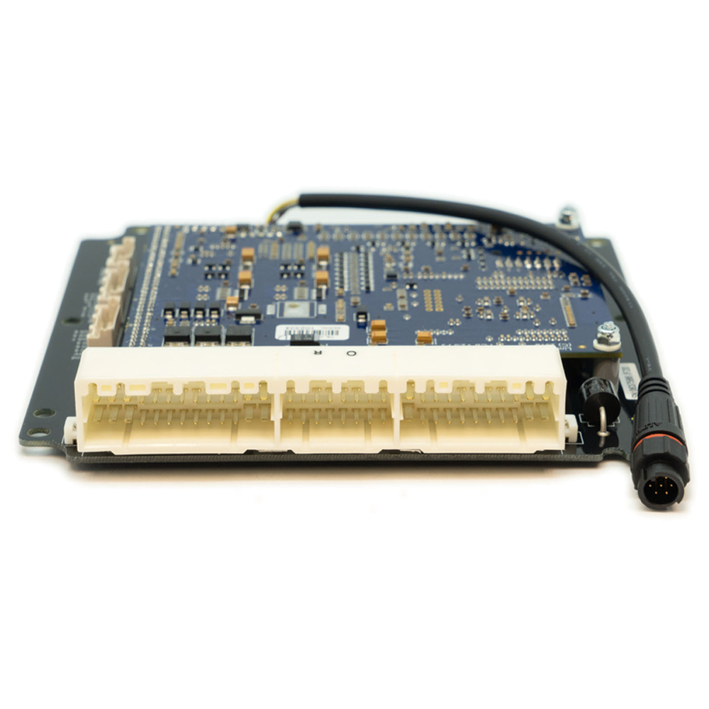

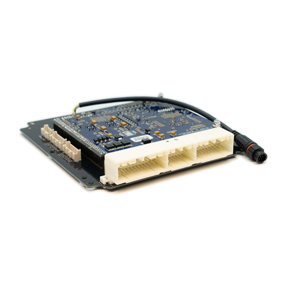

    Designed for the 3SGTE engine in the models specified below.
    ECU does not fit in the original housing of non-turbo cars
    Suitable Applications:
    Toyota MR2 1993 onwards (Gen3 3SGTE) not including RedTop Beams
    Celica ST205
    Carlos Sainz Edition
    GT-Four RC
    Group A Rallye
    Sequential fuel delivery
    OEM idle hardware supported
    CAN port
    USB tuning cable included
    Staged injection
    Knock with "windowing"
    I/O Expansion Options:
    The Toyota Supra plug-in ECU has two expansion connectors.
    From PCB revision 1.2:
    Expansion Connector 1:
    nd Sensor Ground Only
    DI 5 Digital Input
    DI 6 Digital Input
    DI 4 Digital Input
    An Volt 7 Analog 0-5V input
    An Volt 5 Analog 0-5V input
    An Volt 6 Analog 0-5V input
    Expansion Connector 2
    GIgn 5 Ignition 5 Auxiliary Output
    DI 9 Digital Input
    DI 10 Digital Input
    Volt 8 Analog 0-5V input
    Volt 9 Analog 0-5V input
