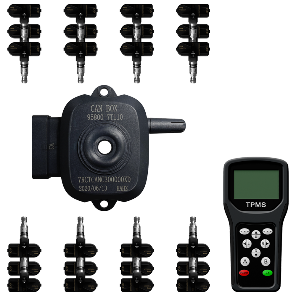

The TPMS Plug & Play Car Racing Tyre Pressure Monitoring System is the ultimate kit for alerting drivers to a change in tyre pressure and for providing data on tyre pressures throughout your race.
Compatible with our dash display/Loggers Manage multiple wheelsets
1 Mbit CAN interface Suitable for Motorsport
Pressure accuracy +/-20Mbar CE & FCC Compliant
The Plug & Play Tyre Pressure Monitoring System utilises robust sensors for each wheel; these high-resolution sensors measure tyre pressure and temperature, transmitting securely coded data to the onboard receiver.
Tyres are critical to racing performance and, getting the best from each tyre is essential to unleashing pace. Unfortunately, constant braking, turning, and enormous rotational forces can lead to incredibly high-temperature build-up in the tyres.
The TPMS is the ultimate tool for alerting drivers to a change in tyre pressures and providing data on how the tyre pressures alter throughout your races.
All Sensors are pre-programmed in-house to be set 1, set 2 or set 3 or more if required. These can be changed as needed with the handheld programming unit.
The TPMS is compatible with our Aim Dash/Loggers (except Solo 2 & Mychron 5s). In addition, it provides a method of displaying or logging real-time tyre pressures.
The connection to our AiM dash/Loggers is typically on CAN2. The CAN Protocol is available in the Downloads Tab.
You may require an extra loom or connector for the dash as the CAN2 connection is on the second connector. Please see the technical documentation for your device for connection information.
Please Note: AiM Dashes and Loggers will require a CAN Protocol obtained from the Downloads Tab.
Lightweight sensors
Automatic learning functions for sensor serial numbers & wheel location
CE & FCC Compliant
Connection output for CAN 2.0A up to 1 Mbit/s (default)
Pressure & Temperature resolution per wheel 15.7 Mbar
Pressure & Temperature accuracy per wheel +/- 20Mbar
Sensors & receiver protection IP67
Any number of sensors can be added to the system
1 Receiver required for all four sensors
Sensor update frequency 2Hz
When it comes to grip, tyre temperature is vital.
4 Sensors & Receiver 8 Sensors & Receiver
12 Sensors & Receiver 16 Sensors & Receiver
20 Sensors & Receiver  24 Sensors & Receiver

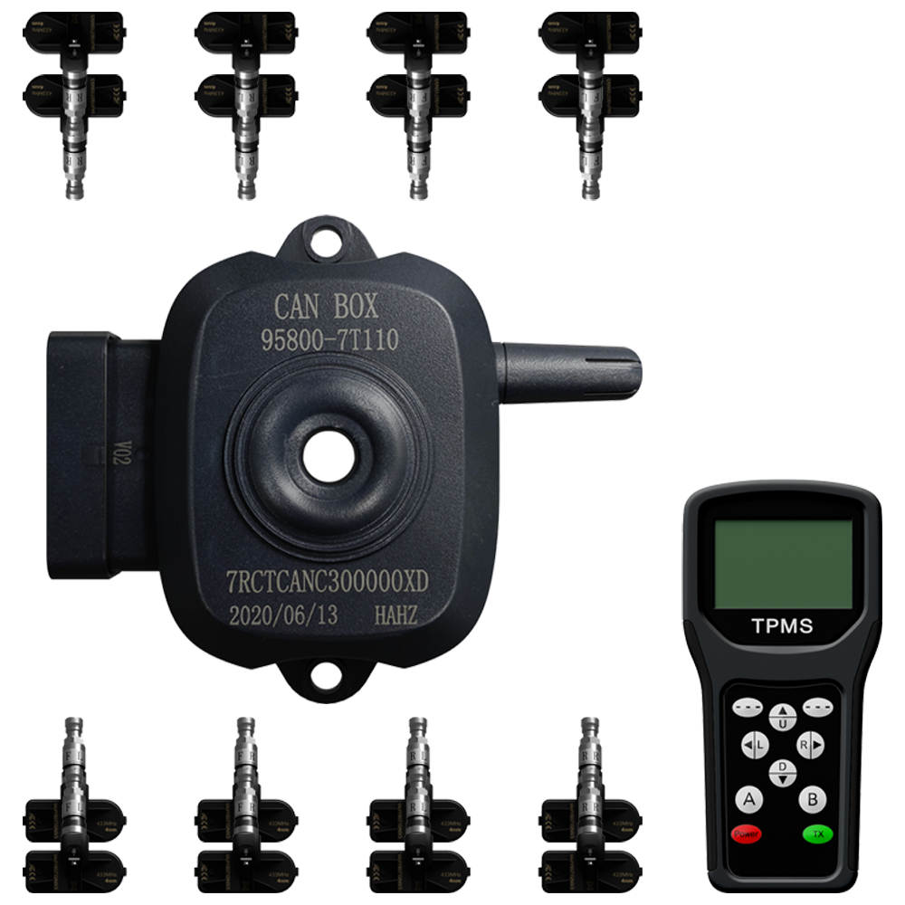

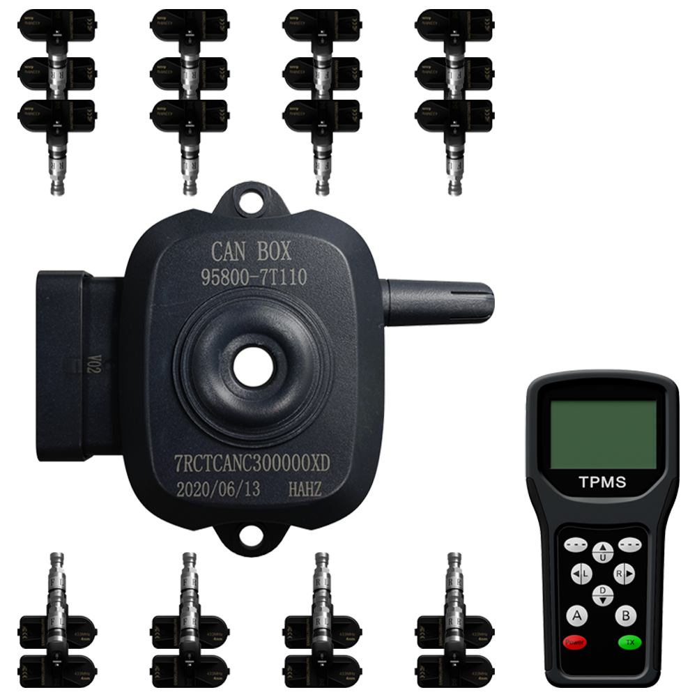

TPMS Receiver
The TPMS Receiver is compatible with race car applications and competitions. The receiver utilises 1 Mbit CAN (11 bit), which has become standard over the years for professional ECUs, Data Loggers and dashboards within motorsport.
The receiver has four unique identification numbers for corner positions and will ensure that it can read only the sensors with these numbers. Can programme any number of additional sensors. With serial numbers to make them compatible with the receiver.
You can use the receiver for one, two, or three and more sets of wheels.
TPMS Sensors
The TPMS sensors are already pre-assigned FR, FL, RR, RL, so all you need to do is connect the sensors to the correct tyre, and all the data will be recorded on the receiver and then overlayed onto your dash/logger.
Each of the TPMS Sensors has a battery lifespan of a minimum of two race seasons.
We offer sets of sensors that are fully programmed in-house, so you can purchase as many spare sets as required.
Spare sensors can be programmed with any of the serial numbers that have been allocated to the receiver and sensor IDs of two unmounted wheels can be swapped.
The sensors are supplied with a 11mm valve stem.
When sensors are relocated to a different position on the car, you can automatically assign them to their new position using the TPMS hand programmer using the read function. Any sensor can be allocated to any four corner locations, and they must have different serial numbers.
Please Note: Should you wish to purchase extra sensors, you will need to buy the Handheld programming Unit. The unit will manually programme the sensors and read parameters such as pressure, temperature and battery voltage.
Optional Hand Programming Unit
The TPMS Hand Programming Unit can read sensors such as Temperature, Pressure, voltage and Serial Numbers. It is rechargeable with the USB cable supplied.
The programming unit can programme replacement or additional sensors.
This Hand Held Programming Unit, is Free when purchasing 16 or more sensors.
