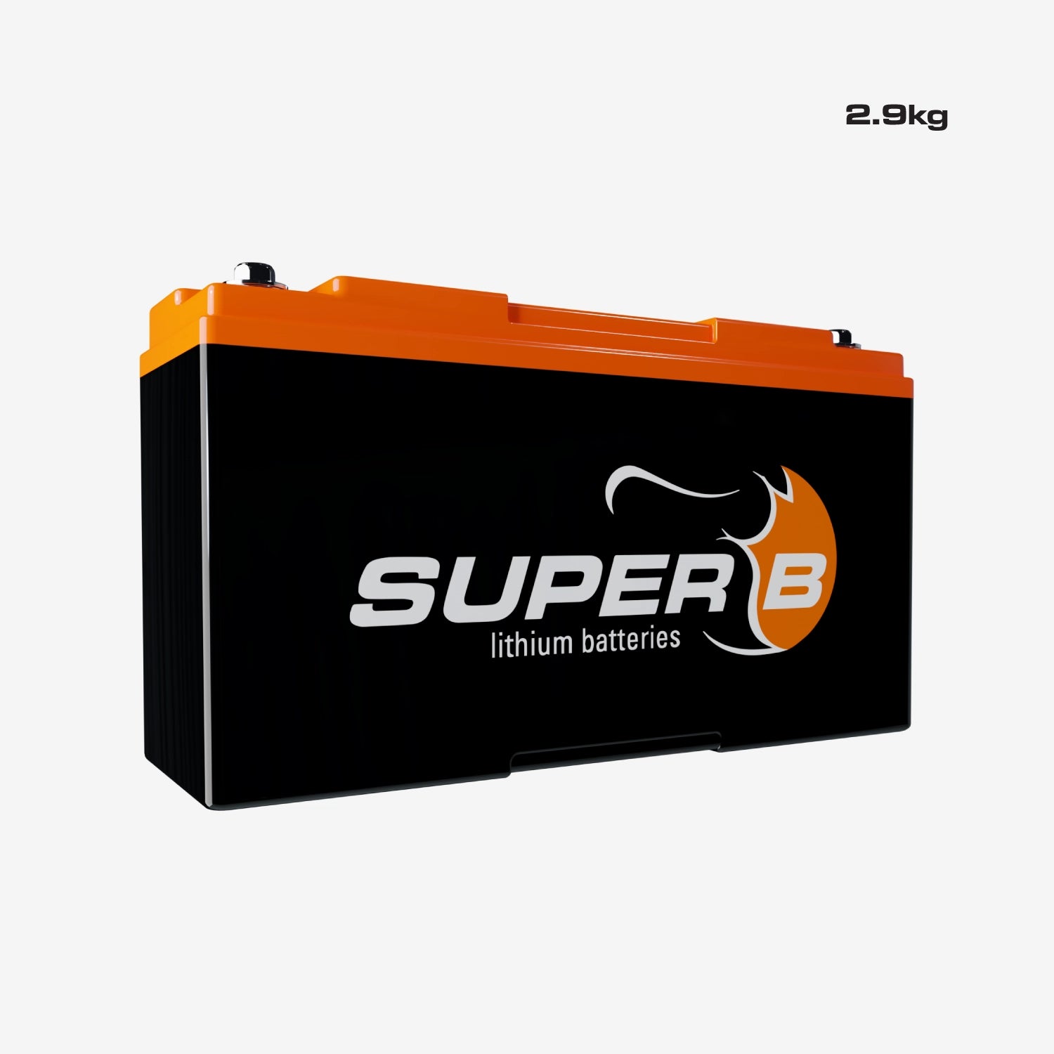

The Super B Andrena 12V15Ah-SC Lithium Battery is compact in size, measuring in at 249 x 96 x 141mm and weighing 2.9kg, so it is perfect for vehicles that need a smaller power source with high energy capacity.
