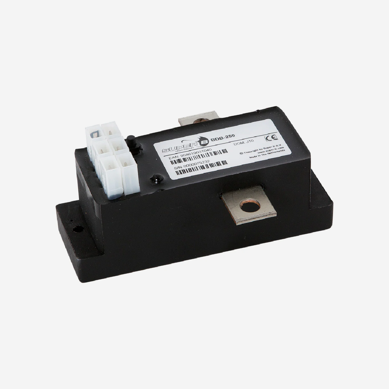

    Super B SB BDB 250 Under / Over Voltage Protector
    External under and overvoltage protector, to secure the Andrena lithium power batteries against under- and overvoltage with the lowest possible standby current.
    SB BDB 250
    For the securing of a LiFePO4 (lithium iron phosphate or LFP) battery against under and over voltage with the lowest possible standby current.
    3 Year Warranty
    A 3-year warranty offers the best peace of mind. It is the benefit of years of continuous engineering improvement and proven experience with all of our batteries in the harshest environments.
    Technical Specifications
    ELECTRICAL SPECIFICATIONS
    Dimensions 82 x 57 x 120mm / 3.2" x 2.2" x 4.7"
    Weight 370 gr / 81.6 Ibs
    Autodetect 12V 8V to 20V
    Autodetect 24V 20V to 35V
    Current consumption 2mA
    Input surge current (100ms) 12V mode 2.6A
    Input surge current (100ms) 24V mode  5.0A
    Switch current continues 250A
    Switch current peak 1.500A
