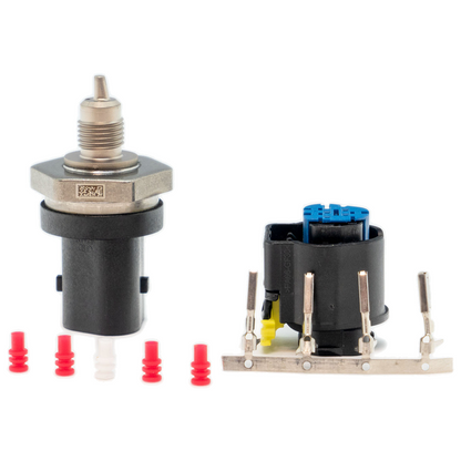

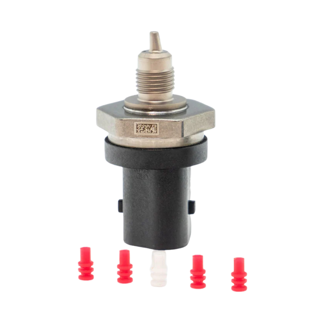

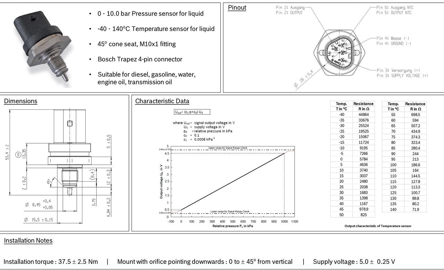

The Link combined pressure and temperature sensor integrates two sensors in one: a 10 bar (145 PSI/1,000 kPa) liquid pressure sensor and a -40 to 140°C (-40 to 284°F) liquid temperature sensor. It is suitable for use with oil, coolant, fuel, transmission fluid, and other liquids.
Why Choose the Combined Pressure & Temperature Sensor

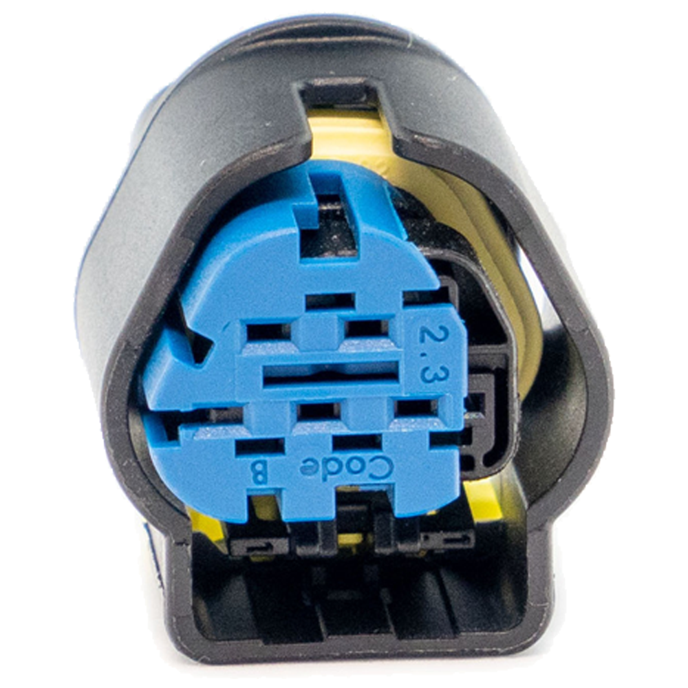

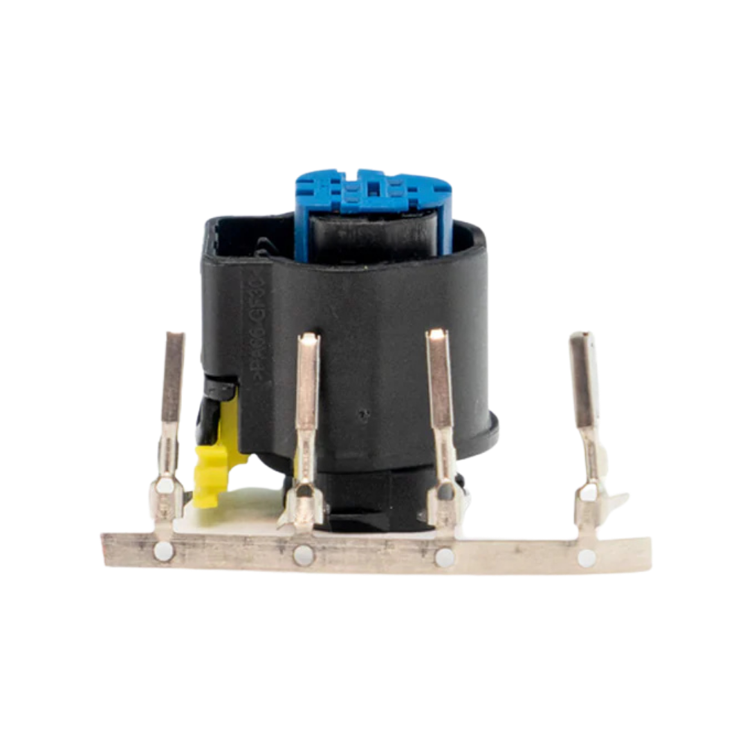

The Link combined pressure and temperature sensor features an M10x1 fitting with a 45-degree cone seat for secure, leak-free installation and is supplied with a Bosch Trapez 4-pin mating connector kit for easy and reliable wiring.

Link Combined Sensor
Bosch Trapez 4-Pin Connector Kit
