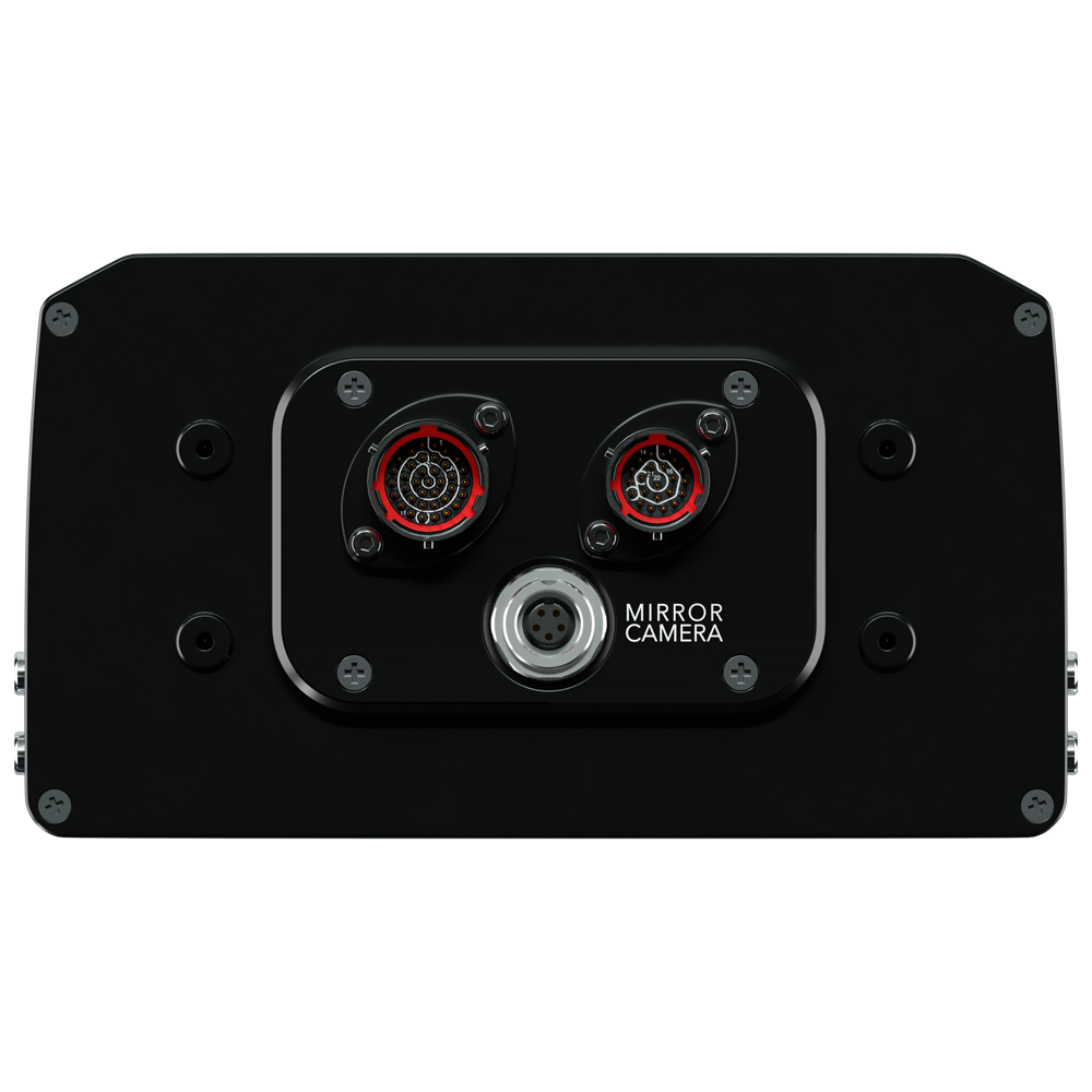

Two analogue camera inputs are available, to switch your display into a mirror camera, through a pushbutton command or event management. The camera sold separately.
