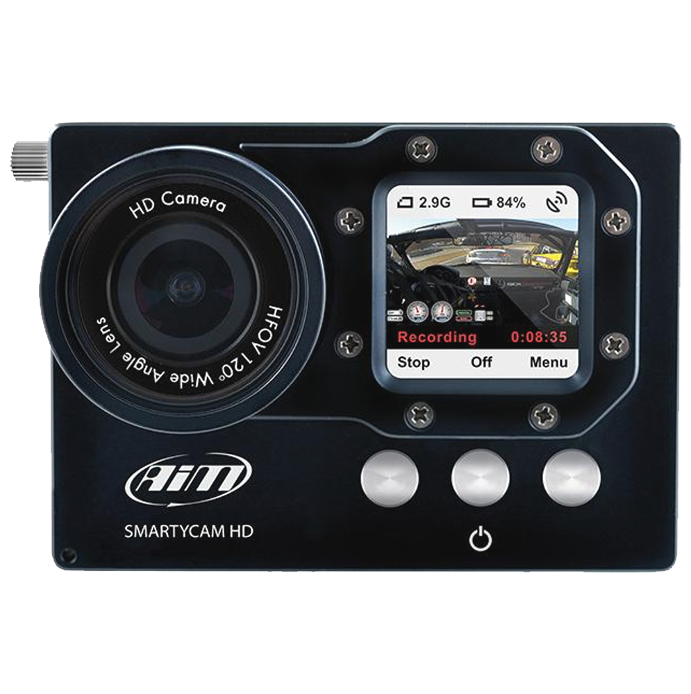

This SmartyCamHD 2.1 is fully equipped and ready to take on its second life. The product is in full working order at a reduced price, and has been meticulously checked by our technicians.
Wide Angle Motorsport Camera
Designed for motorsport environments with a single purpose to provide you with great videos that include all the technical information that will help you improve your performance. All this in the most robust and reliable system ever.
Why Choose the Aim SmartyCam HD 2.1
Compact in size, the Aim SmartyCam HD 2.1 is ideal for installation in most motorsport setups. Its aluminium casing makes it extremely lightweight, robust and reliable too, so you can get all the footage you need directly from the driver's seat.

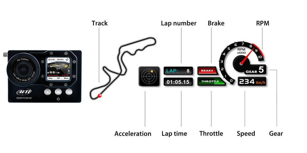

Real Time Data Overlay
The SmartyCam HD 2.1 camera automatically overlays on your video all the data you need: speed, RPM, lap number, gear shifts, and much more. Simply choose the data and graphical layout you prefer from the different overlays available.
Data can be read from a number of sources. From GPS track map and vehicle position, as well as speed, lap times and split times. Aim logger/dash logger connected to your ECU - RPM, throttle, engaged gear, acceleration, temperatures, pressures, etc.

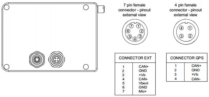

Camera Connections
The perfect connection to get all your data from the ECU merge them with the GPS information and transmit everything to the SmartyCam HD then watch the graphical overlay in the video.
SmartyCam can be used with all of our Aim dash display loggers (except Solo 2). With our data hub 4x CAN connection multiplier you can add a GPS Module or extra cameras  to your system.

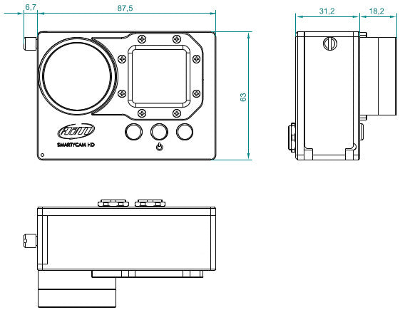

  • Dimensions: 87 x 63 x 49mm
