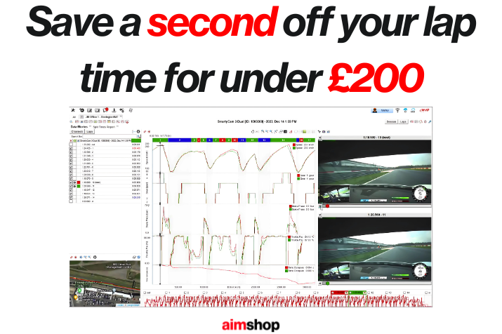

Save a second off your lap time with brake pressure sensors graphic
While we cannot guarantee how much time you will save per lap, we can absolutely promise that by understanding how to use a brake sensor within your data, most people will gain back over a second per lap.

Understanding The Brake Trace
The brake trace (or braking graph) is a visual representation of how you apply brake pressure throughout a braking event during a lap. To achieve the best braking practice, the ideal brake trace typically has these characteristics:
Sharp Initial Application (Peak Pressure)
  • What it looks like: At the beginning of the braking zone, the graph shows a sharp upward spike as you quickly apply maximum brake pressure.
  • Why it’s ideal: You want to reach peak brake pressure as quickly as possible without locking the wheels, which maximises deceleration while maintaining control.
Consistent Peak Pressure (Flat Top)
  • What it looks like: After the initial spike, the brake pressure should hold at or near peak pressure for a period (depending on the corner's requirements).
No Early Release or Snail-Like Decay
  • What it looks like: There should be no sudden or premature release of brake pressure; ideally, the graph should show a smooth, controlled drop in brake pressure as you reach the apex of the corner.
  • Why it’s ideal: If you release the brake too early, you’re not using the full braking potential of the car, which reduces lap time. A jagged or inconsistent release can destabilise the car and make corner entry harder.
Minimal Oscillations
  • What it looks like: Ideally, the brake pressure curve should be smooth without significant fluctuations. If the trace has spikes or drops mid-braking, it indicates inconsistent application of brake pressure.
  • Why it’s ideal: Oscillations suggest you're not applying brake pressure smoothly, which can lead to unpredictable car behaviour or excessive tyre wear.
Example Of The Ideal Brake Trace
  • Sharp initial rise: From 0 to peak pressure (typically at 100-200ms after entering the braking zone).
  • Sustained high pressure: Flat or slightly sloped plateau for the majority of the braking zone.
  • Smooth tapering off: Gradually reducing the pressure over the final 50-100 meters (depending on corner specifics).
What Bad Practices Look Like
  • Late application: If you see a delayed rise to peak pressure (you start braking too late), it means you’re losing valuable time during the braking zone.
  • Too early or too quick of a release: If the brake pressure drops too quickly, it indicates you’re not maximising braking efficiency.
  • Jagged oscillations: This can be a sign of improper modulation of the brake pedal or aggressive driving inputs that destabilise the car.
By analysing the brake trace and aligning it with these best practices, you can ensure you're braking as effectively and efficiently as possible.
