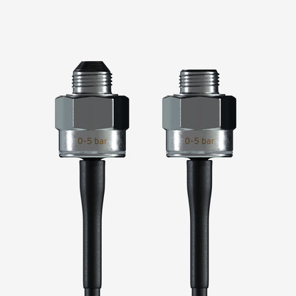

    The Aim 0-5 Bar absolute boost pressure sensor is suitable for manifold air pressure, reading pressures up to 5 bars.
     0-5 Bar 4 pins 719 male binder
    Aim Absolute Boost Pressure Sensor 0-5 Bar
    The Aim Absolute boost pressure sensor, fitted with a male four pin black 719 binder plug connection, suits all Aim loggers and dash display/loggers.
    Stock vehicle boost sensors are often slow to react and low resolution, offering limited logging and therefore using analysis software.
    The Aim sensor is high resolution, fast responding and above all reliable, making it perfect for anyone serious about keeping their turbo engine in good health and tuning boost to its most efficient level. Suitable for manifold air pressure reading (MAP), read the depression to -1 bar about atmospheric pressure and absolute pressure up to 5 bars.
    This sensor is available with -3 JIC (3/8-24 UNF) ot M10 threads.
    Connections
    • Supply: 8-16V
    • Consumption: < 10 mA
    • Sealing: IP66
    • Weight: 30g
    • Cable Length: 400mm
