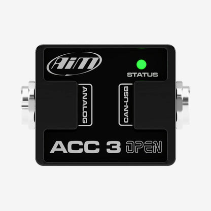

ACC3 Open: Versatile Analogue CAN Converter

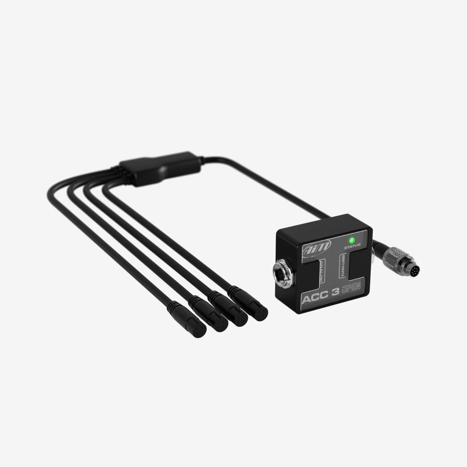

The Aim Analogue CAN Converter (ACC3) Open combines compact design with powerful capability, managing up to 4 channels at 200Hz each, while adding the flexibility of CAN output. This makes the ACC3 Open an ideal choice for teams looking to integrate Aim sensors into third-party data systems or to share data across multiple devices. Fully compatible with the Aim Solo 2 DL, the ACC3 Open gives you freedom beyond the Aim Technologies ecosystem.
Why Choose the Aim ACC3 Open
The Aim ACC3 Open builds on the strengths of the standard ACC3, while adding the versatility of open CAN communication, making it the perfect option for teams running mixed-system environments.
In addition to handling up to 4 analogue inputs and 2 speed inputs, the ACC3 Open can output data via CAN, allowing it to communicate with third-party systems such as MoTeC, Pi, VBOX, Cosworth, Bosch, and other motorsport brands. With the ability to define bit rate protocols, field messages, and payload details, it offers complete control over how your data is shared and integrated.
The ACC3 Open can still function as a seamless Aim expansion, but with the added advantage of cross-brand compatibility, ensuring your sensors and data remain useful even if your setup evolves. This makes it a future-proof solution for teams that demand both the reliability of Aim hardware and the flexibility to connect with external networks.

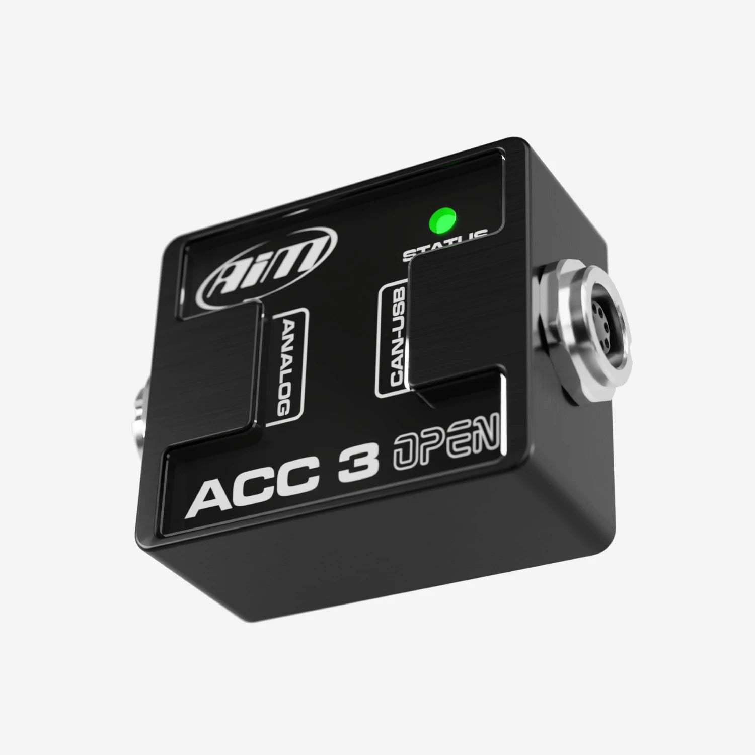

What sets the Aim ACC3 Open apart is its ability to build a dedicated CAN output for communication with external devices. This allows you to define bit rate protocol, field messages, and CAN payload details, making it compatible with other motorsport data networks. The ACC3 Open can also be used as an Aim expansion without limitations, giving you complete control over how your data is shared and analysed.

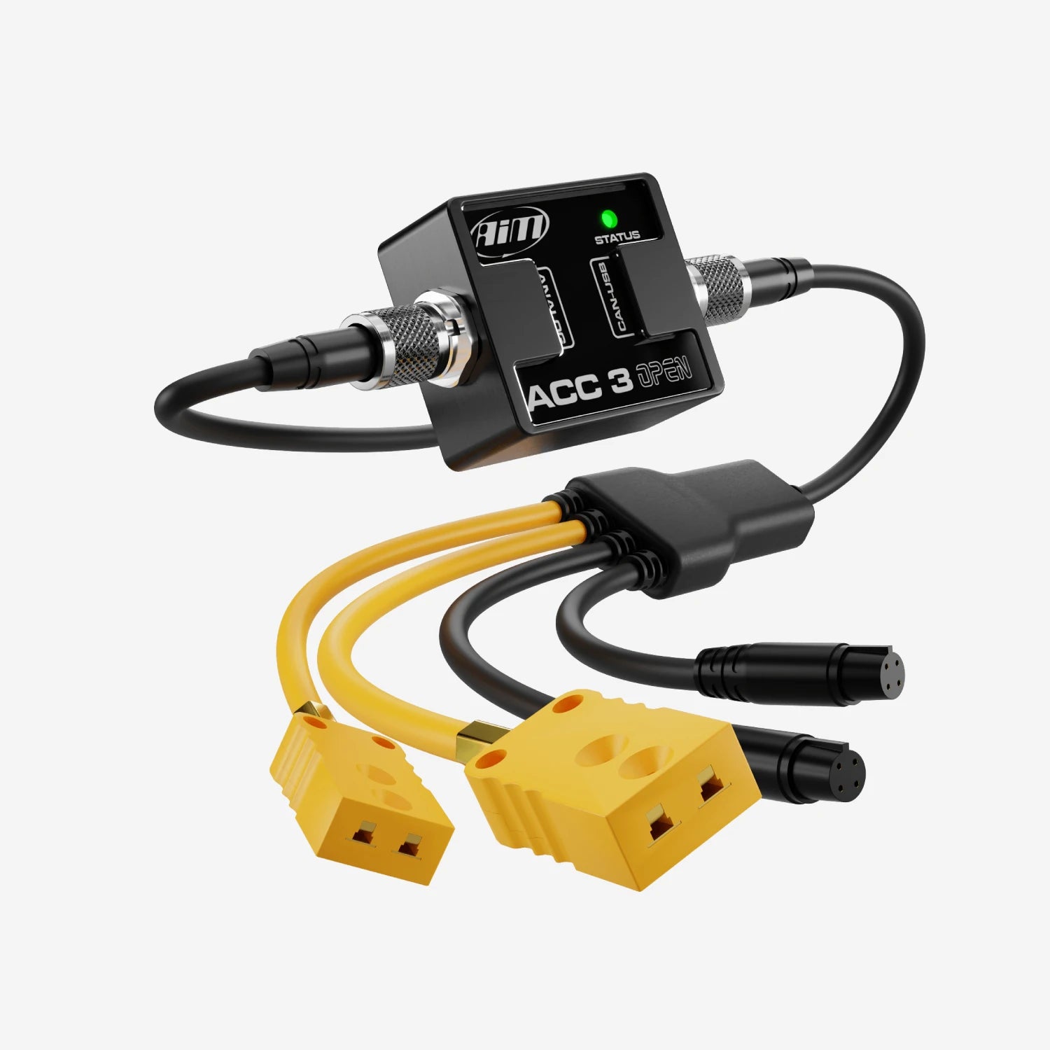

By selecting the appropriate harness, channels can be customised to the sensors you connect. The ACC3 Open supports up to 4 K-type thermocouples for accurate temperature measurement across multiple areas of your vehicle.

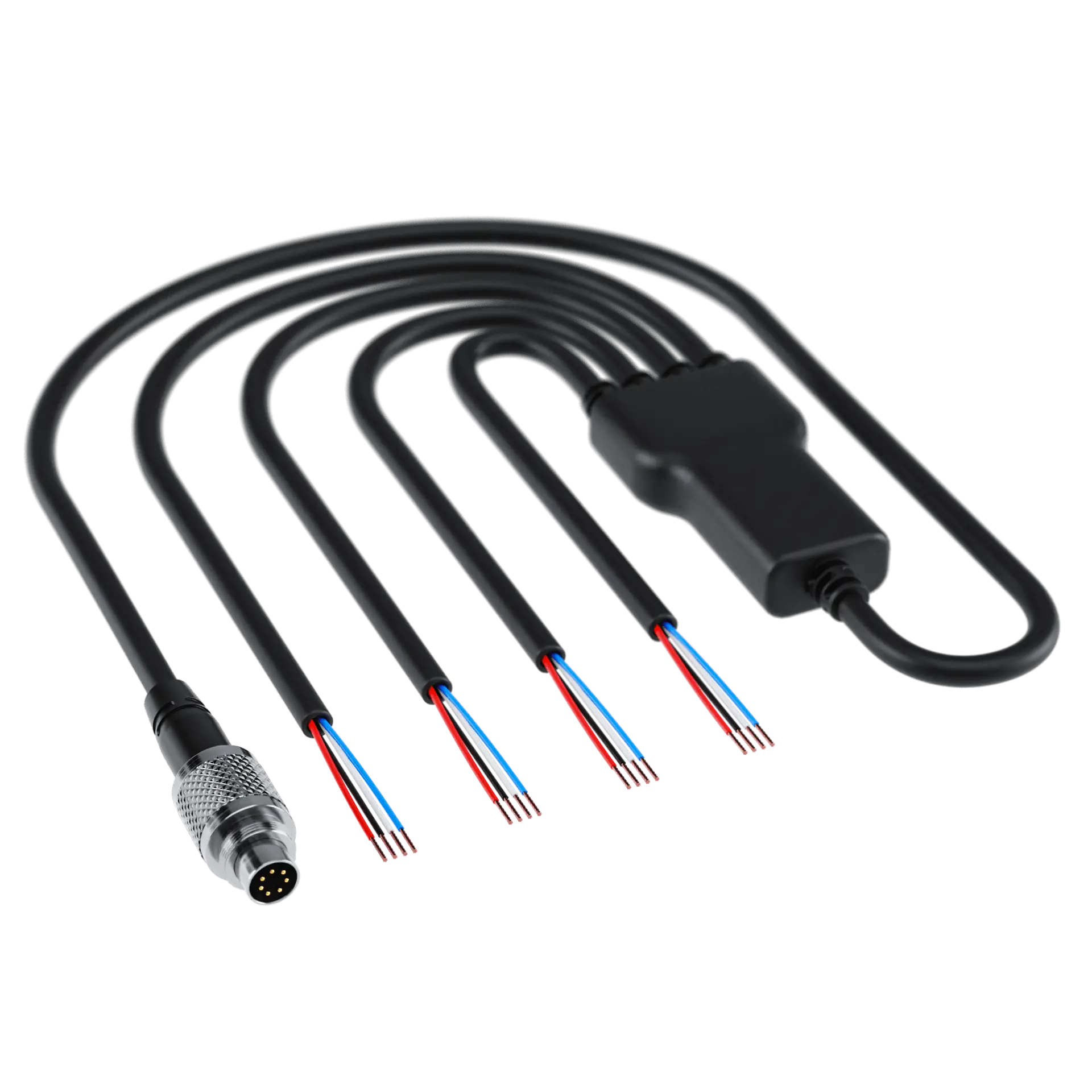

ACC3 Open Harness
