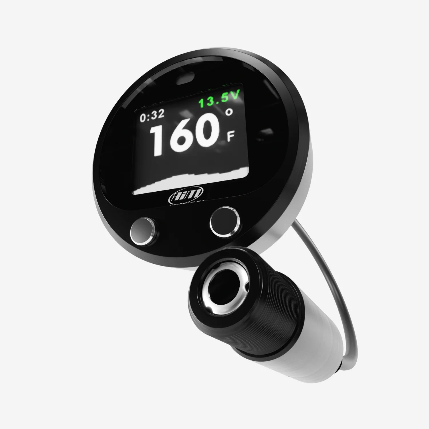

The IBTS has:

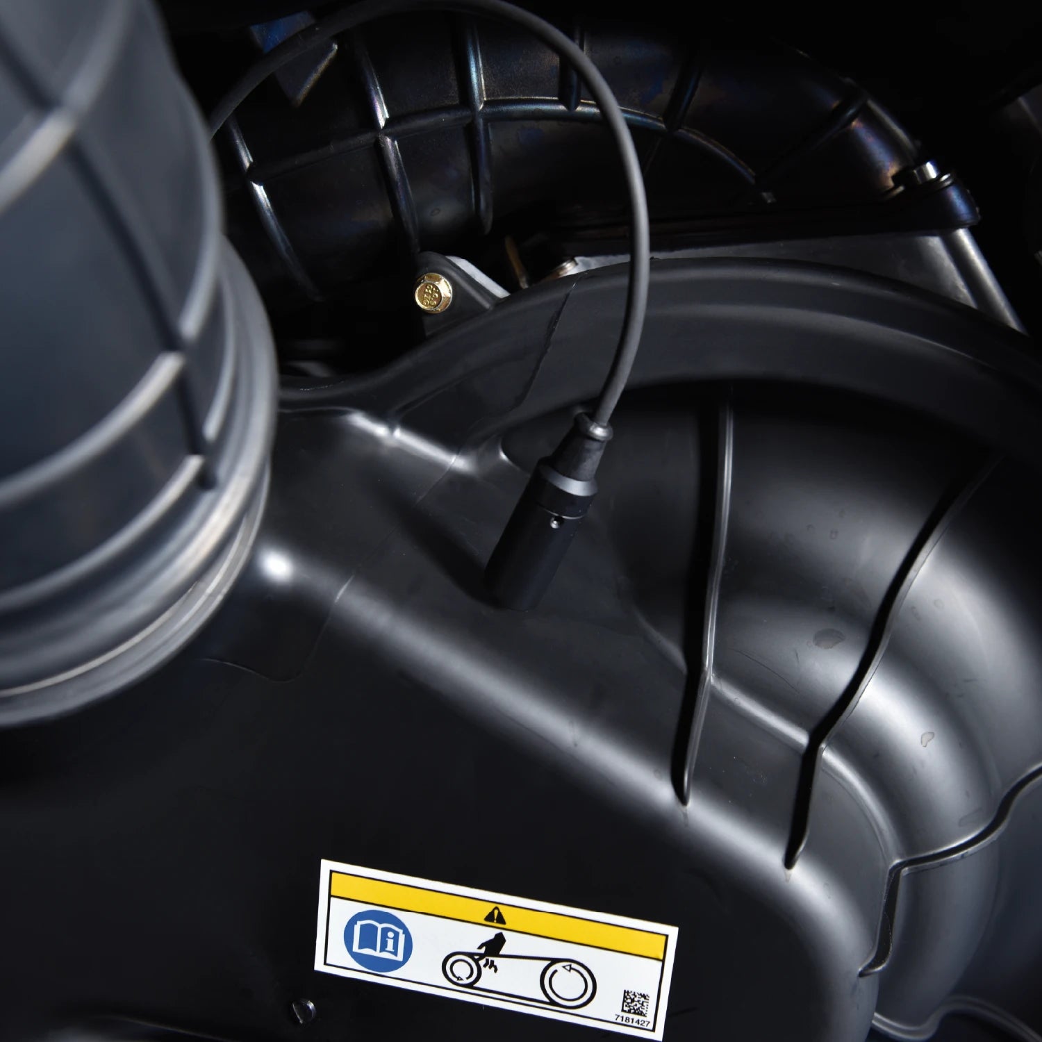

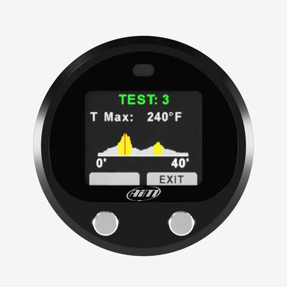

  • Single Point Sensor: Gauges and displays average belt temperature with accuracy.
  • Multi-Point Sensor (optional): Divides the area into 16 zones, sending readings every 0.1 seconds via CAN communication for maximum insight.
Data is automatically recorded every 10 seconds and stored in the internal memory for easy review after use.

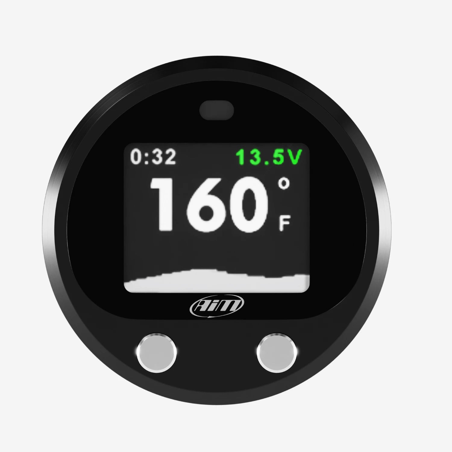

Smart Alerts & Easy Monitoring
Set your own warning and alarm thresholds to stay ahead of any issues. These alerts are  essential insights, acting as an early warning system that helps prevent serious mechanical damage or unexpected breakdowns.
Here’s alert on the IBTS why each matters:

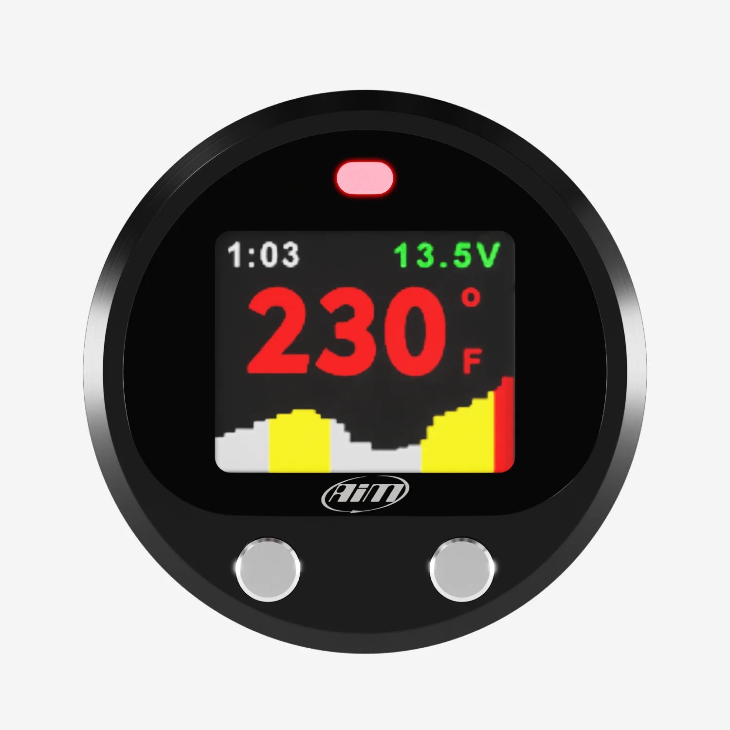

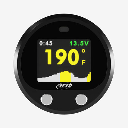

  • Temperature Alerts: The drive belt is critical in a UTV. If it overheats, it can slip, wear out prematurely, or fail completely, leaving you stranded and facing expensive repairs. The yellow and red alerts let you react before it gets to that point, protecting both performance and reliability.

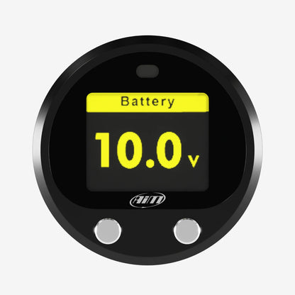

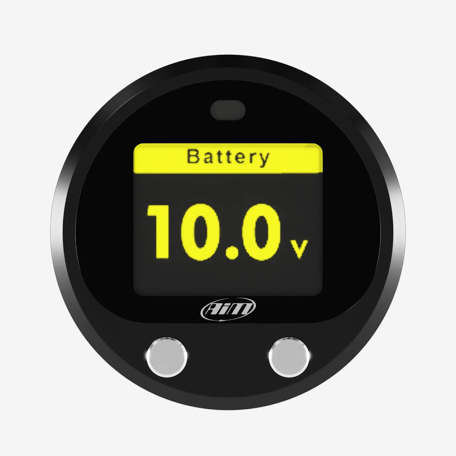

  • Voltage Alerts: A healthy battery and electrical system are essential for powering gauges, lights, ignition, and accessories. If voltage drops too low or spikes too high, it can cause failures or damage components.
Alerts ensure you know instantly when something’s wrong, so you can fix it before it costs time or money. Therefore, for temperature alerts you will see yellow for warnings, and red for alarms (with flashing LED and on-screen message). For voltage alerts, normal voltage will be shown in green, and you can set custom thresholds that trigger yellow or red alerts for anything else.

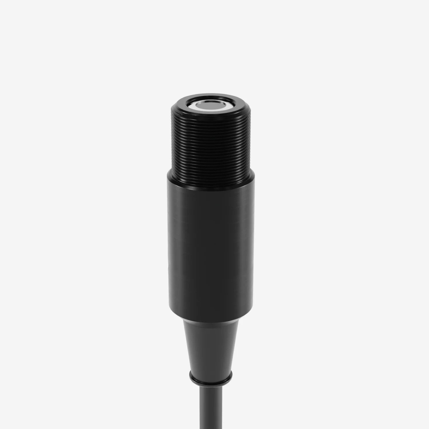

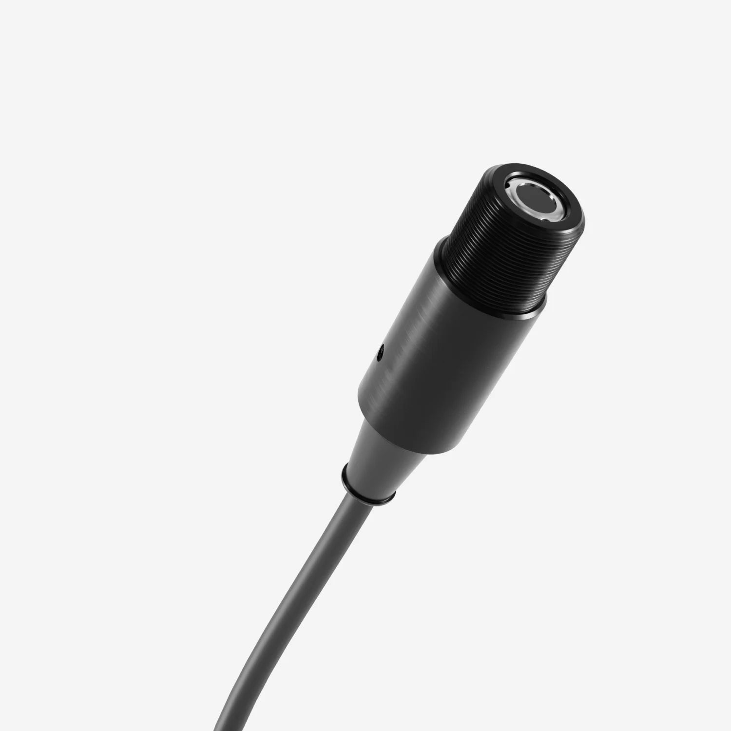

Single Point Sensor
  • Measurement Points: 1
  • Field of View: 12°
  • Temperature Range: -60/550°F
  • Real time temperature tracking
  • Average temperature tracking
  • Tracks average temperatures over the last 15', 30' or 90' of run time

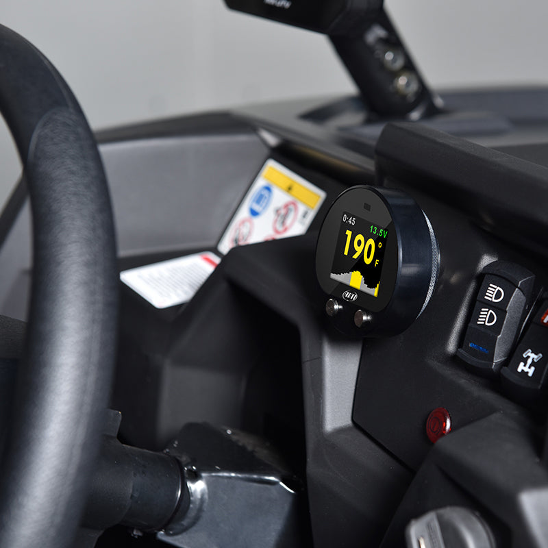

Gauge Display

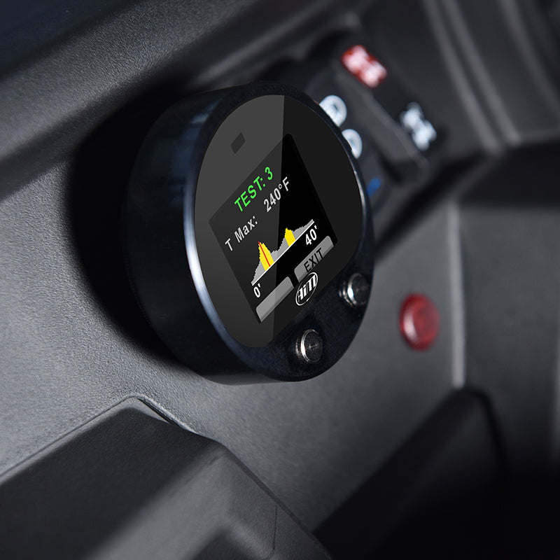

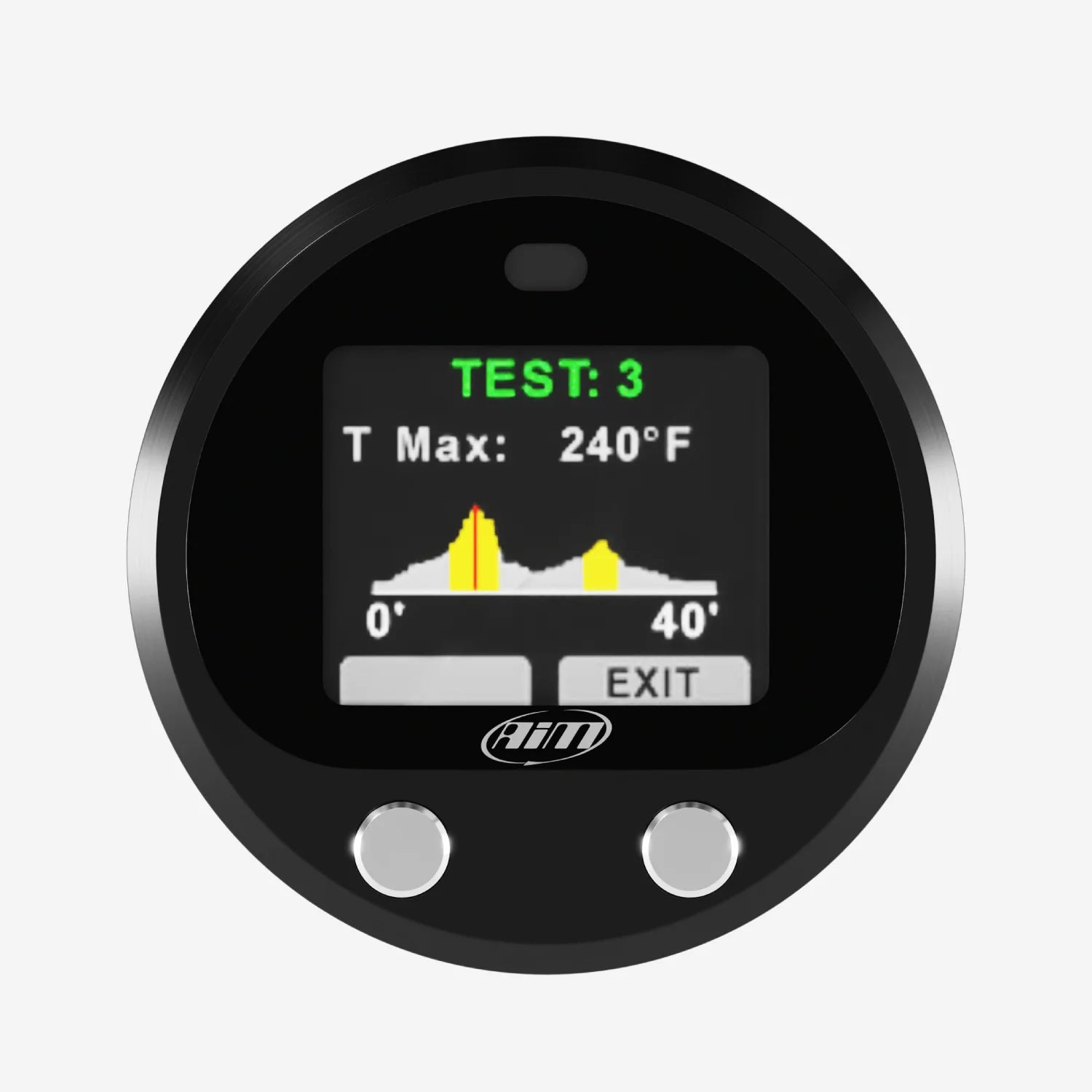

  • RGB LED Alerts: The LED starts blinking red when the temperature exceeds the user-defined level
  • Body: Anodised aluminium
  • Anti-Glare TFT display
  • Vibration proof
  • Water Resistance: IP65

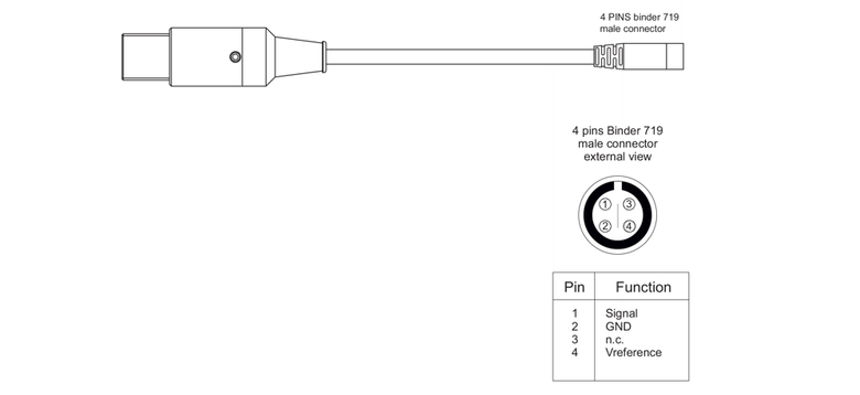

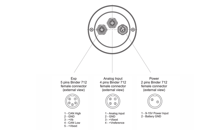

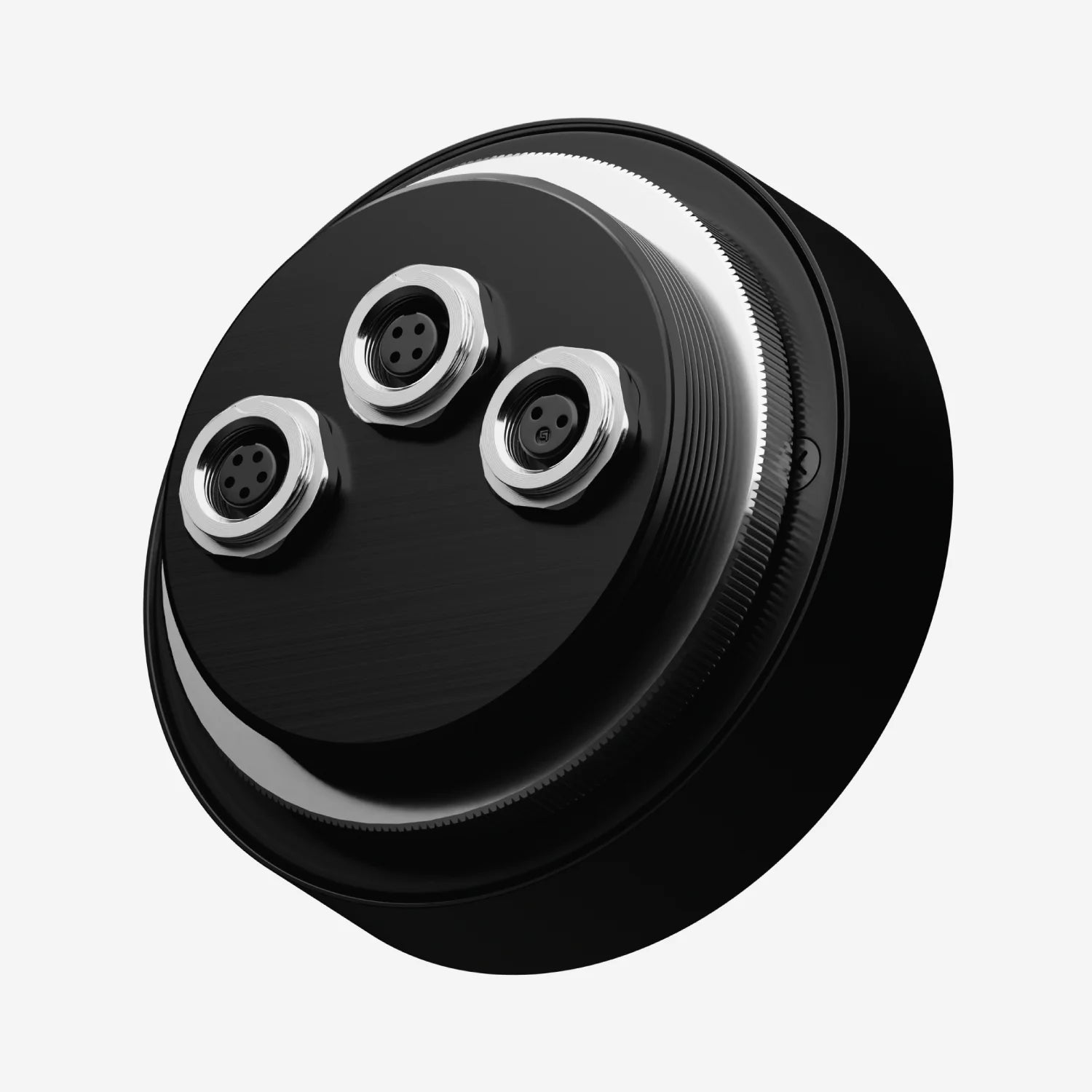

Pinouts
  • Aim Sensors IBTS single point infrared belt temperature sensor for car racing applications
    Gauge Display
  • AiM IBTS single point infrared belt temperature sensor for car racing applications
    Single Point Temp Sensor
