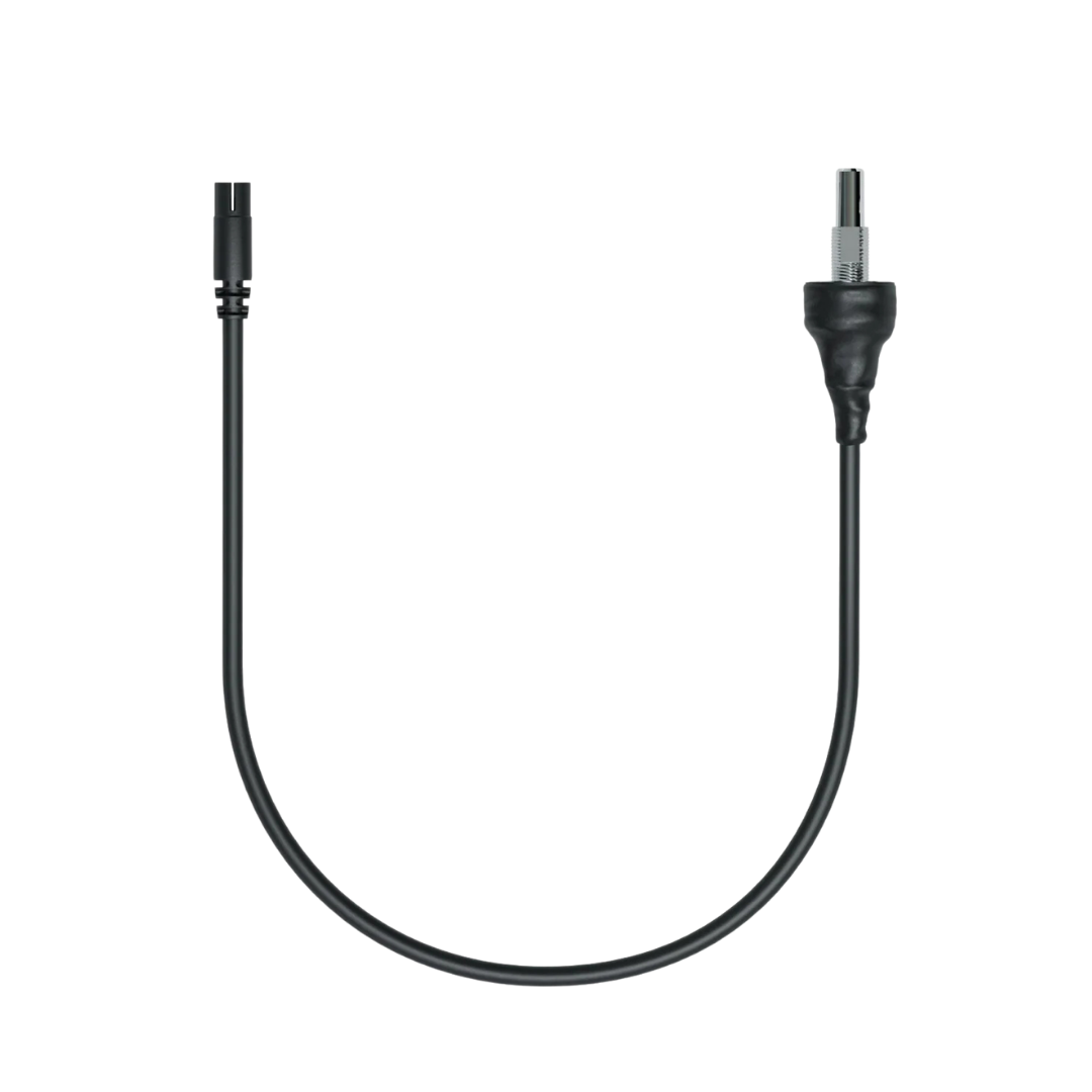

The Kart Steering Angle Sensor is available with or without a 712-719 male to female 4-pin patch lead, which is required to connect the sensor to a MyChron Expansion for the MyChron 5S, 5S 2T, and 4. For the MyChron 6 and 6 2T, the sensor will connect via a 712-712 male to female 4-pin patch lead with the ACC3 719 harness connectors.

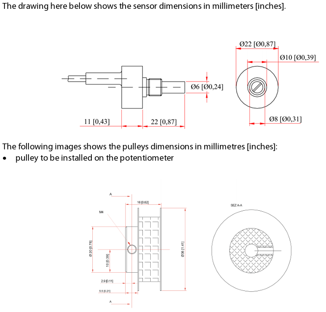

Kart Steering Potentiometer Electrical Characteristics
  • Nominal Resistance: 10kΩ
  • Tolerance on the Resistance Value: ±5%
  • Precision (%): 0.034
Kart Steering Potentiometer Mechanical Characteristics
  • Mechanical Displacement: 270° +/-10°
  • Temperature Working Range: -55/+125°C
  • Dissipated Power at 40°C: 1.6W
  • Dissipated Power at 70°C: 1W
  • 4-pin binder 719 male connector

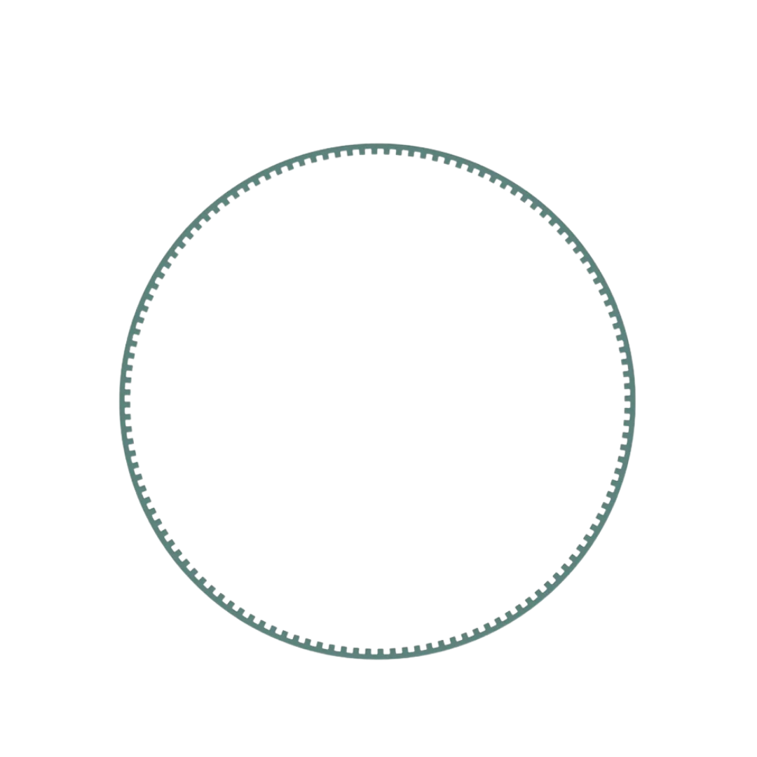

  • Toothed Belt

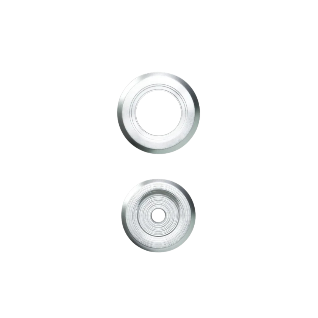

  • x2 Toothed Pulley

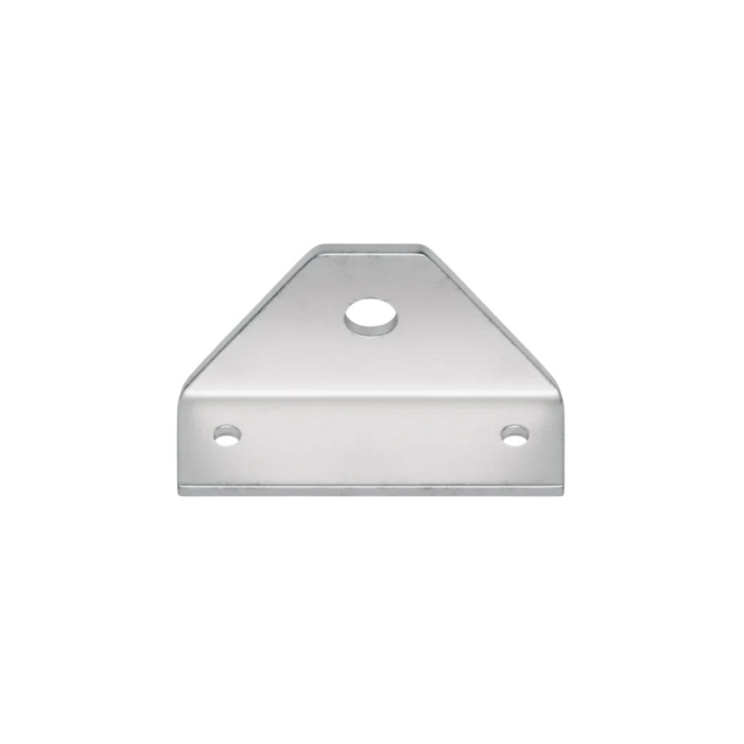

  • Kart Steering Angle Sensor Bracket

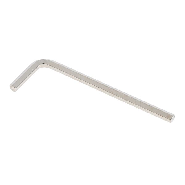

  • Allen Key
