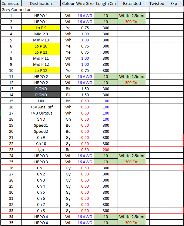

The Aim PDM32 Grey Connection Harness is designed specifically for the Aim PDM32 Power Distribution Module. Each wire is colour-coded and clearly tagged, simplifying installation and eliminating guesswork during setup. With a straight 3 metre length and pre-assigned wires, it ensures an easy, clean, professional installation in your vehicle.
Why Choose the Aim PDM32 Grey Connection Harness
The Aim Grey Connection Harness is built using high-quality professional cables, matching the standard and reliability expected from Aim systems and supports full PDM32 functionality without the need for custom wiring. Ideal if you’re replacing a damaged harness or installing a new setup, this PDM32 Harness gives you perfect compatibility, dependable signal connections, and time saved in wiring.
