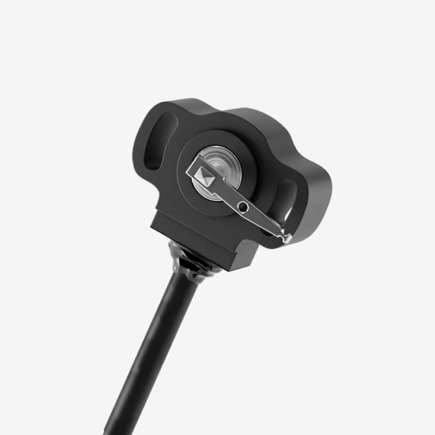

    The sensor measures rotational displacements between a fixed point, a “reference point”, and a movable one.
    Measure rotational displacements 4 pin 719 male connection plug
    24cm cable
    Aim Throttle Rotative Potentiometer
    The first installation step consists of fixing the potentiometer to the chassis using two M3 screws or a self-made iron bracket. Once the sensor mounted on your vehicle, you can connect the rotating cursor to the throttle or the pedal or other moving elements.
    Ensure that the throttle is in its “zero position” (i.e. when the throttle is not pressed), the potentiometer is in its “zero position”, too. When the throttle is thoroughly pressed, the potentiometer is in its “high” position.
    This instrument’s mechanical measure range goes up to 130°, while the electrical measure range goes up to 106°. Please, do not exceed the instrument maximum measure range. If you need to measure more significant displacements, please use a different sensor: incorrect use may seriously damage the sensor.
