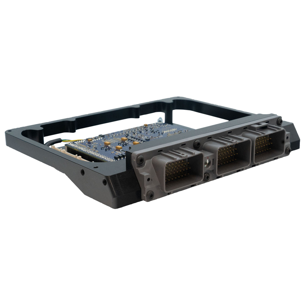

    Designed for the 2JZ non VVTi engine.
    No onboard MAP sensor.
    XS Loom & map sensor highly recommended.
    Suitable Applications:
    Toyota Supra 2JZ non VVTi
    This ECU will support naturally aspirated, parallel twin or single turbo configurations. Does not support sequential control of the stock twin turbos (note: does not fit the case of the NA supra)
    Sequential fuel delivery
    OEM idle hardware supported
    CAN port
    USB tuning cable included
    Staged injection
    Knock with "windowing"
    I/O Expansion Options:
    The Toyota Supra plug-in ECU has two expansion connectors.
    From PCB revision 1.2:
    Expansion Connector 1:
    Gnd Sensor Ground Only
    An Volt 7 Analog 0-5V input
    An Volt 6 Analog 0-5V input
    DI 8 Digital input
    DI 7 Digital input
    Expansion Connector 2
    Aux 9 EThrottle - can't be used as an Aux Out
    DI 9 Digital input
    DI 10 Digital input
    An Volt 8 Analog 0-5V input
    An Volt 9 Analog 0-5V input
    An Volt 10 Analog 0-5V input
