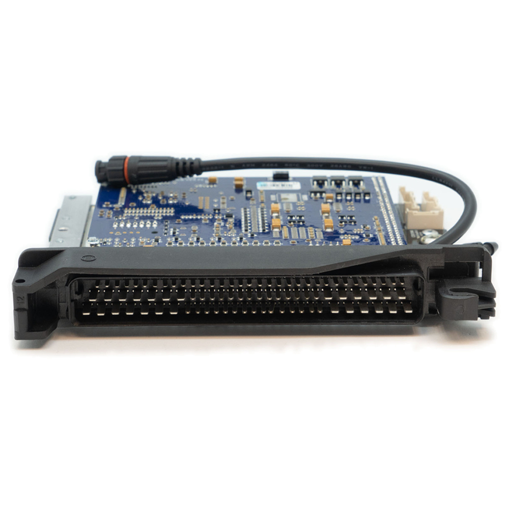

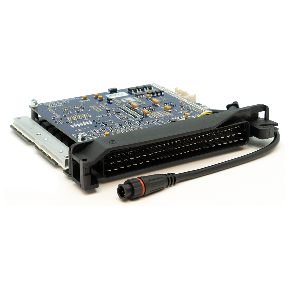

    This ECU is designed for the E36 M50TUB25 engine.
    This ECU only works with the Engine Code M50TUB25 (Bosch ECU from the factory).
    Works with manual & automatic transmissions.
    Built-in 4 Bar MAP sensor or 7 Bar MAP sensor included.
    Suitable Applications:
    M50TUB25 engine with the Bosch M3.3.1 ECU from factory
    Sequential fuel delivery
    OEM idle hardware supported
    CAN port

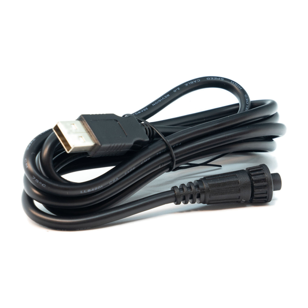

    USB tuning cable included
    Staged injection
    Knock with "windowing"
    Expansion connector - The following expansion connector inputs/outputs are provided:
    TEMP3 Temperature sensor input
    TEMP4 Temperature sensor input
    VOLT4 Analog 0-5V input
    VOLT5 Analog 0-5V input
    DI8 Digital Input
    DI7 Digital Input
    +5V Low Current +5V Supply
    GND Sensor Ground Only
    *Please see the PC Link Help file for details regarding installing the Expansion Cable.
