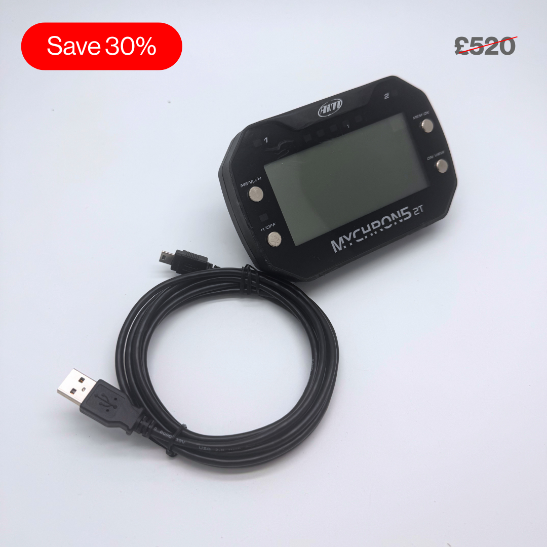

This MyChron 5S 2T is fully equipped and ready to take on its second life. The product is in full working order at a reduced price, and has been meticulously checked by our technicians.
The Aim MyChron 5 2T is our best-selling GPS lap timer with two sensor connections, specifically crafted for karting. Combining 30 years of experience with advanced technology, the MyChron 5 2T offers precise lap timing and advanced data analysis for both amateur and professional racers.
