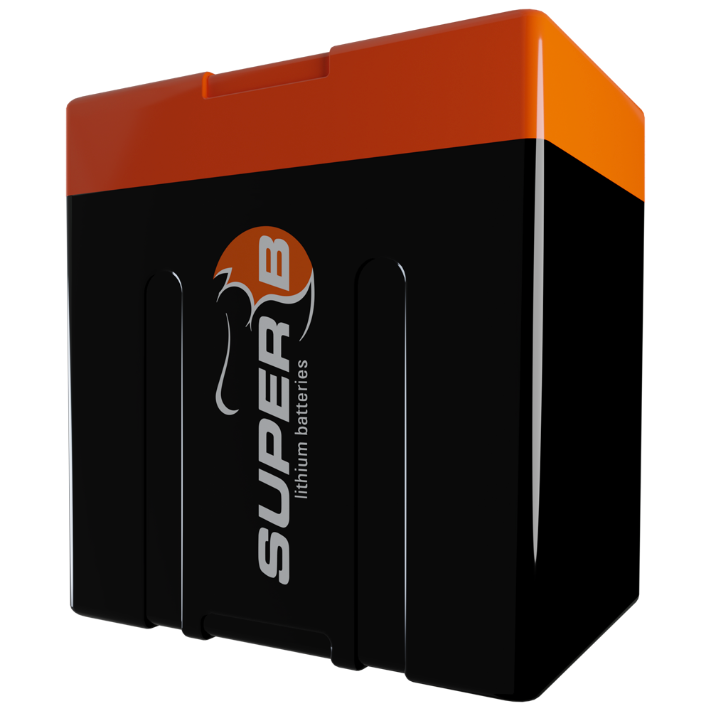

Motorsport Lithium Battery
The Super B Andrena 12V10Ah Lithium Battery is a 12V lithium iron phosphate battery, with a nominal capacity of 10Ah and energy of 128Wh for reliability, high performance and results. This battery is specifically designed for use in motorsport vehicles (cars and motorcycles), ATVs and jet skis.
Why Choose the Super B Andrena 12V10Ah Battery
The Andrena 12V10Ah equals a lead-acid battery of 20 to 32Ah, provided the alternator’s maximum current doesn’t exceed the battery’s maximum charge current of 37A. With high discharge capability, fast-charging and strong construction, combined with the minimal self-discharge rate, the battery life is long-lasting and quick to refill, ensuring that usage of the Super B Andrena 12V10Ah Lithium Battery is maximised. With lithium iron phosphate (LiFePO4) technology, combined with its waterproofness, it is the safest and most reliable battery on the market.
Lightweight Power
With a weight of only 1.7kg / 3.7lbs, the Andrena 12V10Ah power battery saves up to 80% in weight in comparison to traditional lead-acid batteries and is only 1/3 of the size of a conventional battery. This improves not only the performance of your vehicle but also helps to increase the fuel economy.
The power battery offers a high level of power, fast charging and a long, maintenance-free service life. It also has a stable and flat discharge, which means you have over 80% of the batteries capacity available, and you can leave your vehicle unattended for a much longer period compared to a lead-acid battery.

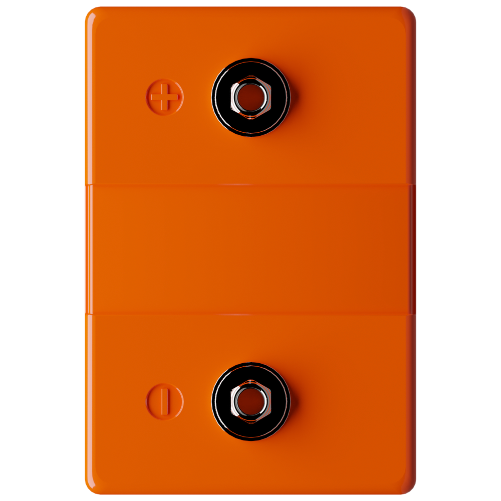

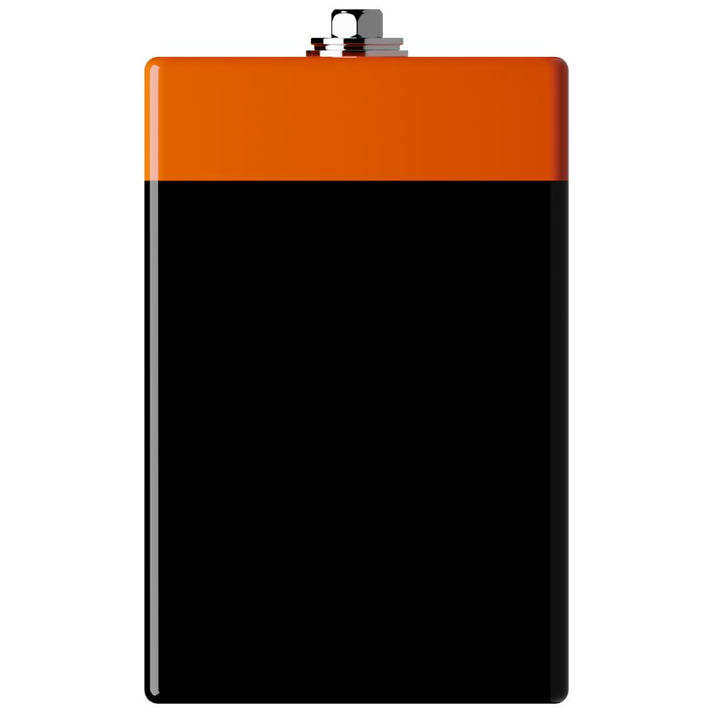

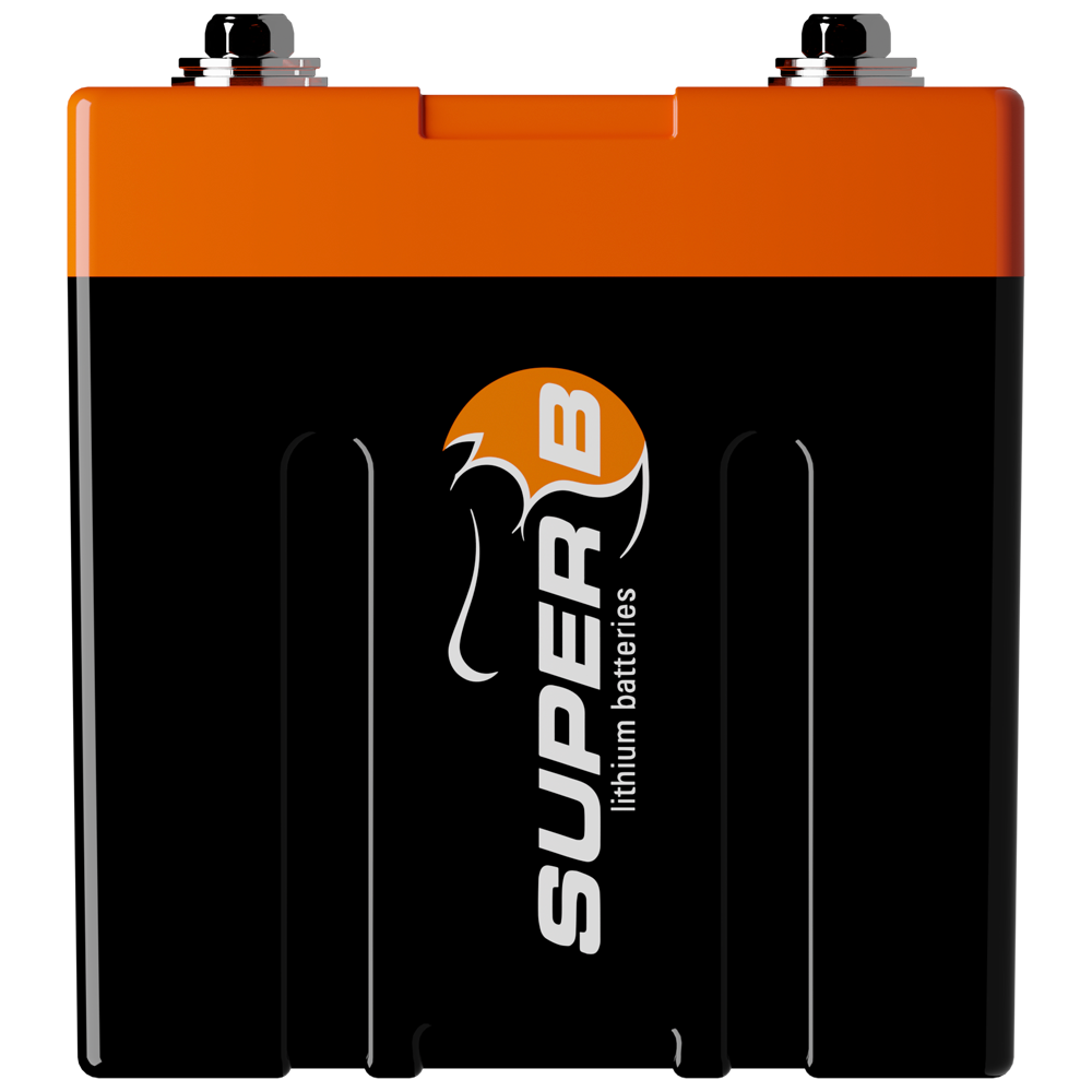

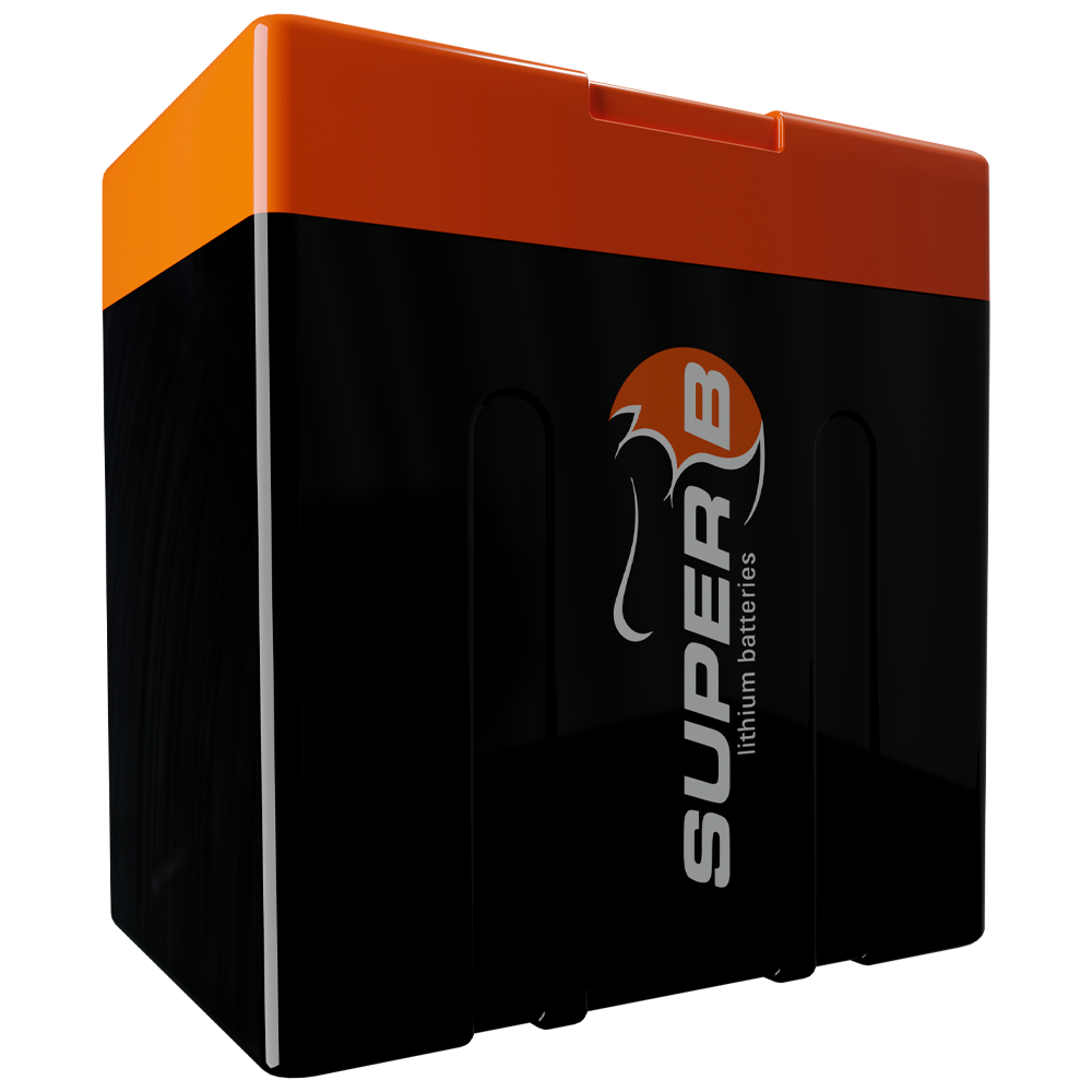

Electrical Specifications
  • Nominal Capacity: 10Ah
  • Energy: 128Wh
  • Nominal Voltage: 12.8V
  • Open Circuit Voltage: 13.2V
  • Cycle life: >1000 (at 10C charge/discharge, 100% DoD)
  • EqPb (Equals lead-acid): 20 - 32Ah
Mechanical Specifications
  • Dimensions (LxWxH): 120 x 82 x 124mm / 4.72” x 3.23” x 4.88”
  • Weight: 1.7kg / 3.7lbs
  • Case Material: PC - ABS
  • Ingress Protection: IP69
  • EAN-13: 8718531360037
  • Battery Designation: 4IFpR27/66-4
  • Charge Method: CCCV
  • Max Charge Current: 37A
  • Discharge Current Continuous: 160A
  • Discharge Pulse Current (1 sec): 493A (49C)
