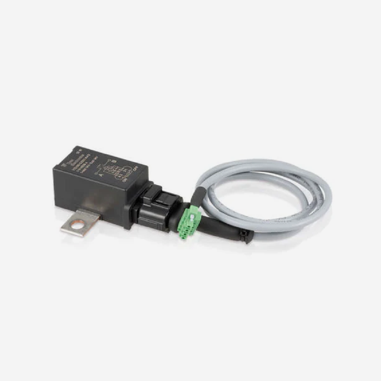

The Super B Nomia Bistable Relay is rated up to 260A (12VDC) and is designed to work with single Super B Nomia Lithium Batteries, offering high-performance switching for demanding applications. Capable of high-peak currents, this Bistable Relay allows you to remotely control your battery circuit with precision, reducing manual intervention and improving system reliability in motorsport, marine or mobile energy installations.
Why Choose the Super B Nomia Bistable Relay
The Super B Nomia Bistable Relay provides an electrically controlled and resettable ON / OFF switch control to protect, manage and optimise your lithium battery setup. It uses a bistable mechanism (which holds state without continuous coil power), drawing minimal standby current. It can switch high-current loads when required, with peak current capacity up to 1500A.
Designed specifically for use with the Super B Nomia range (12V100Ah, 12V160Ah, 12V210Ah), the Bistable Relay ensures your battery system can be controlled efficiently and safely. With the included 1m cable, installation is straightforward and suited to high-demand situations where high switch capacity and reliability are essential. Continuous current is limited to 190A at 85°C / 185°F.

  • Rated voltage: 12VDC
  • Maximum switching voltage: 16VDC
  • Limiting continuous current (1) - load current from terminal B (+) to A (-):
    - 23°C, load cable 50mm (2): 260A
    - 85°C, load cable 50mm (2): 190A
    - 125°C, load cable 50mm (2): 88A
  • Limiting making current:
    - Resistive load, cable 50mm (2): 23°C
    - Ton/toff=0.5s/10min: 1500A, >5 ops. (1)
  • Limiting breaking current:
  • Limiting short-time current:
    - Overload current at 23°C, cable 50mm (2)
    - 1000A,1s - 0A, 9s: 50x10 (3) ops. (2)
  • Contact material: Silver alloy
  • Contact style: Bridge contact
  • Initial voltage drop: At 100A<40mV post 1min
  • Operate/release time: 5ms at 14VDC (coil voltage)
  • Mechanical endurance: >1.5x105 ops.
Initial Dielectric Strength
  • Between open contacts: 500Vms
  • Between contact and coil: 500Vms
Other Data
  • EU RoHS/ELV compliance: Compliant
  • Protection to heat and fire: UL94-HB or better (3)
  • Ambient temperature: -40 to +125°C
  • Degree of protection:
    - IEC 60529: IP54
  • Vibration resistance (functional):
    - ISO 16750-3 (2007-08): 22 to 500Hz, >10g (4)
    - Test IV: No change of switching state >10µs
  • Shock resistance (functional):
    - IEC 60068-2-27 (1995-03): min. 40g 11ms (4)
    - Half sine: No change of switching state >10µs
  • Terminal type: Connector and screw
  • Weight: Approx. 210g (7.4oz)
  • Packaging unit and delivery (5): 24 pcs
  • 1m cable
  • V23130C
1) Important: Please pay attention to load current direction.
2) Values are influenced by system temperature and load current. For further details, please consult TE relay application engineers.
3) Refers to used materials.
4) Valid for NC contacts, NO contact values significantly higher.
5) Bistable relays are delivered in the reset position (open contacts). Due to mechanical impacts during transportation, we advise checking the contact status on receipt.
Latching (delivery status “ex works”).
