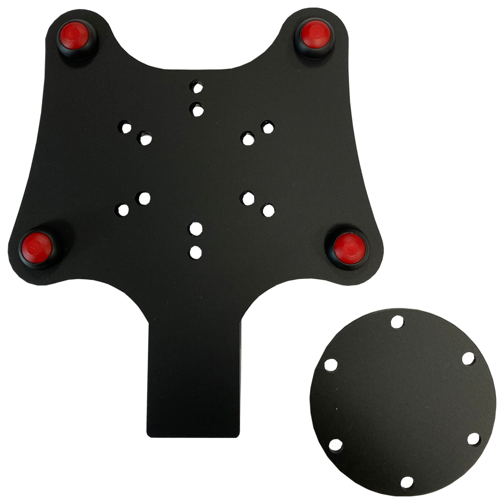

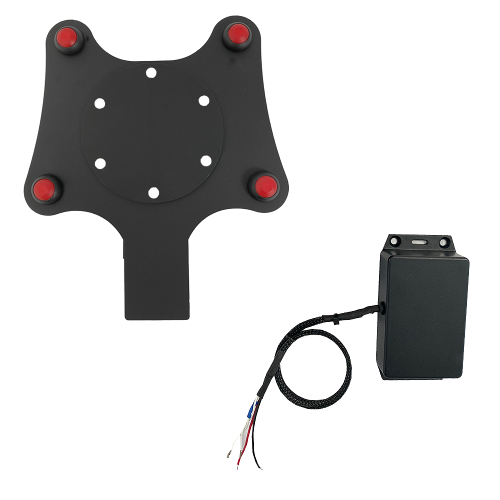

    Racing faster, harder and safer with the Motorsport steering wheel plate, with push-button controls at your fingertips, combining minimum driver distraction with maximum ease of use for every track day.
    CAN wireless system CR2 lithium battery
    4 momentary pushbuttons 3-year guarantee
    Bolt between the wheel & boss
    4 Button Wireless Steering Wheel Plate
    The four-channel wireless system allows you to have push-button controls at your fingertips whether you have a detachable steering wheel or would like to avoid the need for an unreliable coiled wire connection from your steering wheel to the dashboard.
    The system uses a wireless (RF) connection between the wheel plate transmitter and the CAN receiver. The compact receiver is neatly installed behind your dashboard and attached to an AiM CAN device directly using the binder harness.

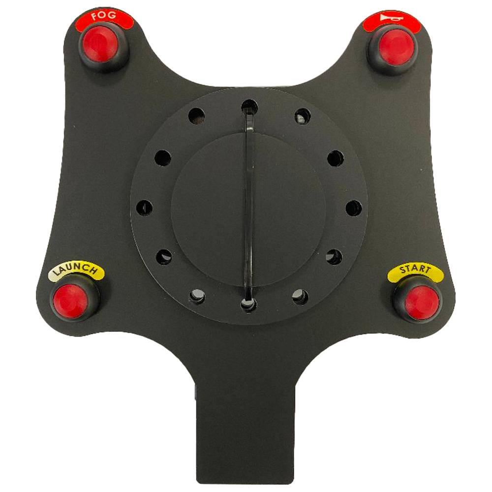

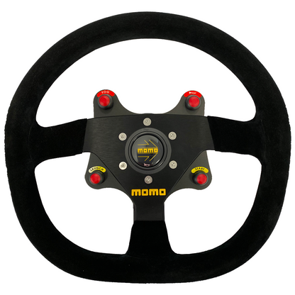

    Upgrade your wheel plate with adhesive stickers. Pre-cut and hard-wearing, and professionally printed. They are easy to apply and add a professional finish to your wheel plate. See accessories tab.
    Please Note: Images showing the steering wheel are for illusion purposes only. The steering wheel is not included. The stickers are also for visual display to show how the wheel plate could look.
    Please see the accessories tab to purchase stickers.
    4 Momentary Pushbuttons
    Wirelessly implemented, the in-vehicle commands in a fraction of the time with four digital push-buttons, ideal for features such as lights, horn or engine start.
    The steering wheel plate is lightweight and integrates with most CAN devices, including dashboards, ECUs, PDUs and dataloggers and has been tested to withstand the harshest EMI that can be generated within your car.
    Battery Life
    The four-channel wireless wheel plate has a standard CR2 lithium battery with a guaranteed life of 3 years or 50,000 miles. You don't have to worry about the battery going flat.
    The battery voltage is regularly transmitted to the CAN receiver with the intelligent system and then forwarded to the AiM device that gives you around 30 days notice if the battery needs to be replaced.
    Using our PDM systems and Race Studio 3 software will allow you complete control and behaviour of the momentary push-buttons to act as simple latching switches or more complex management.
    With Race Studio 3, you can also analyse all data recorded and downloaded to your PC: graphs, histograms and tables will help you study your performance, providing an objective support to avoid mistakes and improve performances.
    • Button plate front: Matte black, Textured acrylic
    • 176 x 154mm
    • Battery housing: ABS-UL94-VO
    • 54 X 38 X 23mm external
    • CR2 lithium battery
    • 50,000 miles active use
    • Pushbuttons: IP67
    • Assembly: 4 channel 220g

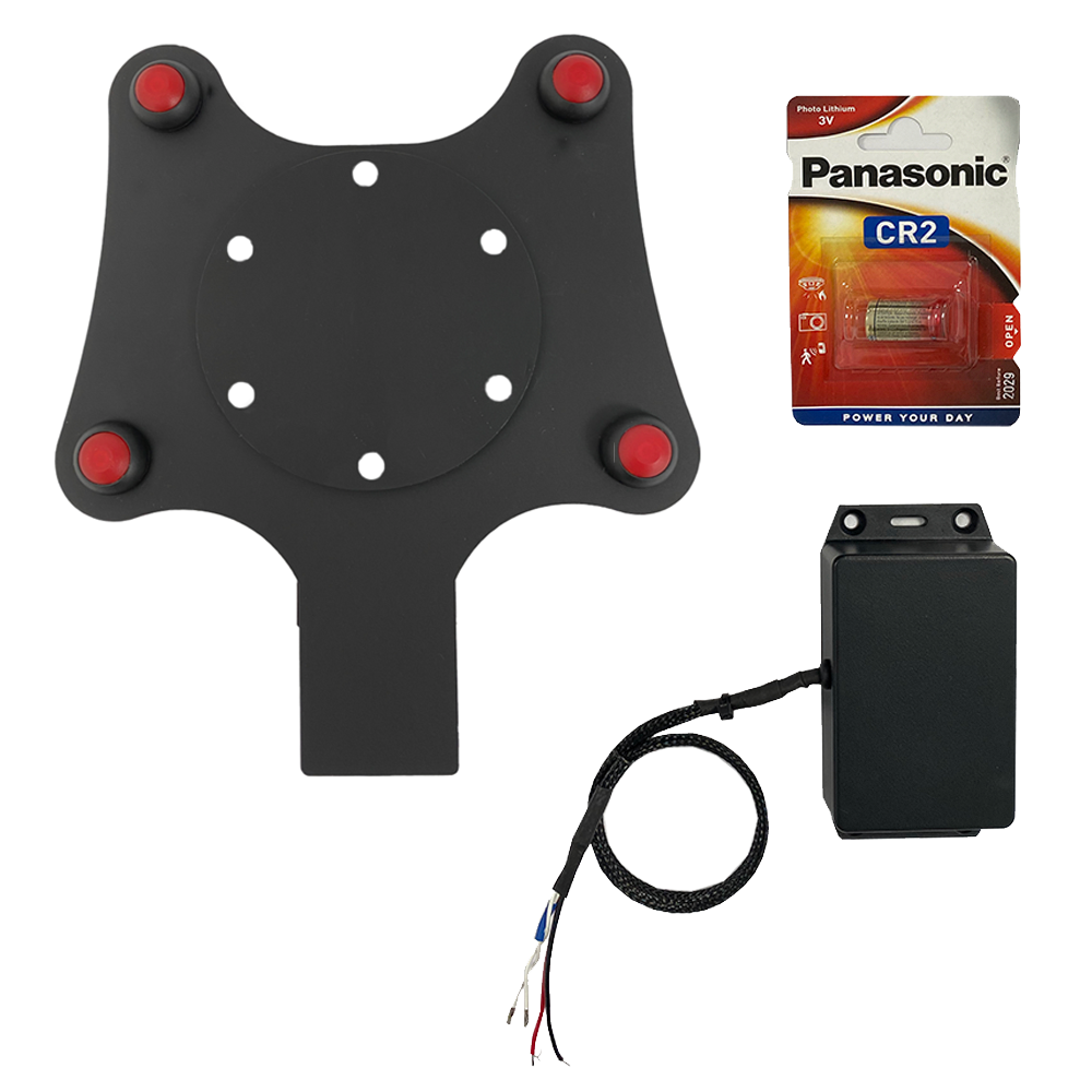

    • Four channel wireless wheel plate
    • Connection harness
    • AiM sticker
