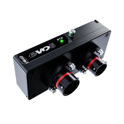

Take your data acquisition to the next level with the brand-new Aim EVO6 Data Logger, a professional-grade system built for racers. Absolute precision and total control. Designed for high-performance motorsport applications, the EVO6 delivers advanced data logging, integrated GPS, and inertial tracking in one compact, rugged unit. This isn’t just data; it’s your competitive edge captured in real time.
Why Choose the EVO6 Racing Data Logger
The EVO6 Racing Data Logger is engineered for flexibility and scalability, making it the perfect core of any modern data system. Whether paired with displays, power distribution modules, or additional sensors, the EVO6 integrates seamlessly into your setup. Its ability to synchronise GPS, IMU and vehicle data ensures you get a complete, accurate picture of every lap—helping you analyse performance with confidence and make smarter decisions on track.
If you’re serious about extracting every ounce of performance, the Aim EVO6 Data Logger is the upgrade that puts you ahead. More data, more control, more speed.
EVO6 Features
The EVO6 features 8 fully configurable analogue inputs compatible with a wide range of sensors, including temperature, pressure, and more, along with 4 speed inputs and coil RPM acquisition for precise monitoring of vehicle speed and engine performance. An integrated 25Hz GPS module delivers highly accurate lap timing and track positioning, while the 100Hz 3-axis IMU (±5G) captures acceleration, braking, and cornering forces in detail for deeper insight into vehicle dynamics and driver input.

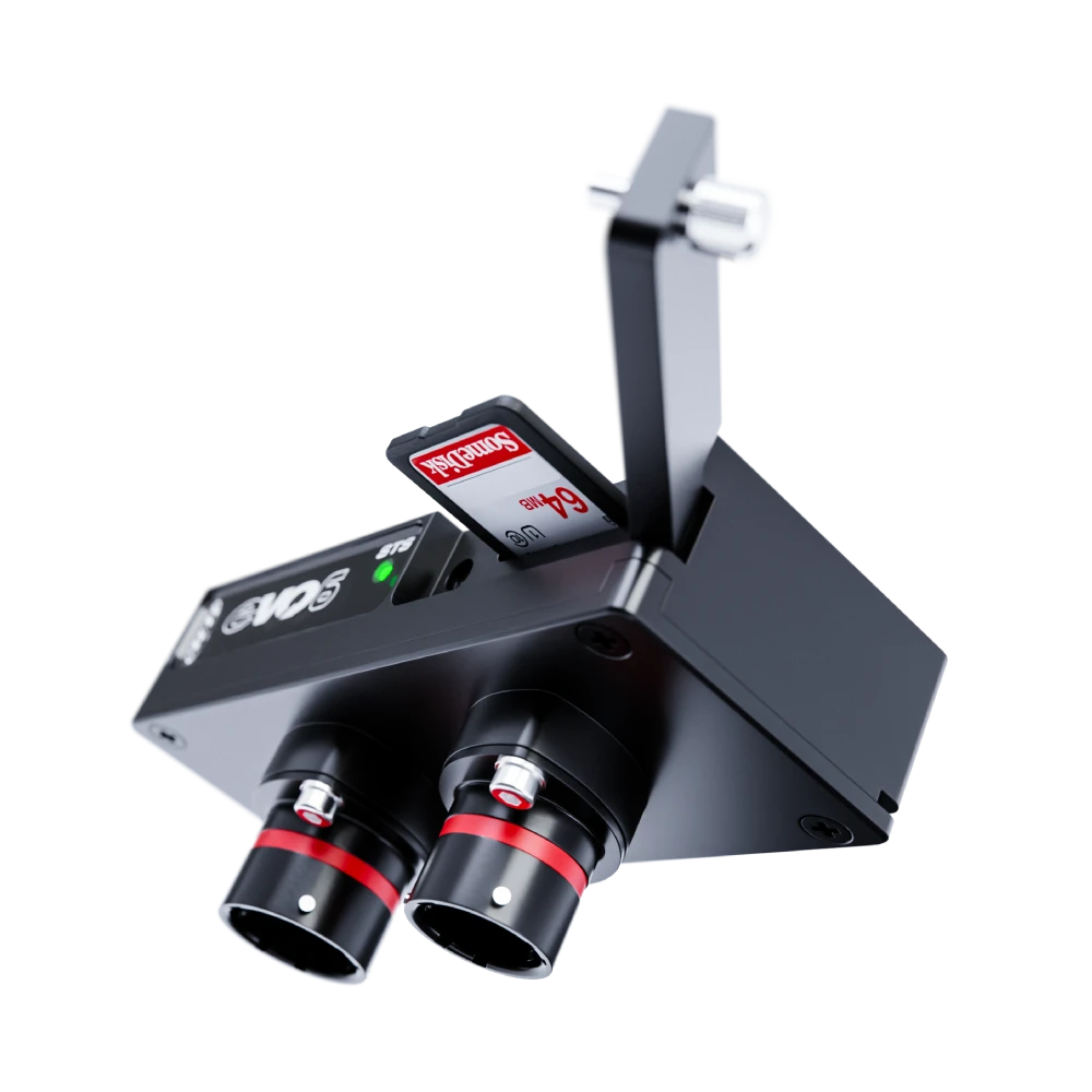

Built-in Wi-Fi and Bluetooth enable fast, cable-free configuration and data download, while expandable SD card storage of up to 128GB allows longer recording sessions without compromise. All of this is housed within a compact anodised aluminium enclosure designed to withstand the demands of extreme racing environments.

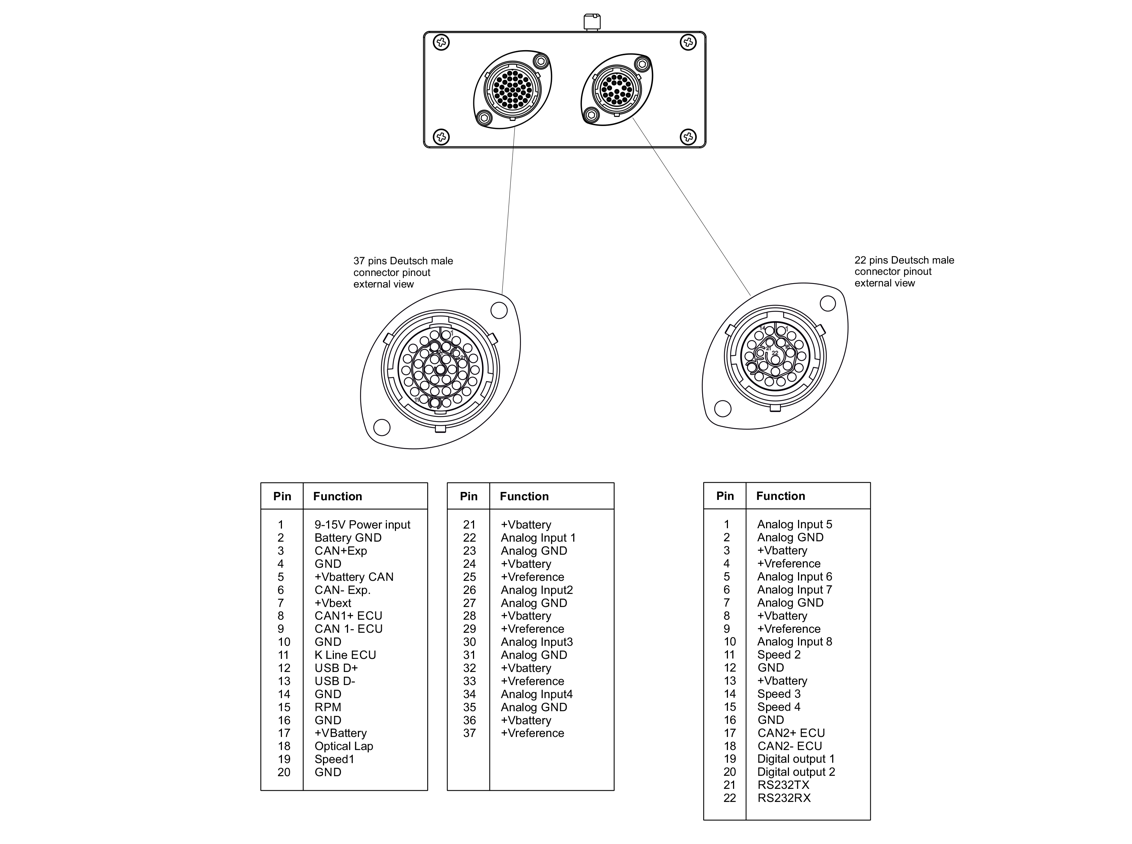

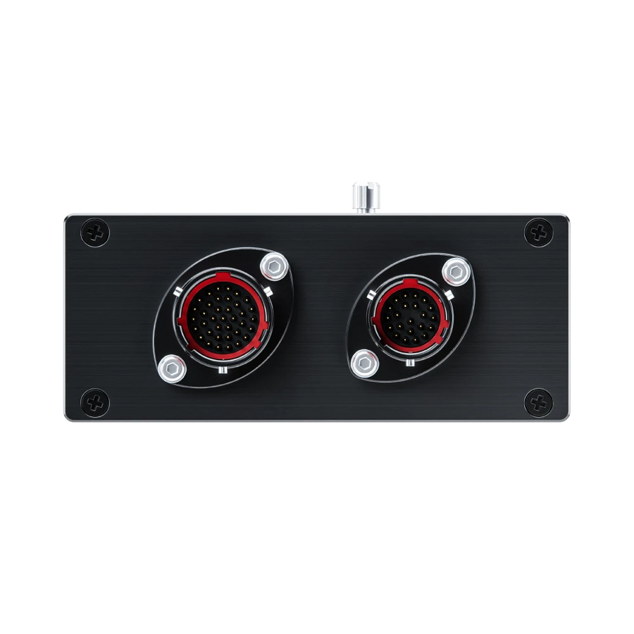

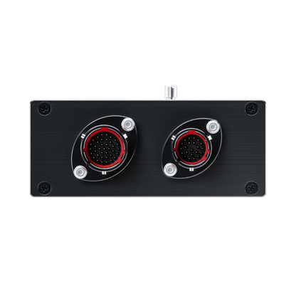

The EVO6 features two multi-channel motorsport connectors designed for simple and reliable installation. A high-quality wiring harness manages all connections through a 37-pin connector for main functions such as power, CAN, and the Aim CAN network, along with a 22-pin connector dedicated to additional functions, including CAN2, digital outputs, and more.

- 8 analogue channels with configurable inputs or thermocouple inputs, with a max frequency of 1,000Hz each, used to sample data coming from temperature, pressure, suspension and other sensors.
- 4 speed inputs, which allow you to monitor the different wheels' behaviours.
- 1 RPM input, which manages square wave signals transmitted by the ECU, or pulse signals picked from the coil command (low voltage).
