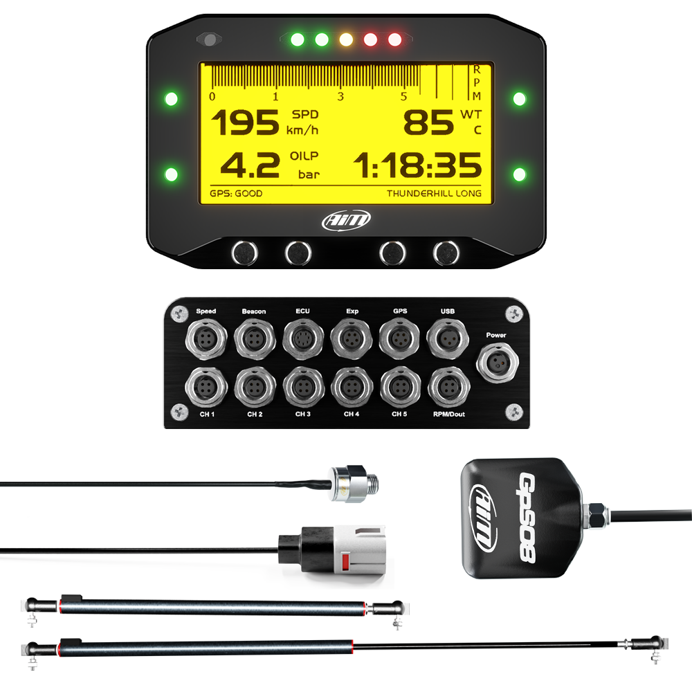

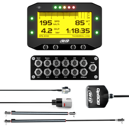

    The Ultimate GS-Dash & EVO4S Motorcycle Data Logging Kit
    We have put together the ultimate motorcycle data logging kit to help improve your racing performance.
    GS-Dash with LCD screen
    7 configurable RGB colours
    5 configurable RGB LED shift lights
    4 configurable RGB alarm LEDs
    5 pin 712 male spiral cable
    Many options for ECU connection
    Built-in accelerometer & gyro sensor
    5 fully configurable analogue channels
    EVO4S Data Logger
    CAN output
    2-speed inputs
    75mm & 150mm potentiometers
    Two 712-719 patch leads
    Brake pressure sensor M10-0-100 bar
    One 712-719 patch lead
    GPS module 1.3m

    Motorcycle GS-Dash
    The Aim GS-Dash is a compact, flexible and fully configurable graphical display showing data sampled by our EVO4S.
    This dash is small in dimension, which makes it particularly suitable for motorbikes. It features a five-pin binder 712 male spiral cable, which will enable you to connect your EVO4S with minimum effort.
    The GS-Dash can be backlit in one of seven available colours. It also features an ambient light sensor that makes brightness and contrast ideal in all light conditions.
    The GS-Dash is compact in structure and features a 268x128 pixel display to maximise readability.

    EVO4S Data Logger
    The Aim EVO4S is a powerful and flexible data logger equipped with a 1.3m GPS Module. Offering one connector per channel, the EVO4S samples all the information you need, data coming from your bike ECU via the specific bike cable you have selected, from the internal accelerometers and gyro and the GPS Module included in the kit.

    Suspension Potentiometer With Pop End Fitting
    The Aim suspension sensor (linear potentiometer) is a type of position sensor. They are used to measure displacement along a single axis, either up and down or right & left, and suitable linear potentiometers are a contacting type of sensor which means that the moving parts contact each other during use.
    Please Note: This kit comes with 2 potentiometers, a 75mm and 150mm; both also come with a 712-719 1 meter patch lead.
    Brake Pressure Sensor M10 0-100 Bar
    The Aim M10 - 0-100 Bar brake pressure sensors have a male four pins black 719 binder plug connections to suit all Aim loggers and dash display/loggers. Whether your bike is equipped with single, dual, fixed or adjustable master cylinders, adding brake pressure sensors allows you to monitor brake performance, make fundamental changes and identify issues quickly and precisely.
    Please Note: This kit comes with an M10 0-100 bar brake pressure sensor and a 712-719 1 meter patch lead.
    GPS Module
    The Aim GPS technology marks a true revolution in data acquisition, offering immediate access to lap times and all the critical data needed to refine your driving performance and technique. The included GPS09 Module connects easily via a CAN cable for fast installation and ensures outstanding precision and reliability by working with nearly twenty satellites.
    With an average positional tolerance of less than one meter, the system can accurately detect the start/finish line, even when the finish line is close to another track segment. The module locks onto satellite signals rapidly, becoming fully operational as soon as it's powered on, and is resistant to signal loss from noise or interference.
    Paired with GPS Manager software, you can track start/finish lines and split points, and access a comprehensive track database. The system also delivers essential insights such as chassis analysis, real time track position, speed, cornering forces (both in-line and lateral G), and automatic lap timing—everything you need to push your performance to the next level.
    Please Note: This kit comes with a 1.3 meter GPS Module.

    Aim GS-Dash & EVO4S Motorcycle Data Logging Kit
    • GS-Dash:
    • Display Resolution: 268 x 128 pixels
    • Ambient light sensor: Yes
    • Shift lights: 5 configurable RGB LEDs
    • Display pages: Fully configurable
    • Body: Aluminium
    • Pushbuttons: Metallic
    • Dimensions: 127.8 x 82 x 22.2mm
    • Weight: 380g
    • Waterproof: IP65
    • EVO4S Data Logger:
    • ECU connection: CAN, RS232 or K-Line to 1,000 industry leading ECUs
    • External modules: GPS Module, Channel Expansion, TC Hub, Lambda Controller, SmartyCam HD
    • Anologue inputs: 5 fully configurable, max 1,000 Hz each
    • Digital inputs: 1 (1 Amp max)
    • Internal platform: Internal 3 axis ±5G accelerometer + 3 axis gyro
    • Internal memory: 4 GB
    • Connectors: 13 Binder connectors
    • Body: Anodised Aluminium
    • LEDs: 1 system status
    • Dimensions: 130 x 35 x 46.6mm
    • Weight: 330g
    • Waterproof: IP65
    • GPS Module:
    • Weight: 60.5g
    • Brake Pressure Sensor M10 0-100 Bar:
    • Supply: 8-16V
    • Accuracy:  < +/- 0.5% FS (CLNH – combined non-linearity and hysteresis)
    • Output signal: From 0.5V to 4.5V
    • Characterisation: 500mV/ O bar 4500mV/ 100 bar
    • Sealing: IP66
    • Weight: 30g
    • Cable length: 400mm
    • Thread: M10
    • For all other technical information, please refer to the Technical Sheets in the Download Tab.
    What's In The Box
    • EVO4S Data Logger
    • GPS09 Module 1.3m
    • GS-Dash
    • Potentiomter 75mm & 150mm
    • Brake Pressure Sesnor M10 0-100 Bar
    • 3 x 712-719 Patch Leads
