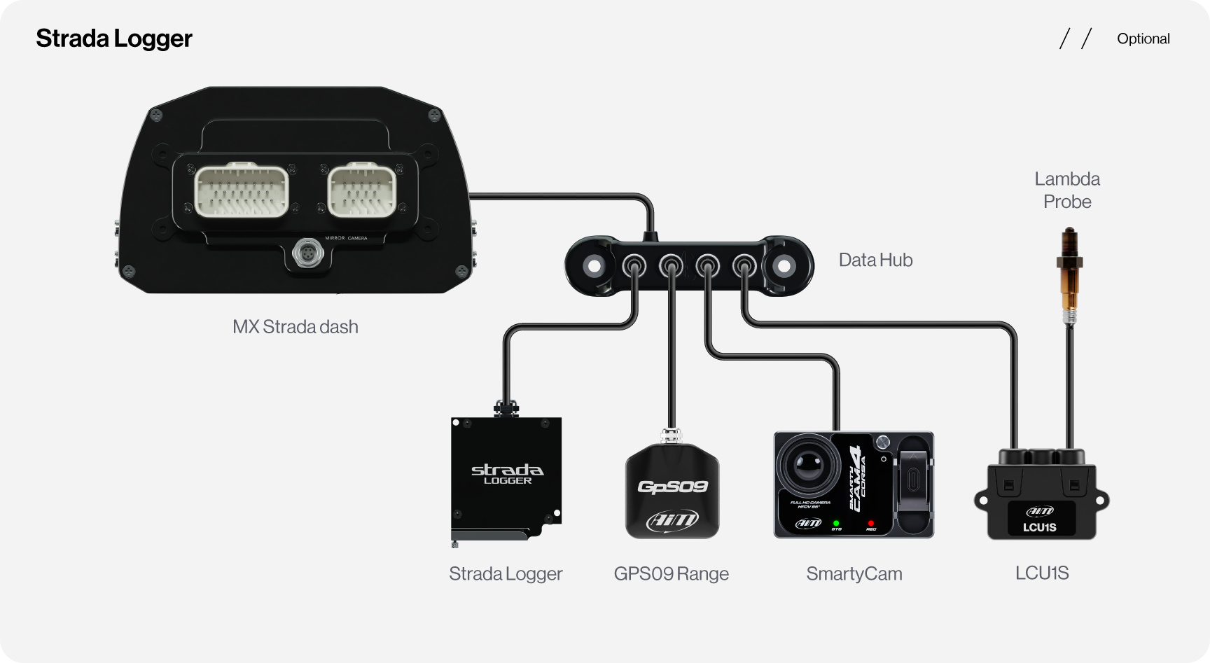

How do you set up the Aim MX Strada Logger Kit?
To set up the Aim MX Strada Logger Kit, you first need to mount the MX Strada Display in your vehicle. You can then connect the Data Hub to the 5-pin CAN/expansion port on the dash harness. This allows you to connect to multiple Aim devices all at once. Then mount the GPS09 Module on the dash or roof, and connect it and the Strada Logger directly to one of the Data Hubs CAN ports.
If you have other products, outside of what is included inside the Strada Logger Kit, connect these directly to the Data Hub. After this, wire the system to a switched 12V supply and ground, and connect to your vehicle's ECU using CAN, RS232, or K-Line, depending on your vehicle.

What can be connected to the Aim Data Hub CAN Connection Multiplier?
Data Hubs communicate with Aim loggers using the Aim CAN network (5-pin 712 binder connector) and are needed to mutually connect more expansions, but are not needed to connect the sensors to Aim loggers. Supported expansions include:
  • Other Data Hubs
  • GPS Module
  • Lambda Controller
  • SmartyCam
  • ACC3
  • Loggers
