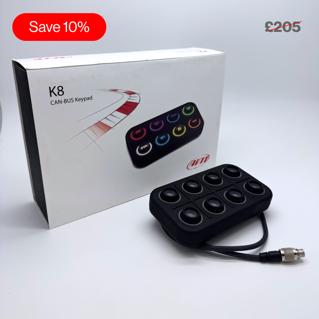

Advanced CAN Keypad
The Aim CAN Expansion Keypads are based on CAN-Bus protocol. The devices are water and dust-resistant and can be installed both inside and outside the cockpit. They are fully customisable and proposed with a wide range of interchangeable inserts. The CAN Expansion Keypad enables you to have your very own selected buttons at your fingertips. Available in 6, 8 and 15-key keypads.
Please Note: The keypads come blank with no inserts, of which we have an extensive range available.
The push buttons can be configured to indicate status:
- Momentary: The push button status is on when the push button is pushed.
- Toggle: The push button status changes from on to off every time the push button is pushed.
- Multi-status: The push button value changes from 0 to a max value every time the push button is pushed.
RGB LEDs
Every push button can be illuminated in 1 of 8 different colours, solid or blinking, according to the configuration defined by the user.
Expansion Features
Aim CAN Expansion Keypad can be connected to the Aim master devices such as dashes, dash loggers and PDMs, and they can be freely configurable as an expansion using our free Race Studio 3 performance analysis software.
Additional Controls
In addition to the primary functionality of the buttons, Aim CAN Expansion Keypad buttons can be set up for managing any Aim display connected to the devices.
Interchangeable Inserts
Explore endless possibilities with our wide range of laser-etched inserts to personalise your keypad – whether it's for lights, heating, fans, parking, and more. You can set these buttons to react based on parameters set by you; momentary, latching and toggle modes.
