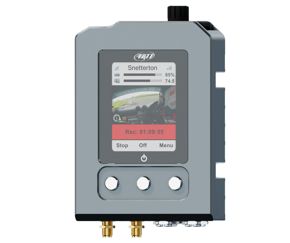

SmartyCam 3 GP features a video output with SD interface. It allows you to send the video/audio directly to wherever you choose, for example your pit crew, at 30 or 60fps.
With the built-in data logger experience enhanced RPM, throttle, engaged gears, acceleration, temperatures, and pressures including a tri-axis accelerometer measuring 16G.
The SmartyCam 3 GP provides you with a CAN expansion that connects with many Aim devices such as the Solo 2 DL Laptimer, various Aim Dash Display Loggers, and PDM Dash systems. This is a standard practice within our products, however we have also equipped the SmartyCam 3 GP with unterminated CAN connections which allow you to connect the camera to any system as a standalone feature. No matter your vehicle and equipment, with the unterminated connectors you can run the GP through your CAN/ECU connections.
The SmartyCam 3 GP includes a global shutter CMOS sensor and a low distortion lens with a field of view of 67°, 84° or 120° covering all areas, its lightweight 200g (battery included) framework infallible in providing you with smooth and effortless footage.
The SmartyCam 3 GP contains a rechargeable lithium battery confined inside its (main) 120.8x80.2x30.9mm (bullet) 24diamx48.2mm body, and using its connectors - 2 Binder 712 female connectors + 2 SMA female connectors (see pinout page) + 1 USB-C - slots right into the back of your dashboard.
Finished with a sleek anodised aluminium coat, the SmartyCam 3 GP is assured to add efficiency, informational data, productivity, and style to your racing. AiM SmartyCam 3 GP has the ability to mount onto many aspects of your vehicle for easier accessibility. Here at AiM, we provide only the best innovations and are constantly and consistently working to better your racing experience.
Generic HD cameras focus too much on pixel numbers resulting in large file sizes. The SmartyCam 3 footage has the same quality as other FHD cameras with smaller files due to H.264 compression system parameters being optimised to a perfect balance between video quality and file size. Choose between three file quality levels: O recording = 4GB (High Quality), 2GB (Normal Quality) or 1.5GB (Lower quality).

  • Video format: H.264 1920x1080 pixels @ 60 FPS
  • Display resolution: 2.4" 240 x 320 pixels
  • Lens: Low distortion camera lens
  • CMOS sensor: Global Shutter
  • Field of view: 67°, 84° or 120°
  • Internal battery: Rechargeable lithium battery
  • Video Out: 3G-SDI
  • External power: 9-15 Volt
  • Supports SD card: Up to 2 TB
  • Connectors: 2 Binder 712 female connectors + 2 SMA female connector (see pinout page) + 1 USB-C
  • Usage temperatures: -10°C/+50°C
  • Auto Power ON: Yes
  • Auto Power OFF: Yes
  • Auto Start/Stop Recording: Yes
  • Body: Anodised Aluminium
  • Dimensions: Main unit 120.8 x 80.2 x 30.9 mm | Bullet camera 24 diam x 46.0 mm (120° lens) | Bullet camera 24 diam x 41.0 mm (67°-84° lens
  • Bullet Cable Length: From 0.5 m to 4 m (7 lengths available)
  • Weight: Main Body - 320g, Bullet Camera - 45g
  • Waterproof: IP65
