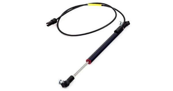

The Suspension Potentiometer is required to measure the displacement between two points using a sensor (the linear potentiometer) directly connected to the points of measure.
Why Choose the Aim Suspension Potentiometer
The Suspension Potentiometer suits all Aim loggers and dashes display loggers, and we offer a range of sizes for the potentiometer: 50mm, 75mm, 100mm, 150mm.
This potentiometer can be used to measure linear displacements like:
  • Suspensions and spring cushions compression or extension.
  • Steering column rotation is measured through the rack displacement.
  • Shock and suspension travel.
  • Ride height.
  • Wing or spoiler deflection at speed.
As a simple guide, most bikes use 150mm on the front fork, 75mm on the rear shock and 50mm on the steering damper. Most cars use 100mm on both the front and rear suspension.
