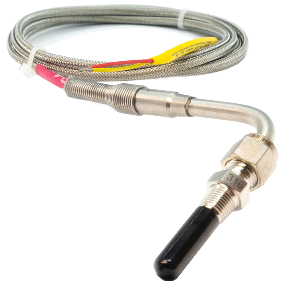

    Link Exhaust Gas Temperature Probe
    Extreme Duty Fast Response EGT Temperature Probe
    Type K thermocouple probe
    Exposed sensing junction for fastest response
    Includes 316 SS adjustable compression fitting
    Stainless steel protected wires
    Designed for extreme engine test & racing environments
    When using this with an ECU other than the Thunder, you will need to use an amplifier.
    Thermocouple type: K
    Range: -148 to 2372°F (-100 to 1300°C)
    Accuracy: +/-0.4% of reading or about +/- 1.1°C (Special Limits of Error)
    Probe diameter: 1/4 inch (0.250 inch) (6.35 mm)
    Sensing Junction: Exposed, Ungrounded
    Response Time*: 150 mS
    *Time Constant: Defined as the time required to reach 63.2% of an instantaneous temperature change
    Five time constants are required to approach 100% of the step change value
    Outer Sheath Material: Inconel, melting point 2550°F (1400°C)
    Cable: Stainless steel overbraiding over Teflon™ insulated, stranded wires, 20 gauge
    Compression Fitting: 316 stainless steel, adjustable, 1/8 inch –27 NPT male thread
    Wiring: + = Yellow – = Red
