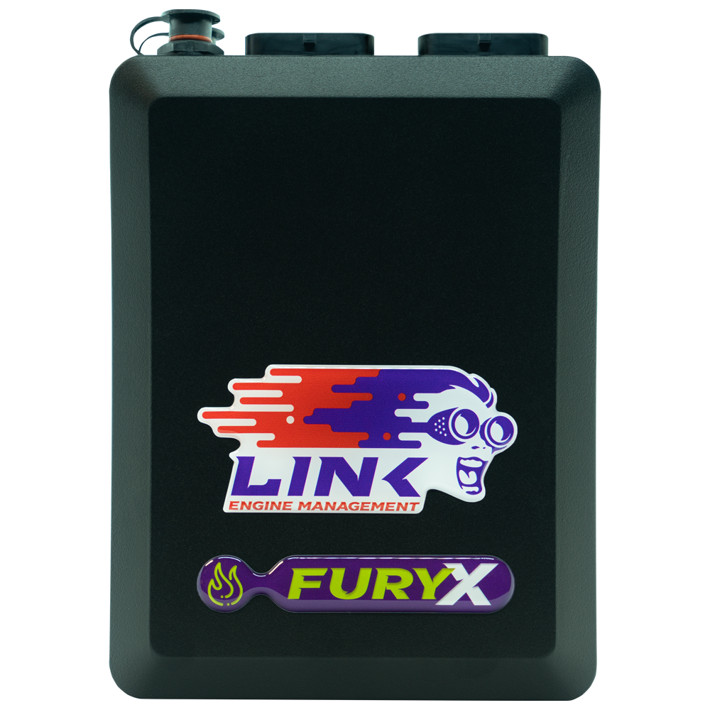

    The FuryX is a premium ECU like the XtremeX, but with added Onboard Digital Wideband Lambda Control. Now on the G4X platform, the FuryX features a faster processor, faster communications & a huge 512 megabytes of data logging.
    With 8 injector drives and 6 ignition drives, the FuryX can control up to 3 rotors or 6 cylinders with sequential injection and direct spark, making it an excellent choice for professional-level motorsport or more demanding road car applications.
    The added benefit of an Onboard Digital Wideband Lambda Controller means higher accuracy of the unit, plus a simple setup.
    The FuryX comes supplied with stickers, a quick start guide, a mounting bracket and a USB tuning cable.
    * Requires 'A' & 'B' Looms or 'A' & 'B' Pin Kits, not supplied.
    If you are after more inputs, outputs or features, consider the Thunder ECU.
