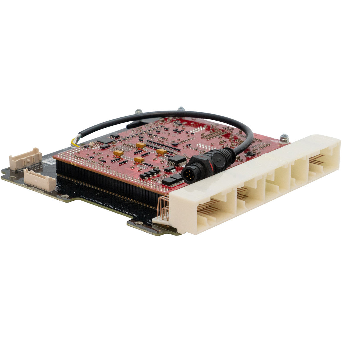

    Easy to install. Affordable. Reliable.
    G4X PlugIn ECUs offer the latest in engine management technology, designed to easily maximise the potential of your car.
    This ECU fits inside the factory OEM enclosure. Installation is a breeze, with no alteration of the factory wiring loom required for the models listed below.
    Designed for the K20A engine.
    • Please check that your connector matches the header in the listed photo before purchasing.
    • This ECU works for manual transmissions only.
    • ECU includes an onboard 7 bar MAP sensor.
    • Most factory features are supported.
    • Check the features tab for I/O expansion options
    Note: This Plug-in features a new 4 pin powered CAN connector and cannot use the old CANPCB cable for CAN connection.  Use the CANJST4 (Code 101-0198) cable for connecting CAN devices.  This new 4 pin port and cable provide not only the CAN connection, but also a protected 12V power supply and ground for powering the CAN devices.  The power supply is protected by a self-resetting fuse rated at 3A continuous.
    Suitable applications (Manual Transmission only):
    Honda Integra Type R DC5 2002-2004 with K20A/K20A2/K20A3 Engine
    Acura RSX 2002-2004 with K20A/K20A2/K20A3 Engine
    Honda Civic Type R EP3 2001-2005 with K20A Engine
    Honda Civic Si/SiR 2001-2005 with K20A3
    Honda Civic DX/LX/HX 2001-2005 with D17A1/A2/A3 Engine
    Honda CR-V 2002-2004 with K24A1 Engine
    PlugIn Key Features:
    Precision closed loop cam control (four cam, independent control)
    Sequential fuel delivery
    OEM idle hardware supported
    Motorsport features - antilag, launch, flat shift
    Continuous barometric correction (on board)
    CAN port
    QuickTune - automated fuel tuning
    USB tuning cable included
    Real time selectable dual fuel, ignition and boost maps
    512 mega bytes data logging memory
    Staged injection
    Knock with "windowing"
    I/O Expansion Options:
    Expansion Connector 1
    Pin 1                Ground (signal)
    Pin 2                +14 out
    Pin 3                An Temp 4
    Pin 4                An Temp 3
    Pin 5                DI10
    Pin 6                DI9
    Pin 7                IGN3
    Pin 8                IGN4
    E-Throttle Connector
    Pin 2                +5V out
    Pin 3                An Volt 12
    Pin 4                An Volt 11
    Pin 5                An Volt 10
    Pin 6                An Volt 9
    Pin 7                Aux 10
    Pin 8                Aux 9

    • Individual cylinder ignition retard and fuel enrich
    • Adjustable detection angle (start/end)
    • Noise threshold table (3D)
    • Adjustable ignition retard and fuel enrich sensitivity
    • Configurable ignition reintroduction and fuel enrich decay
    Variable Valve Timing Control
    • Up to 4 cams independent control
    • Supports many OEM applications
    • Closed loop control
    • Multiple 3D Cam angle target tables
    • Optional advanced PID control settings for advanced tuners
    • Automatic function for calibrating cam angles
    Chassis and Body
    • AC Control - Basic and Advanced modes available
    • Anti-Theft - Via Digital Input, CAN or both
    • Speed based cruise control (EThrottle only)
    • Gear Detection - CAN, RPM/Speed or Analogue Position Sensor
    • Individual wheel speed sources with the ability to specify Driving and Non-Driving wheel speed sources
    • Starter control - Multiple options available from very basic to touch to start.
    Torque Management
    Logging
    • 512 Megabytes of Datalogging
    • Up to 250 ECU Logging channels
    • Up to 1kHz per channel with a maximum total sample rate of 100kSamples/s when using ECU Logging
    • Unlimited channels when using PCLink logging
    Communications
    • Tuning Port USB on board
    • Two CAN buses
    • Custom CAN configuration allowing tuners and end users to add support for new CAN devices
    Processing
    • 150 MHz Specialised Engine Management Microprocessor
    • Ignition control to 0.1 degree, fuel to 0.01 ms
    • 32 Bit Floating Point Calculation
    • 12 Bit ADC Resolution
    • 20000+ RPM
    • 4Gb Non Volatile Flash
    Environment
    • Internal Temperature Range -10 - 85oC
    • Ambient Temperature Range -30 - 90oC
    • Voltage 8 - 22V
    • Operating Current 200mA
    • Electrical protection on all inputs and outputs
    • Onboard Barometric Pressure Sensor
    Packaging Contents
    • G4X PlugInX ECU
    • 2 large Link Stickers
    • 2 small Link Stickers
    Manufacturing Standard – ISO 13485
    Additional Accessories (purchased separately)
    • Intake Air Temperature Sensor
    • 3/8 NPT (Aluminium or Steel Mounting Bosses to suit)
    • 3 Channel Link Igniter
    • Throttle Position Sensor
    • Wideband O2 Controller & Sensor
    • Injector Ballast Resistor Packs
