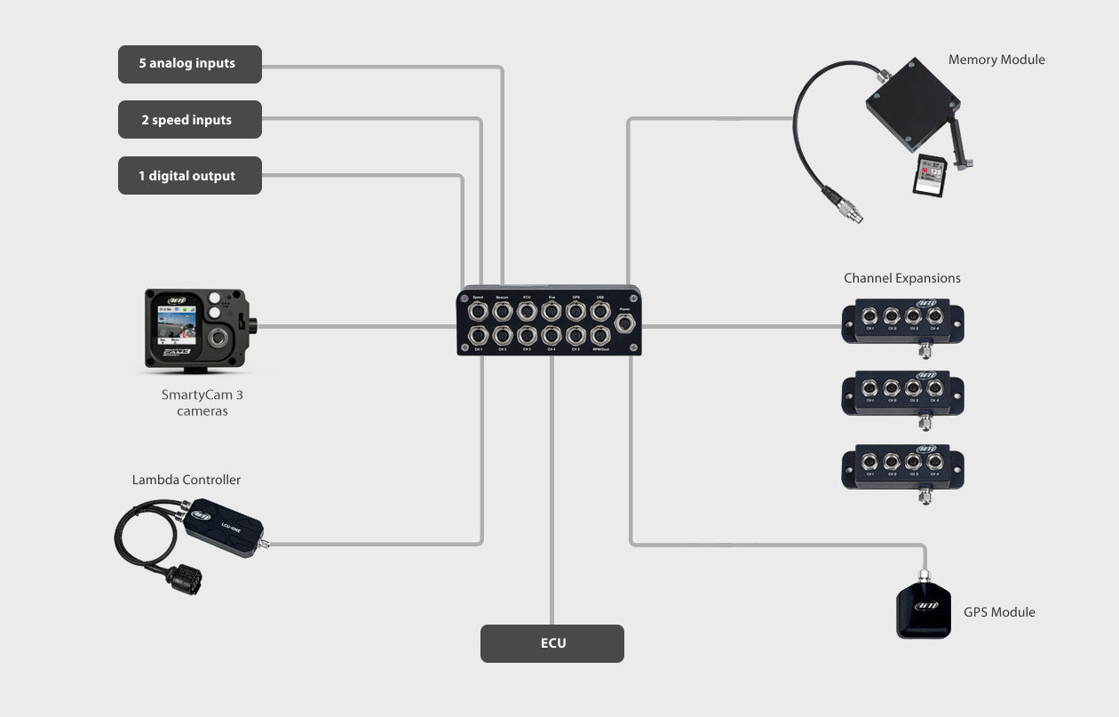

The EVO4S is a powerful and flexible data logger that offers a range of sources for your data. The tri-axial accelerometer and gyro are a built-in inertial platform that allows you to understand oversteering, understeering and banking etc, making it a great tool for track days to help improve your performance.
Why Choose the EVO4S Data Logger
The Aim EVO4S is a powerful and flexible data logger and comes equipped with an optional GPS Module. Offering one connector per channel the EVO4S samples all the information you need, data coming from your vehicle's ECU via CAN, RS232 or K-Line, from the internal accelerometers and gyro and the GPS Module.
Select which harness you require CAN, RS232 or OBDII, and select which GPS Module best meets your requirements. You can also upgrade your kit with our GS-Dash display and Formula Steering Wheel, allowing you to really improve your performance on track days.
Sensors & Inputs
5 fully configurable analogue channels allow you to sample data coming from the temperature, pressure, suspension and other sensors. 2-speed inputs also allow you to monitor different wheel behaviours. 2 CAN interfaces allow you to send messages directly to an existing CAN network to help improve the range of vehicle control possibilities.
Optional Expansions
You can add optional expansion modules via the built-in CAN bus.
- Channel Expansion: Permits to add 4 0-5 volt analogue channels for pressure, temperature sensors and potentiometers (suspension, steering angle). Two of these channels can be configured to receive digital inputs like wheel speed.
- TC Hub: Adds up to four "K" type thermocouple temperature sensors.
- LCU-One Lambda Controller: Wideband Lambda controller LCU-one, with Bosch LSC 4.9 probe provides air/Fuel data, lambda value and exhaust gas temperature.
- SmartyCam Cameras: Onboard cameras that overlay onto all your videos all the data sampled by your logger.
Connections
EVO4S
Optional GPS09 or GPS08
