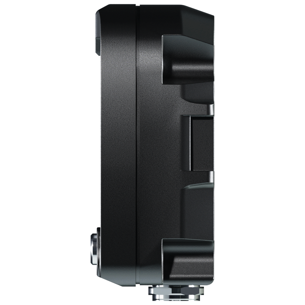

  • Solo 2 DL: A data logging lap timer that handles an ECU input with a CAN expansion port that you can connect a SmartyCam to.

The Solo 2 DL calculates, displays, and records lap times, sector times, position & vehicle speed, with a sampling rate of up to 25Hz, and 3D acceleration & gyro. This allows you to see your exact racing line, compare it to optimal lines for faster lap times, track the motorcycle's movements and provide detailed data on acceleration, braking, and cornering forces.

The Aim Solo 2 DL is a high-precision, 25Hz GPS lap timer. It connects directly to your motorcycle’s ECU to provide detailed performance data such as speed, RPM, throttle position and more. It provides accurate lap times, split times and predictive timing, with advanced data logging capabilities, making it one of the best compact data logging lap timers with an integrated display for track days.
How does the Aim Solo 2 DL motorcycle lap timer kit work?
The Aim Solo 2 DL is a data logging GPS lap timer that allows you to analyse instant speed, timing splits, live data and predictive, theoretical and delta times. It connects directly to the motorcycle's ECU and multiple satellite constellations (GPS and GLONASS), providing performance data in real time. The ACC3 connects to the Solo 2 DL, converting the analogue sensors included in the kit into a CAN signal.
The Aim Solo 2 DL uses a range of different technologies to enhance user experience. It has a 25Hz GPS receiver for precise lap timings and position markers, a 100Hz 6-axis inertial platform that provides data on roll, pitch and yaw. It also has integrated data logging capabilities via CAN bus, for advanced and comprehensive data logging.
