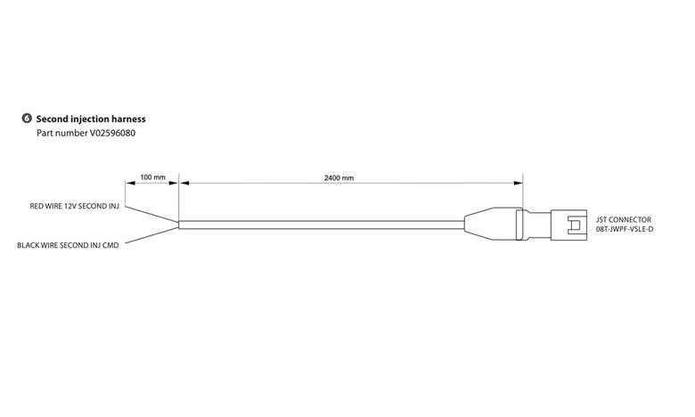

The Aim Taipan Second Injection Harness is an optional cable that pairs with the Taipan ECU to add another injection to a motocross bike. It is connected to the third connector on the Taipan ECU, has two other flying wires and measures 2.5m in total.

  • JST connector 08T-JWPF-VSLE-D
  • Full Length: 2.5m
Flying Wires
  • 2 flying/free wires
  • Red Wire - 12V Second INJ
  • Black Wire - Second INJ CMD
