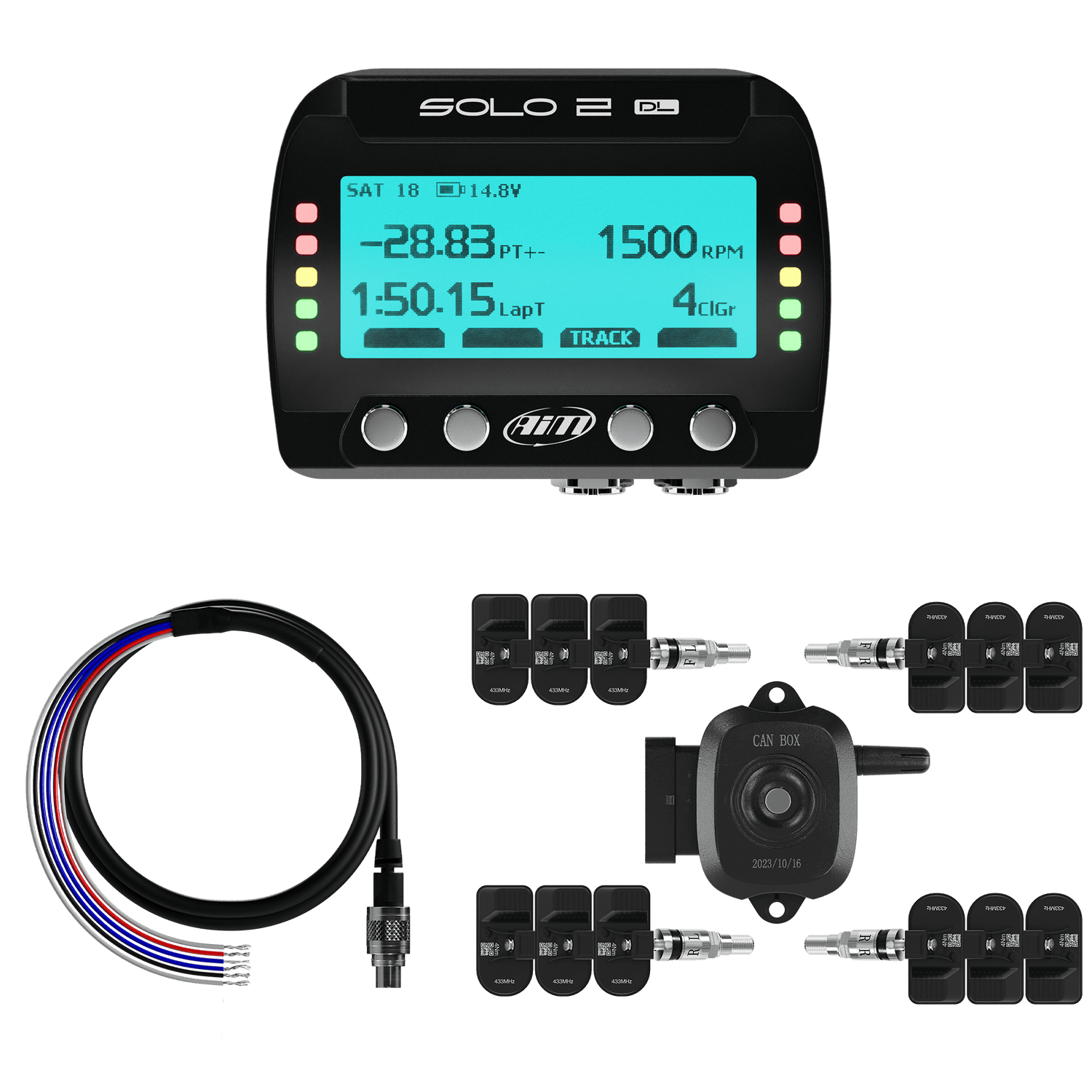

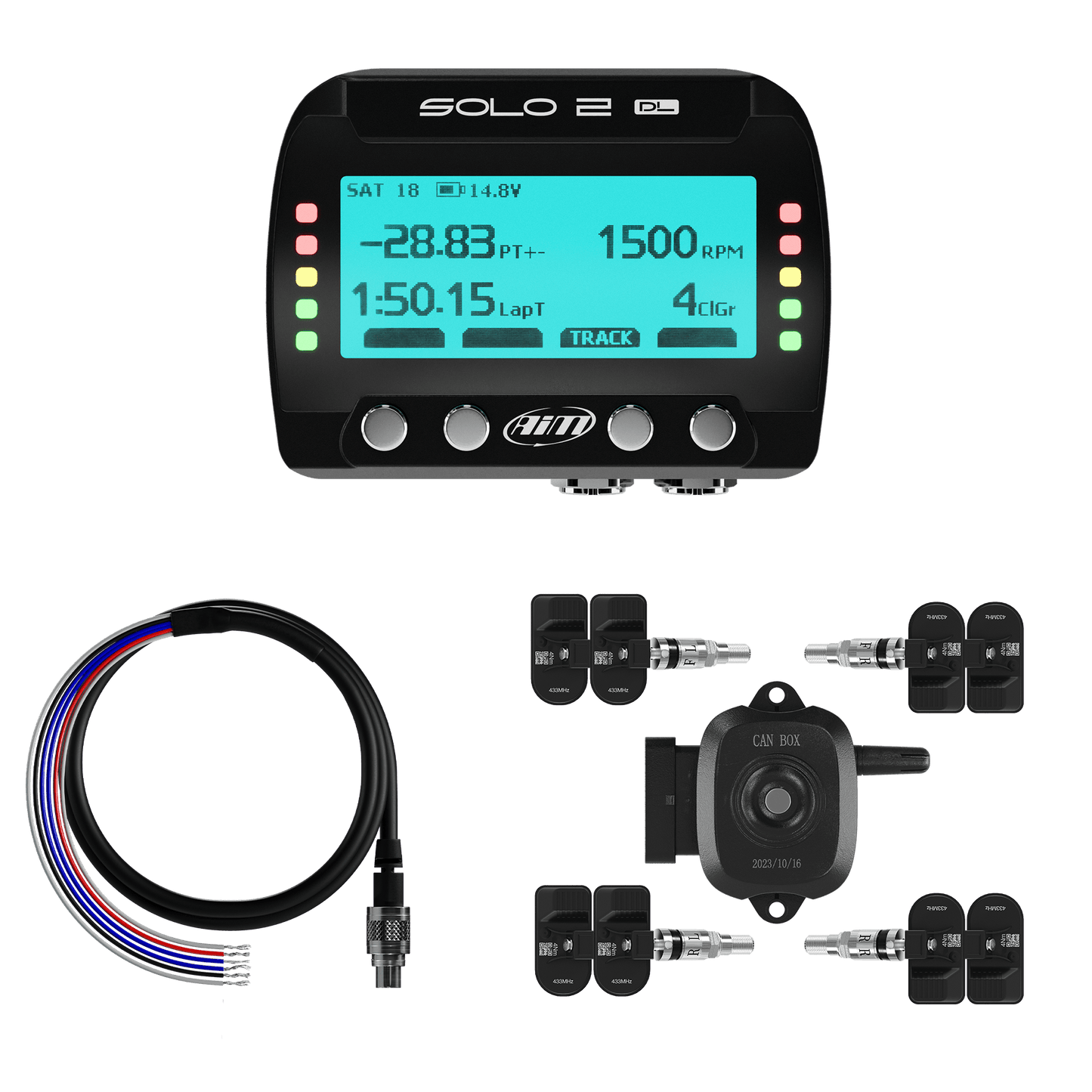

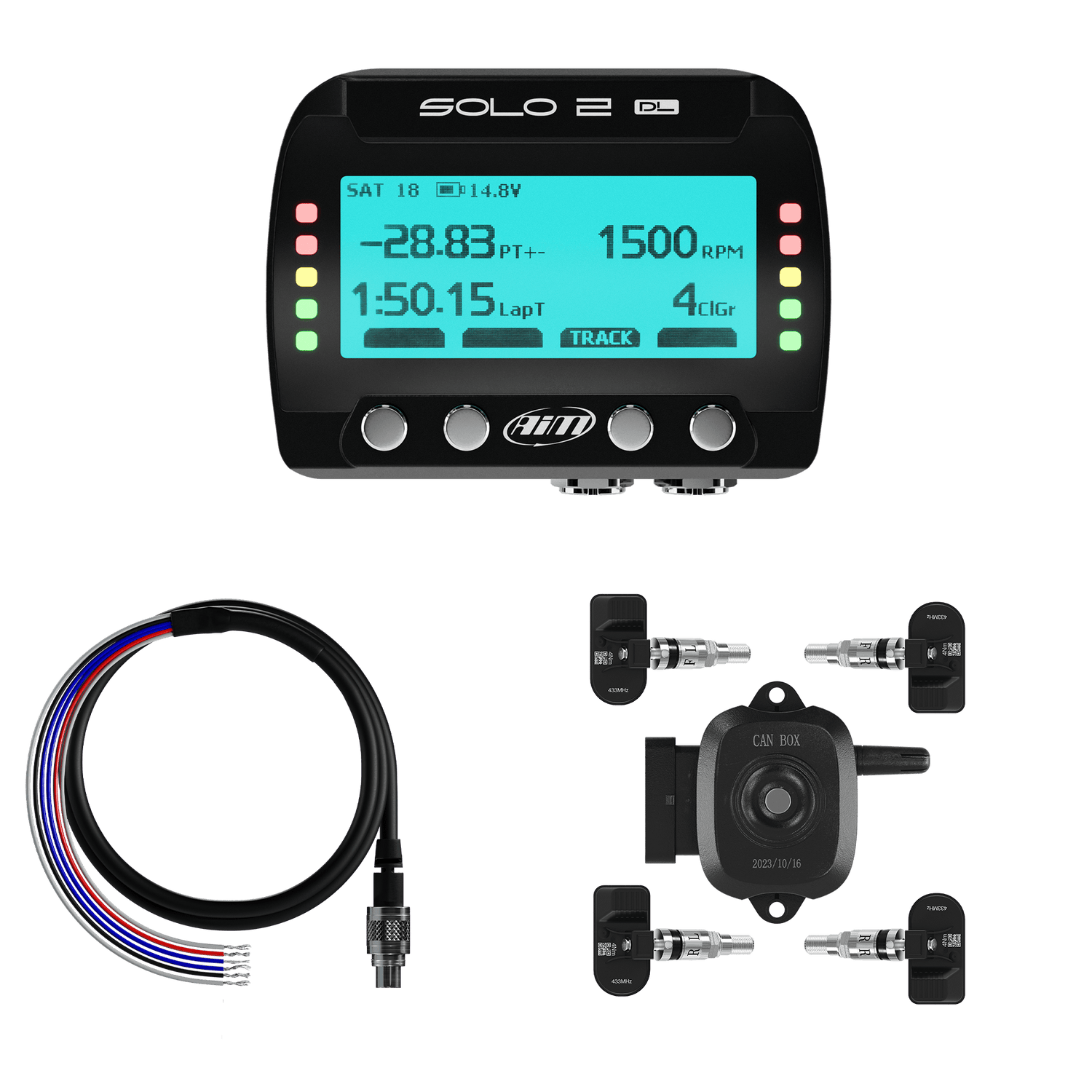

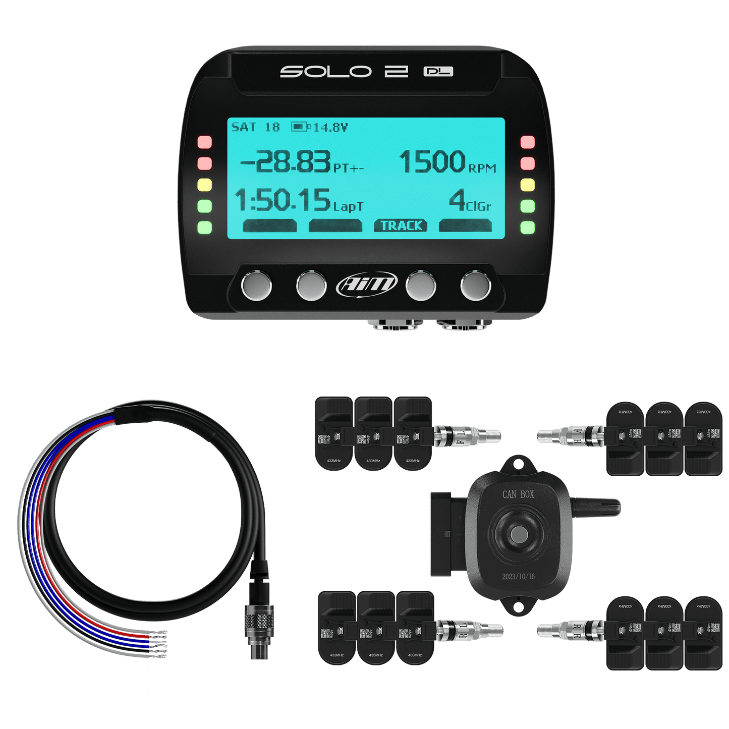

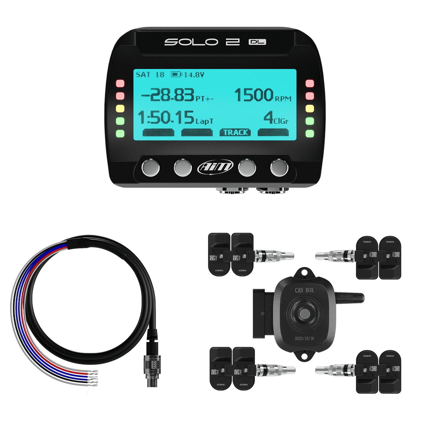

The Aim Tyre Pressure Monitoring System comes with a wiring harness, 4, 8, 12, 16, 20, or 24 sensors, and a CAN Receiver, which is compatible with race car applications and competitions.
The CAN Receiver utilises 1Mbit CAN (11bit), which has become the standard over the years for most professional ECUs, data loggers and dashboards within the motorsport and automotive sectors. The receiver is pre-coded with 4 sensors, and each sensor is labelled FR, FL, RR, and RL for each of the wheels of the car. All you need to do is connect your sensors to the correct tyre and all the data will be recorded on the receiver. You can overlay all of this data straight to your dash logger. Extra wheels can be clone-coded and used as sets of spares for pit changes, just clone a sensor manually using the Handheld Programming Unit.
