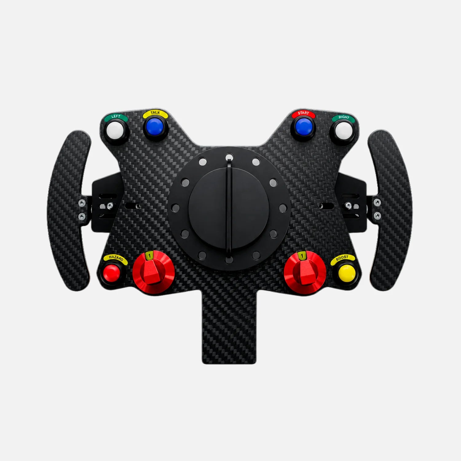

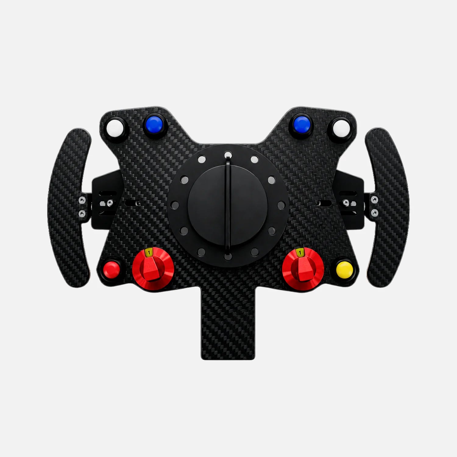

    Carbon 8 Button Wireless Steering Wheel Plate with Paddle Shifters
    Race faster, harder and safer with push button controls at your fingertips, combining minimum driver distraction with maximum ease of use.
    Please Note: The steering wheel: not included. Stickers: sold separately.
    4 & 8 Channel Stickers  10 Chanel Stickers
    CAN wireless system CR2 lithium battery
    6 digital push buttons Two 12 position analogue inputs

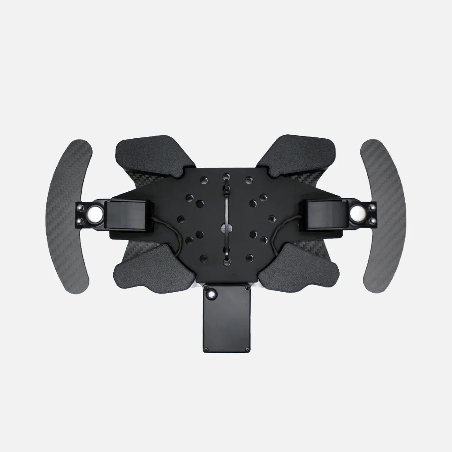

    Bolt between the wheel & boss 3-year guarantee
    2 Paddle Shifters

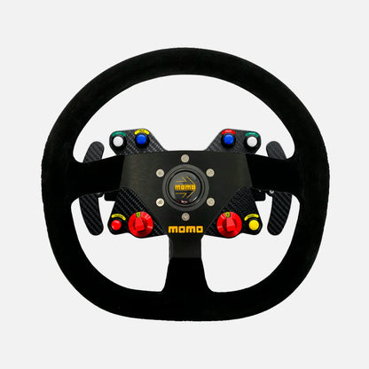

    The carbon ten channel wireless system allows you to have push button controls at your fingertips whether you have a detachable steering wheel or would like to avoid the need for an unreliable coiled wire connection from your steering wheel to the dashboard.
    Upgrade your wheel plate with adhesive stickers. Pre-cut and hard-wearing, and professionally printed. They are easy to apply and add a professional finish to your wheel plate. See accessories tab.
    6 Digital push buttons, 2 Paddle Shifters & 2 analogue inputs
    Wirelessly implemented, the in-vehicle commands in a fraction of the time with six instant steering button controls and two 12 position analogue inputs can be set as traction control settings or for engine mapping giving you a wide range of adjustability at your fingertips.
    The steering wheel plate is lightweight and integrates with most CAN devices, including dashboards, ECUs, PDUs and data loggers, and has been tested to withstand the harshest EMI generated within your car.
    Battery Life

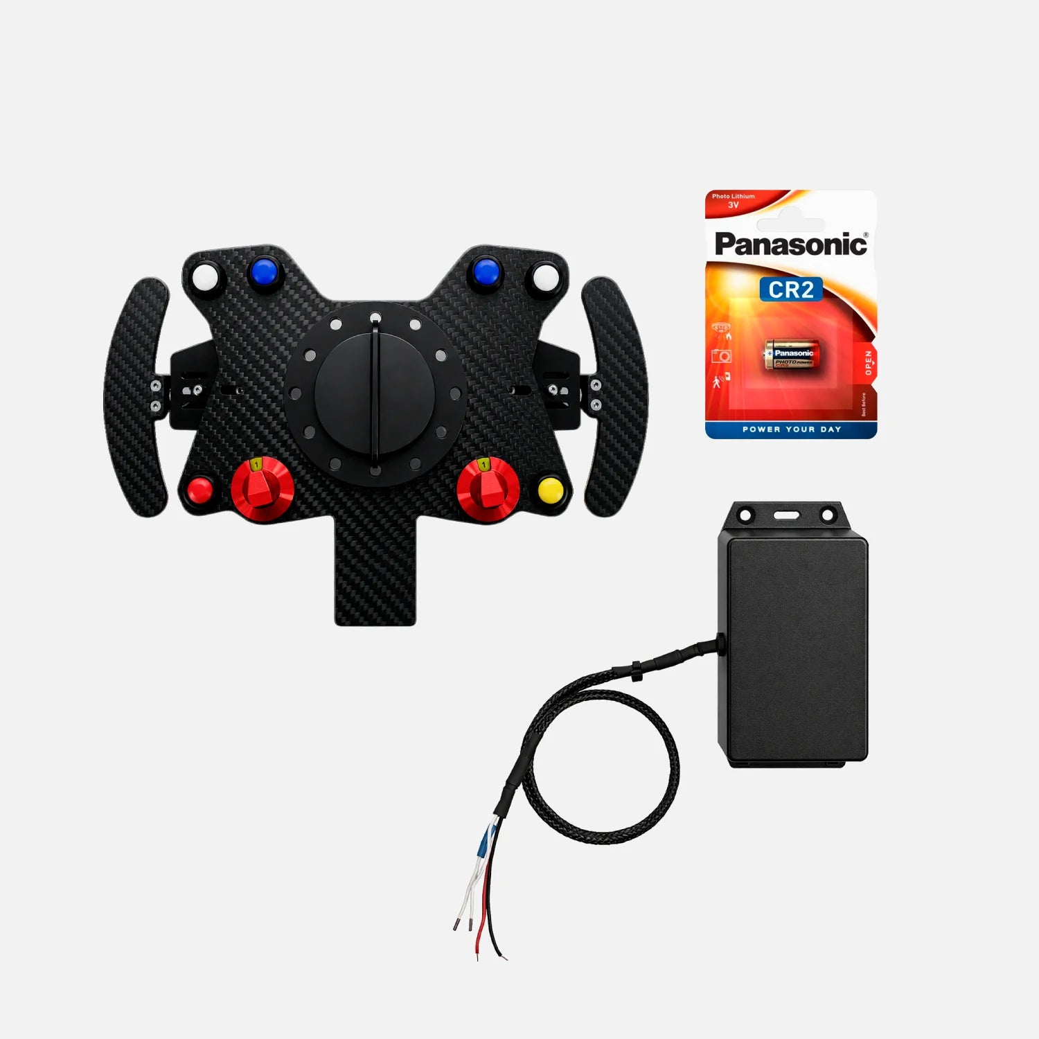

    The 10 channel wireless wheel plate has a standard CR2 lithium battery with a guaranteed life of 3 years or 50,000 miles. You don't have to worry about the battery going flat.
    The battery voltage is regularly transmitted to the CAN receiver with the intelligent system and then forwarded to the Aim device that gives you around 30 days notice when the battery needs to be replaced.
    Using our PDM systems and Race Studio 3 software will allow you to completely control the behaviour of the momentary push buttons to act as simple latching switches or more complex management.
    With Race Studio 3, you can also analyse all data recorded and download it to your PC: graphs, histograms and tables will help you study your performance, providing objective support to avoid mistakes and improve performances.
    • 10 channel wireless wheel plate
    • Connection harness
    • CR2 lithium battery
    • Aim sticker
