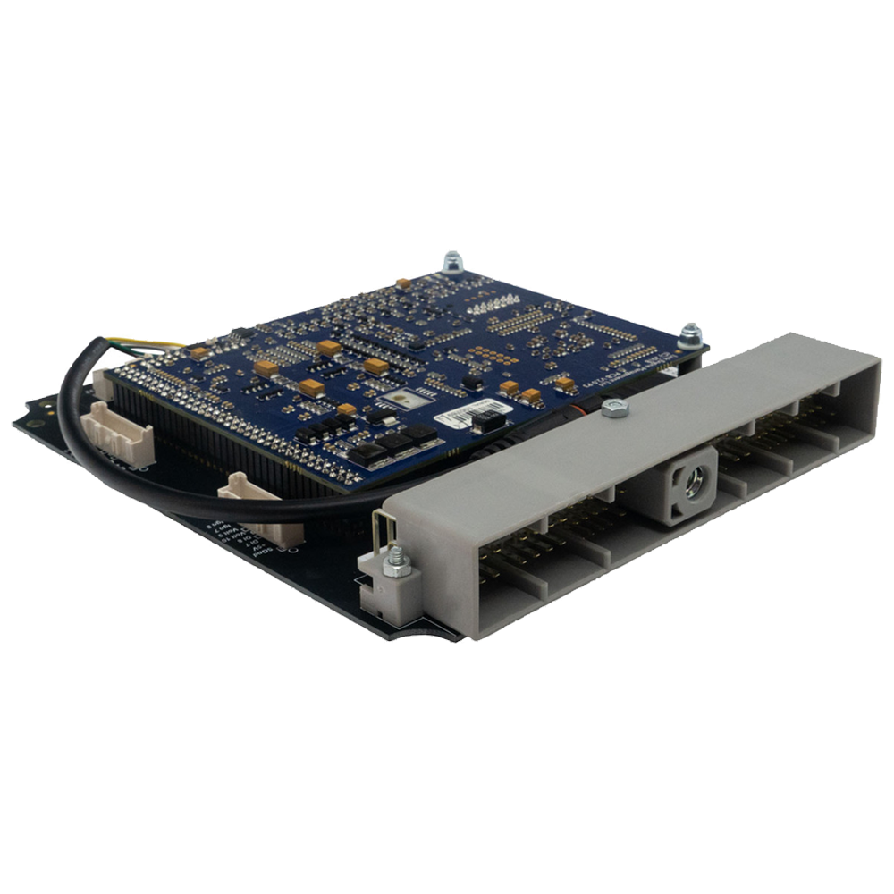

    Link Nissan GTTLink - NGTTX ECU PlugIn ECU
    The NGTTX is Designed to suit the grey plug RB (typically neo) engine.
    Note, this ECU does not currently output the 4wd signal required for proper 4wd operation in 4wd Stages and skylines.
    Suitable Applications:
    RB20DE NEO, RB25DE NEO and RB25DET NEO in R34 Skylines
    RB20DE NEO, RB25DE NEO and RB25DET NEO in C35 Laurels
    RB20DE NEO, RB25DE NEO and RB25DET NEO in Nissan Stageas
    - Plus, non-neo motors in Stages
    Sequential fuel delivery
    OEM idle hardware supported
    CAN port
    USB tuning cable included
    Staged injection
    Knock with "windowing"
    I/O Expansion Options:
    Expansion connector 1
    Gnd Sensor Ground Only
    DI 7 Digital Input
    DI 8 Digital Input
    An Volt 10 Analog 0-5V input
    An Volt 9 Analog 0-5V input
    Expansion connector 2
    SGnd Sensor Ground Only
    DI 5 Digital Input
    DI 6 Digital Input
    An Volt 5 Analog 0-5V input
    An Volt 6 Analog 0-5V input
    An Temp 2 Temperature sensor input
    Pin 108 – OBD1 wire now used for IAT on Temp 4.
