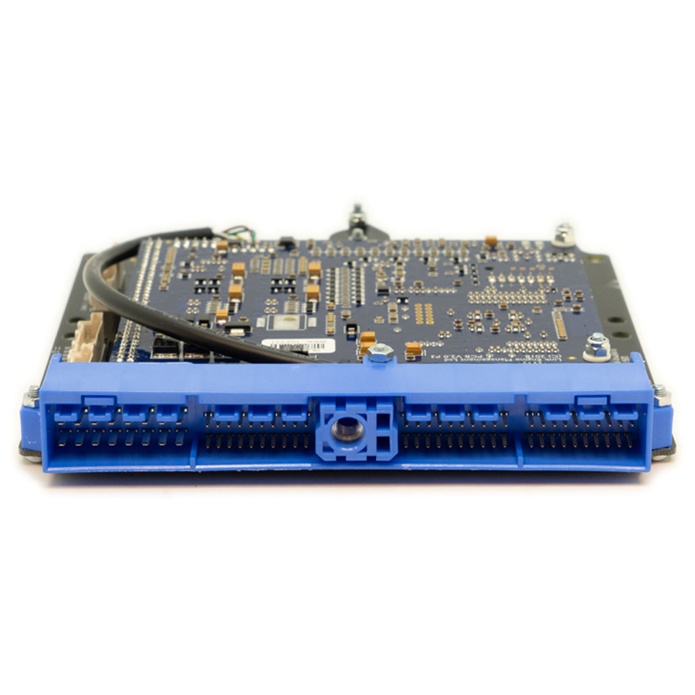

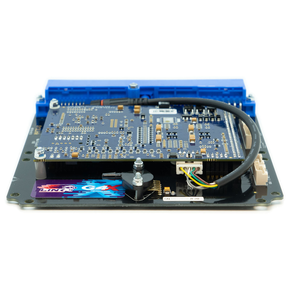

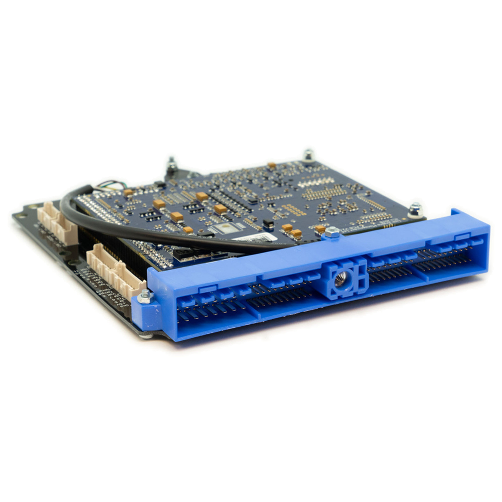

    Designed for the SR20 and CA18 engines, that use the 76 pin Blue ECU Header.
    It includes an onboard 4 bar or 7 bar MAP sensor.
    Suitable Applications:
    Nissan S13 CA18DET
    Nissan 180SX CA18DET
    Nissan S14 (pre-facelift) SR20DET
    PlugIn Key Features:
    Sequential fuel delivery
    OEM idle hardware supported
    CAN port
    USB tuning cable included
    Staged injection
    Knock with "windowing"
    I/O Expansion Options:
    Expansion connector 1
    Gnd Sensor Ground Only
    DI 5 Digital Input
    DI 6 Digital Input
    DI 7 Digital Input
    An Volt 6 Analog 0-5V input
    Expansion connector 2
    Ign 5 Ignition 5 Auxiliary Output
    Volt 8 Analog 0-5V input
    Volt 9 Analog 0-5V input
    Volt 10 Analog 0-5V input
    Volt 11 Analog 0-5V input
