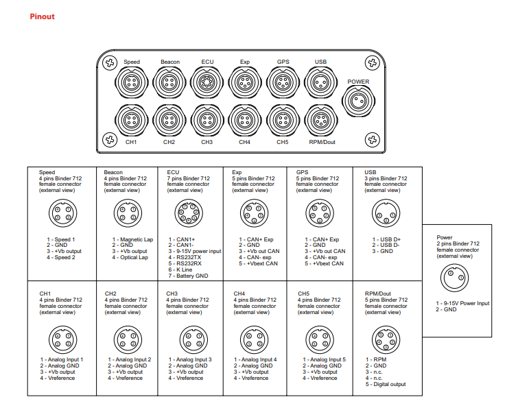

Connections
EVO4S
Optional GPS09 or GPS08
