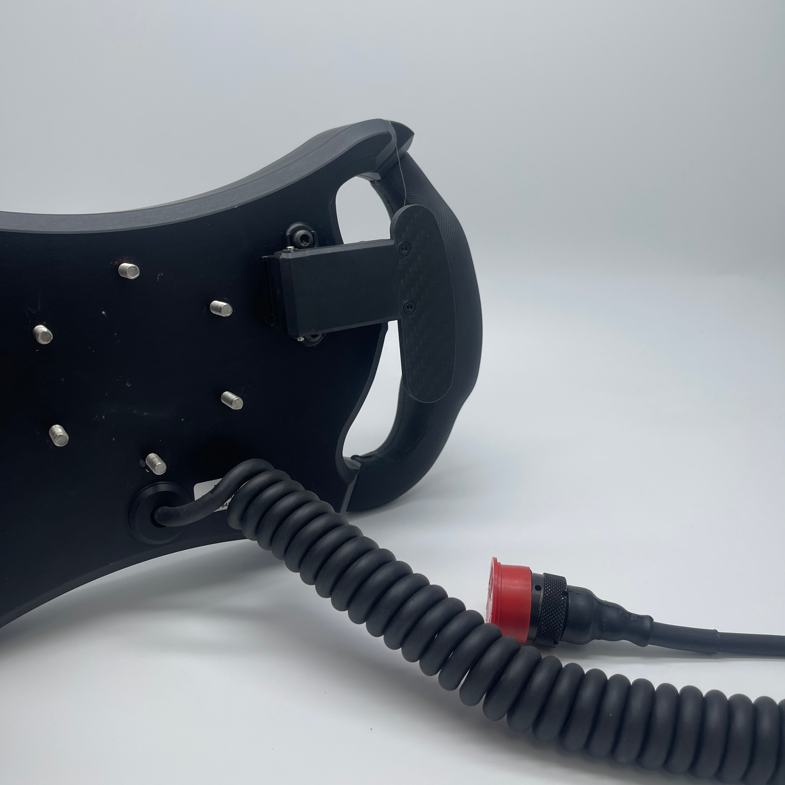

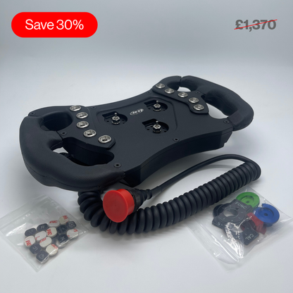

GT32 Electronic Steering Wheel
The GT32 Electronic Steering Wheel transmits the status of 8 push buttons and 3 rotary switches through a fully configurable CAN connection, plus 2 additional push buttons via free contact connections. It also supports 2 optional carbon fibre paddle shifters with a precise magnetic system for reliable, high-quality gear shifting.
Why Choose the GT32 Steering Wheel
The GT32 Steering Wheel delivers professional-grade control with fully programmable buttons, rotary switches, and RGB LEDs, giving you the flexibility to tailor every detail to your needs. It’s built for precision, reliability, and total confidence behind the wheel.

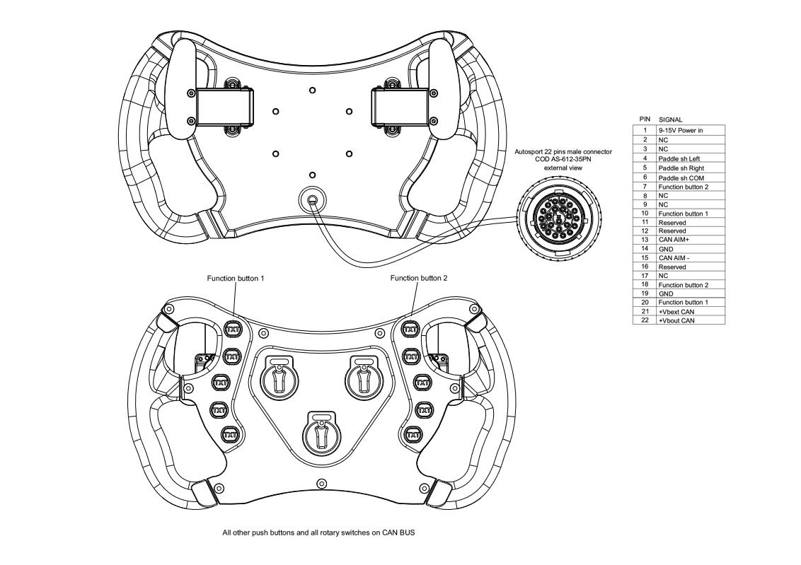

- 2 additional push buttons available via free contact connections

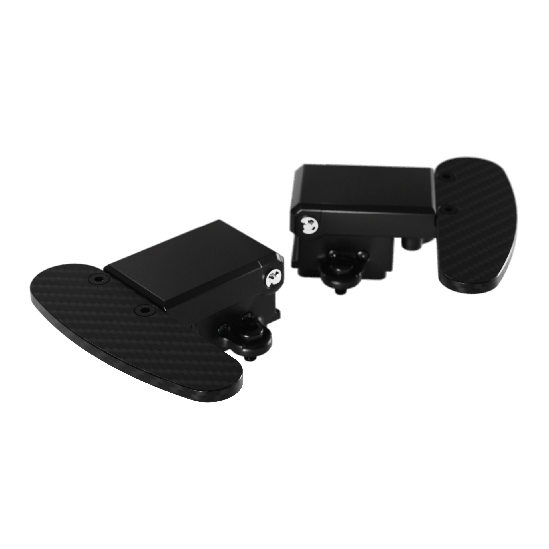

- Optional magnetic carbon fibre paddle shifters

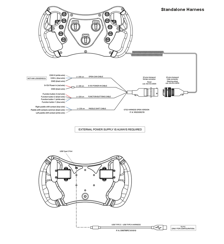

Standalone: GT32 is available in a completely standalone version that connects via CAN to any ECU.

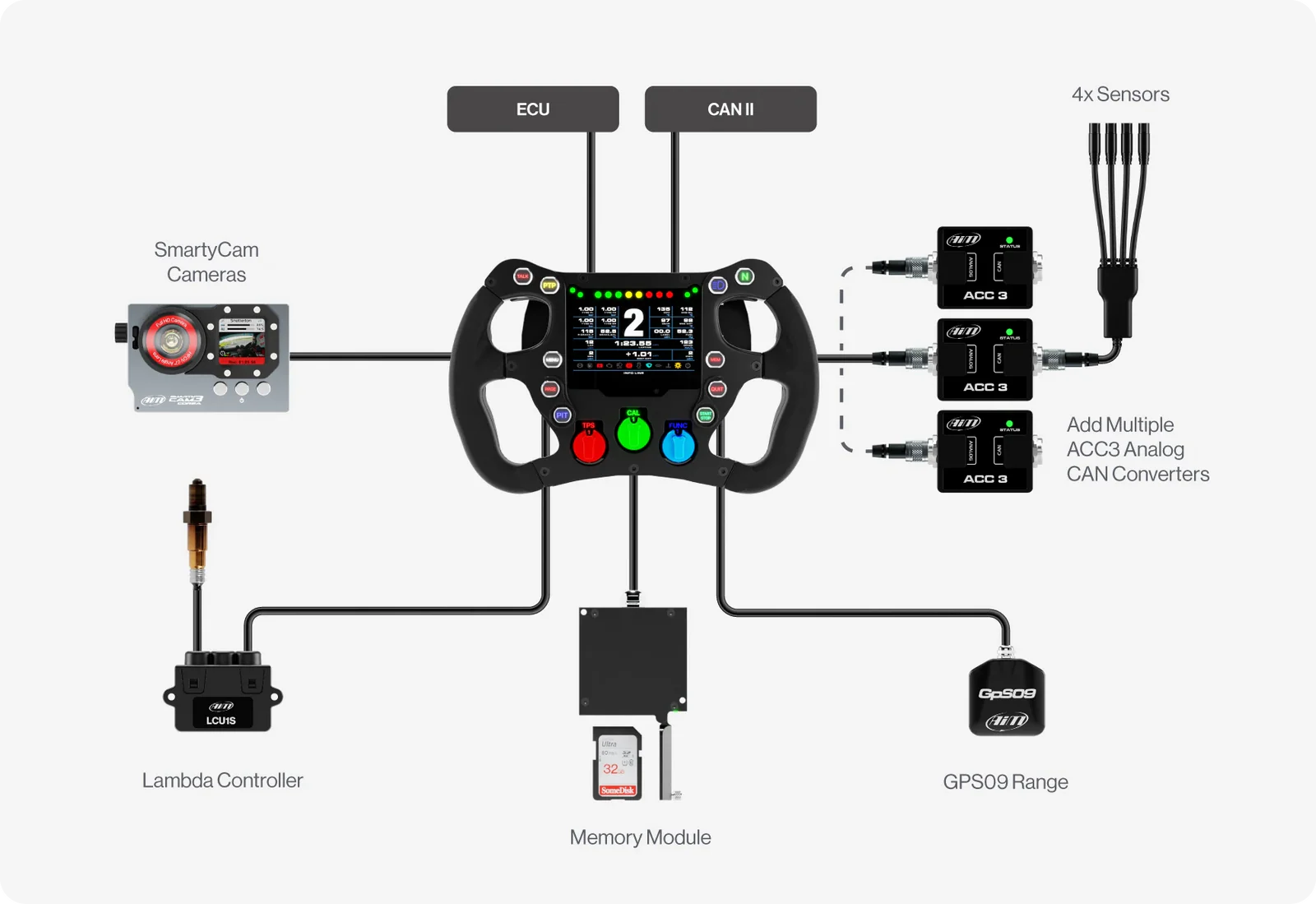

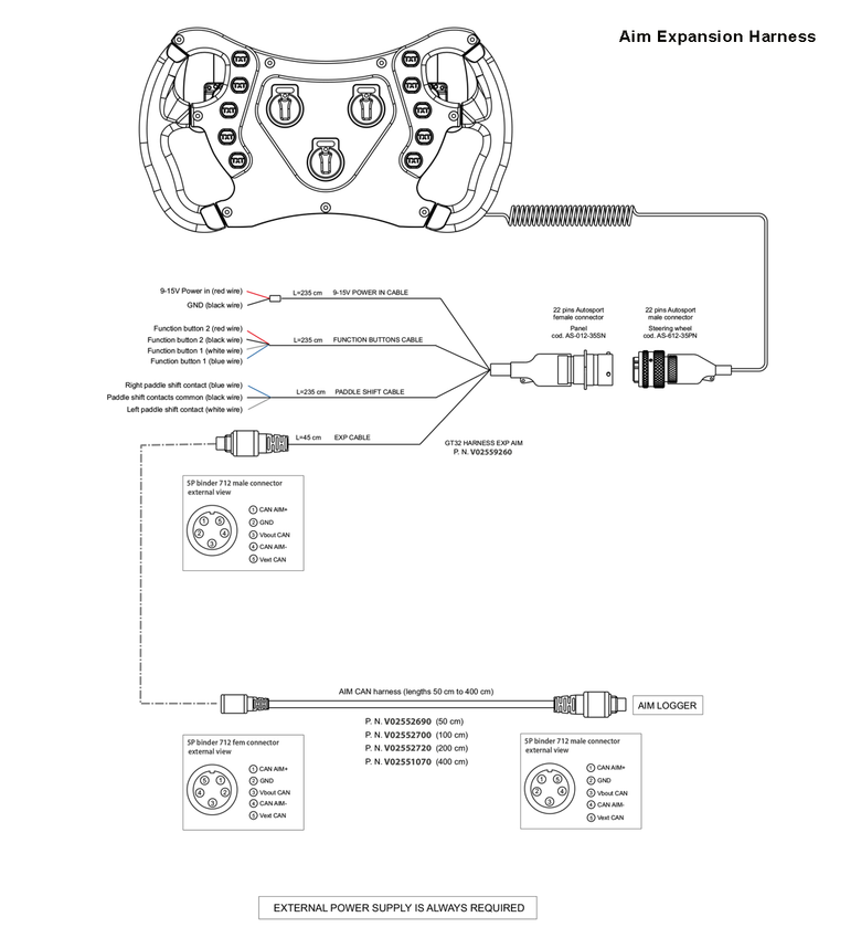

Expansion: GT32 CAN Open Steering Wheel is available as an expansion for the PDM32/08 Power Distribution Module, providing seamless integration into a complete Aim electronics system.

CAN Output
The CAN output function allows full customisation of how data from the steering wheel is transmitted. Settings include:
- Number of bytes allocated
- Data length code
- Byte order
- Frequency from 1Hz to 100Hz
CAN Messages Configuration
The GT32 Steering Wheel transmits button and switch statuses, either at fixed frequencies or whenever a change occurs. CAN message parameters such as frequency, IDs, baud rate, endianness, and content can all be freely configured. Button states at power OFF can be restored at the next power ON.
In standalone mode, the GT32 Steering Wheel can also manage a CAN input protocol, providing LED feedback (such as colour changes) based on received information.

- Additional Controls: In expansion mode, the GT32 can also manage an Aim display connected to a PDM32 or PDM08 Power Distribution Module.

- Precise & Solid Shifting: The new optional magnetic carbon fibre paddle shifters deliver high accuracy and tactile feedback, providing confidence during both upshifts and downshifts. Shifters can be configured through dedicated free contact pins or CAN message communication.
Harness Options
Steering Wheel
Choice of 2x Paddle Shifts, EXP Harness or Both
