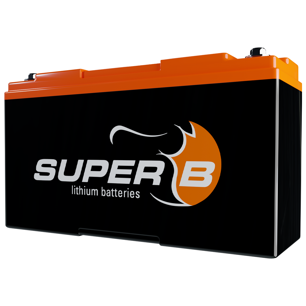

    The Super B Andrena 12V20Ah-SC Lithium Battery is a slightly larger and heavier version of the Andrena 12V20Ah, providing the same battery performance and power in a slightly larger form
    superb lithium batteries
    What Is The Super B Andrena 12V20Ah-SC Lithium Battery?
    The Super B Andrena 12V20Ah-SC Lithium Battery is a high-performance lithium iron phosphate (LiFePO4) battery that has been specially developed for motorsports. It’s a reliable and lightweight alternative to traditional lead-acid batteries.
